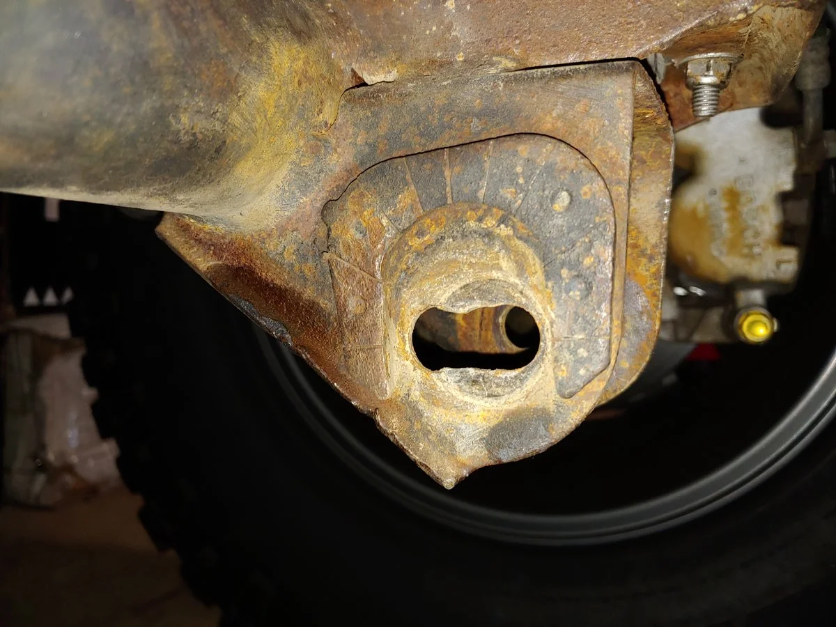

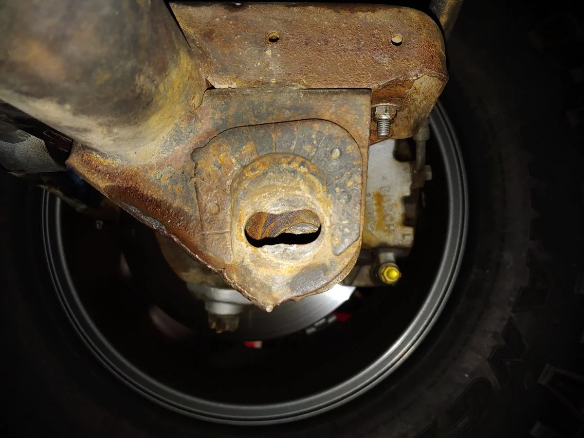

@mrblaine think this might have something to do with the JJ issues?
Reactions: JMT
I’m going to go out on a limb and say that damage isn’t new, and isn’t because of JJs.
Not saying its new and caused by the JJs, rather it's a possible cause of the JJ issues, perhaps from a slight misalignment of the joint in the bracket.
Sarcasm is lost in text, I’m aware that’s your problem. Is the Wallowing new since the change or were these present before your upgrade?
Alas, it is lost. Not new. Was like that when I pulled old arms, cam bolts and washers off.
I had some steering slop after installing a new trackbar - rereading the installation instructions suggested I should check the torque specs again. I’m not sure how often after the “break in period”, but I wonder if this is a similar case (probably exacerbated by the elongated bolt holes).

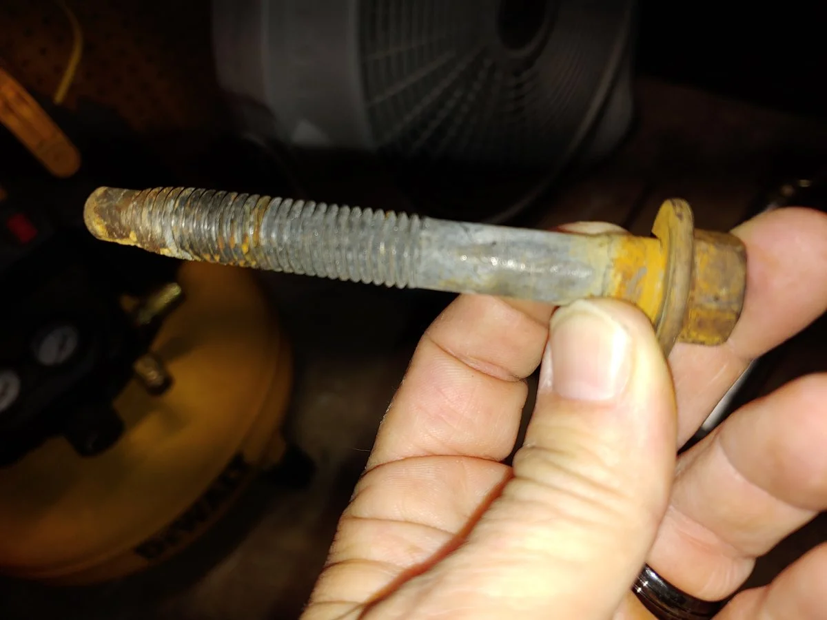

I'm not sure it's wallowing out. The new JJ bolts are too large to move back and forth in the slot. They only fit in the front or rear of the slot. You can see where the new washer for the larger JJ bolt was against it in the rear of the slot. A flat bolt went through the middle when I removed the previous arms. It almost looks like the slot was drilled with larger holes rather than a smaller slot wallowed out. I checked torque regularly on them.
Previous control arm bolt with flattened side that fit in that narrow middle part of the slot. It os triangularly shaped like a thread-cutting bolt.
