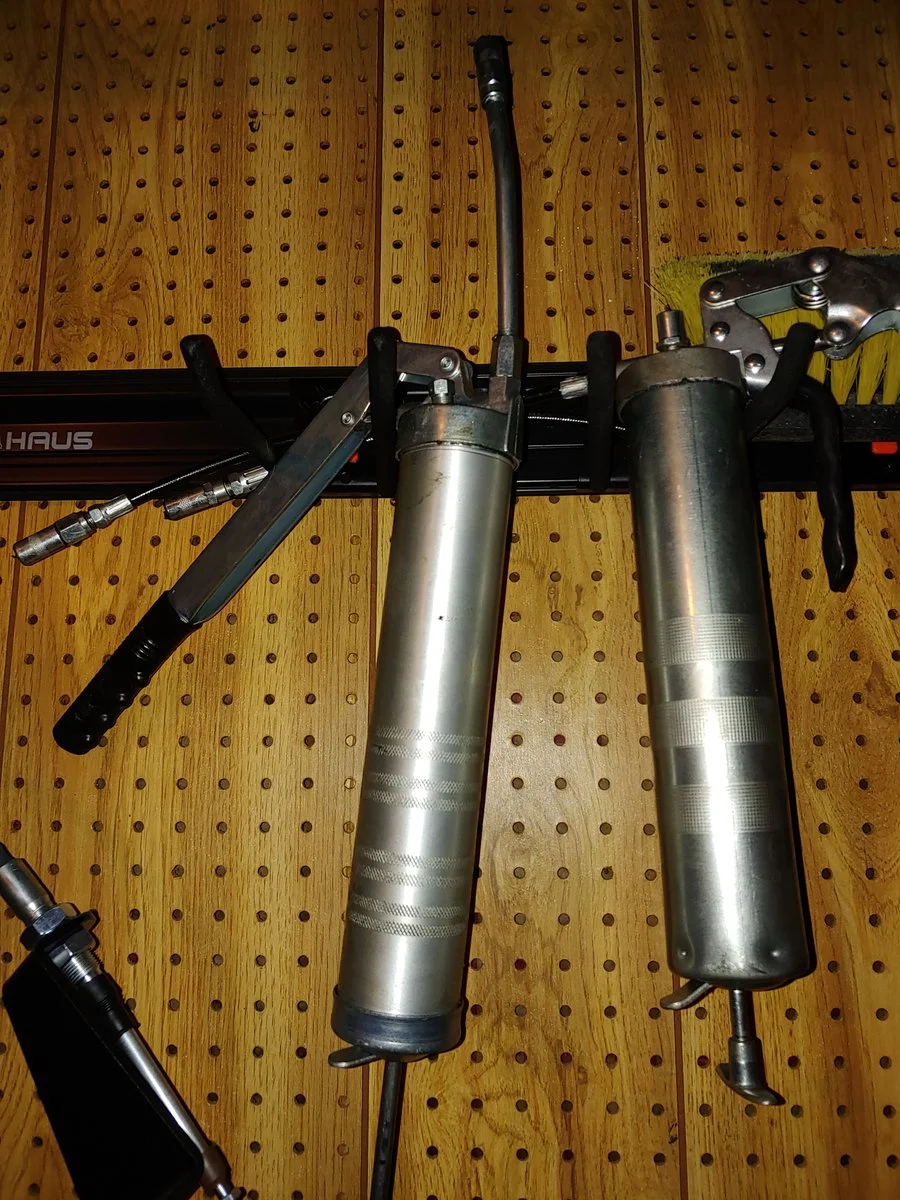

what Are you using for a grease gun, if it’s a pistol grip style you probably can’t make enough pressure to force grease in, the long lever high pressure style is the one to get.
Have and tried both.

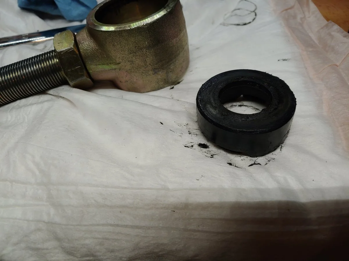

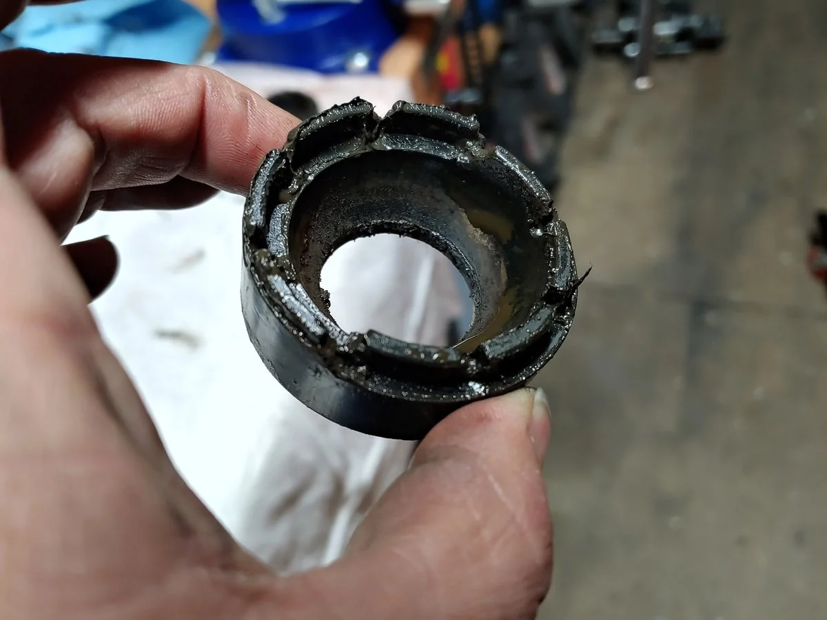

All it does is extrude the race out through the hole in the end washer. Not even close to blown up and nothing that taking them apart, cleaning them out and reassembling them correctly won't fix. At the worst you need a 10 dollar race kit to fix them.
I have some races that are torn/blown out and I can only assume it is from trying to force grease in them. I have since learned it is best to just take them apart to clean and grease them if they start making noise.

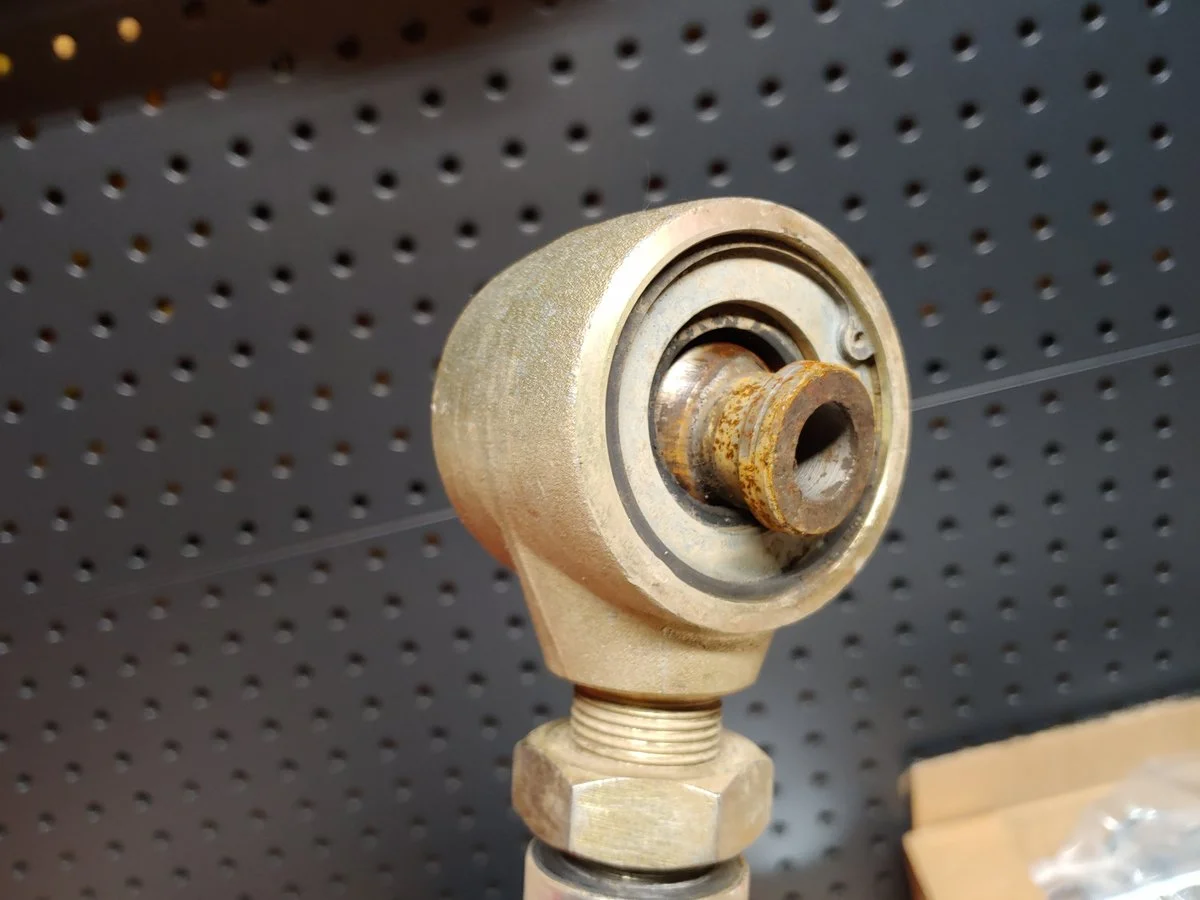

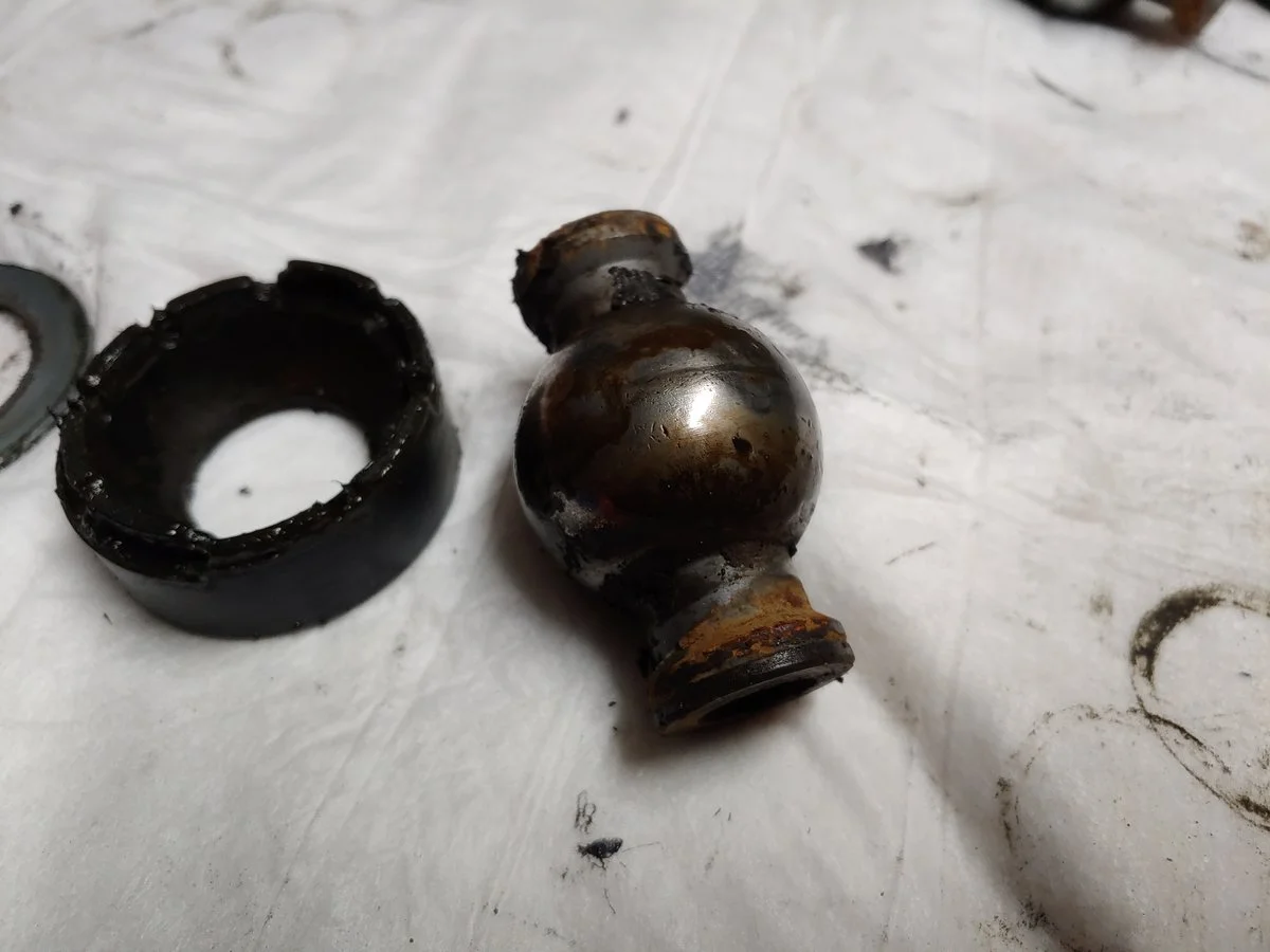

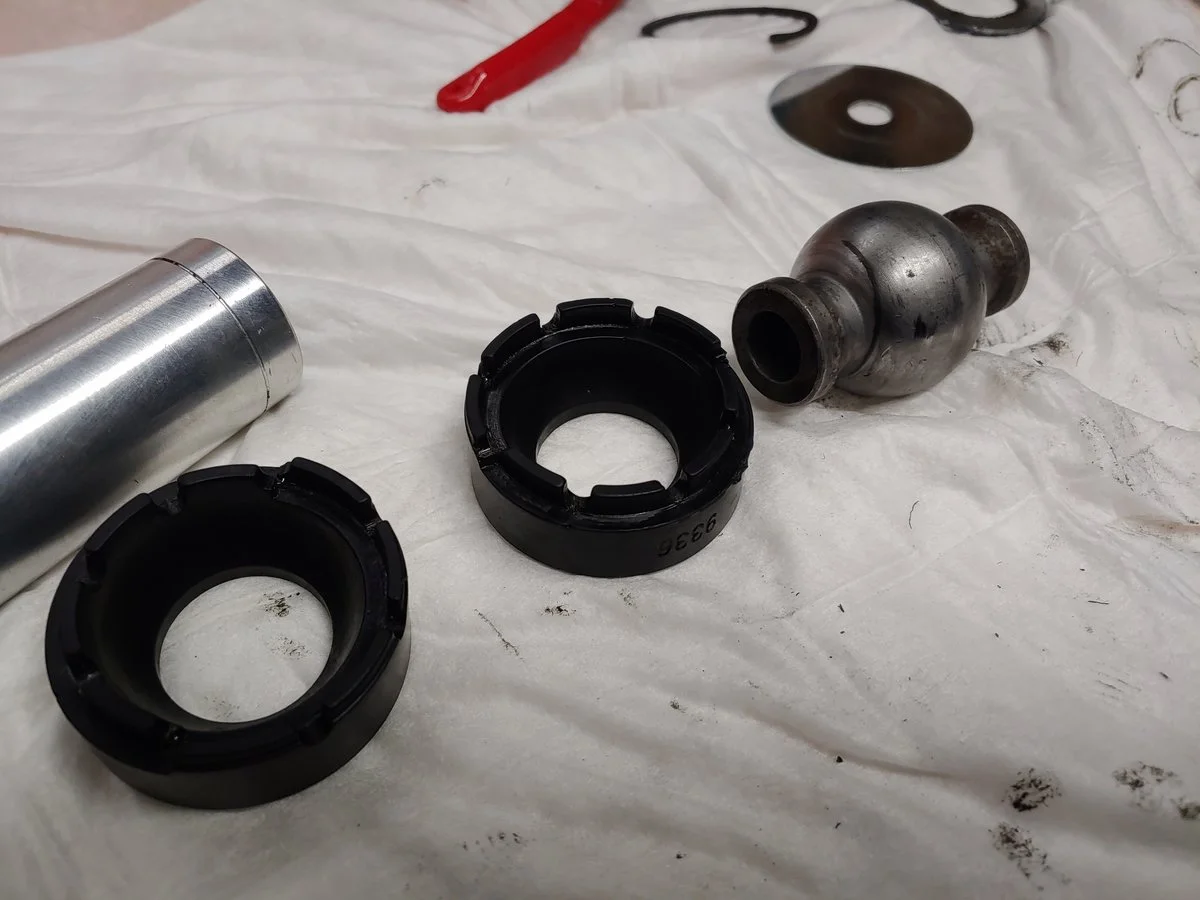

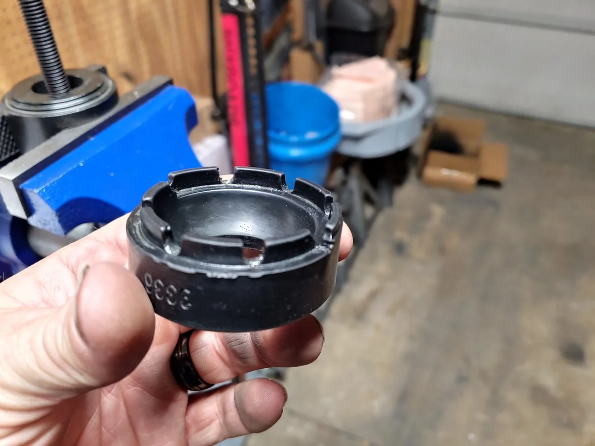

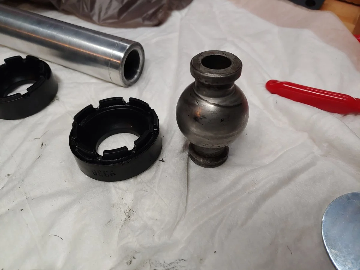

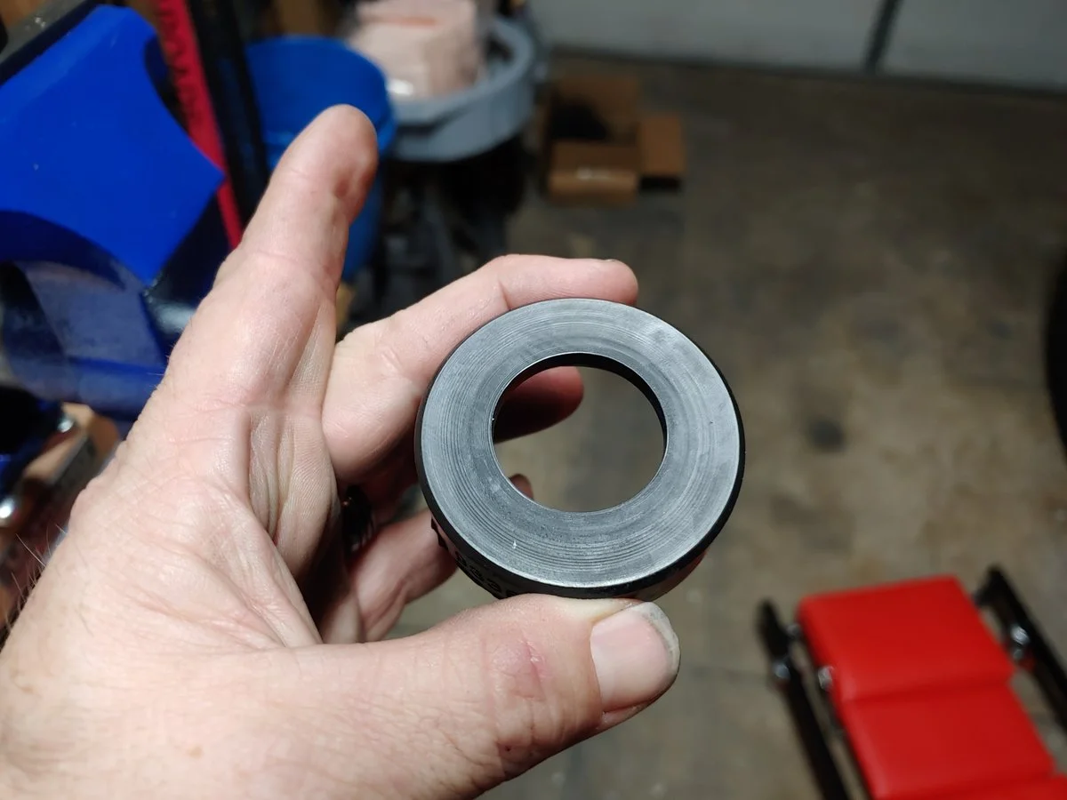

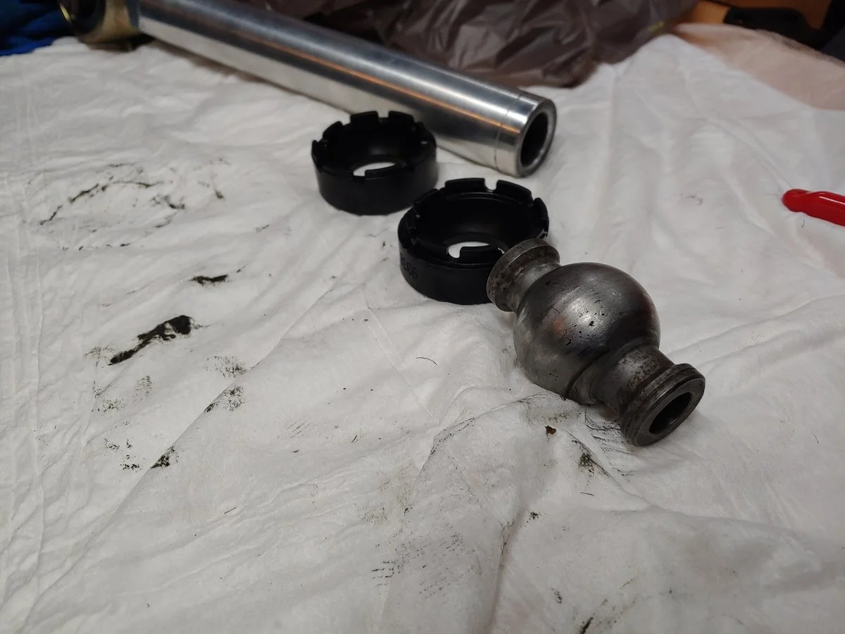

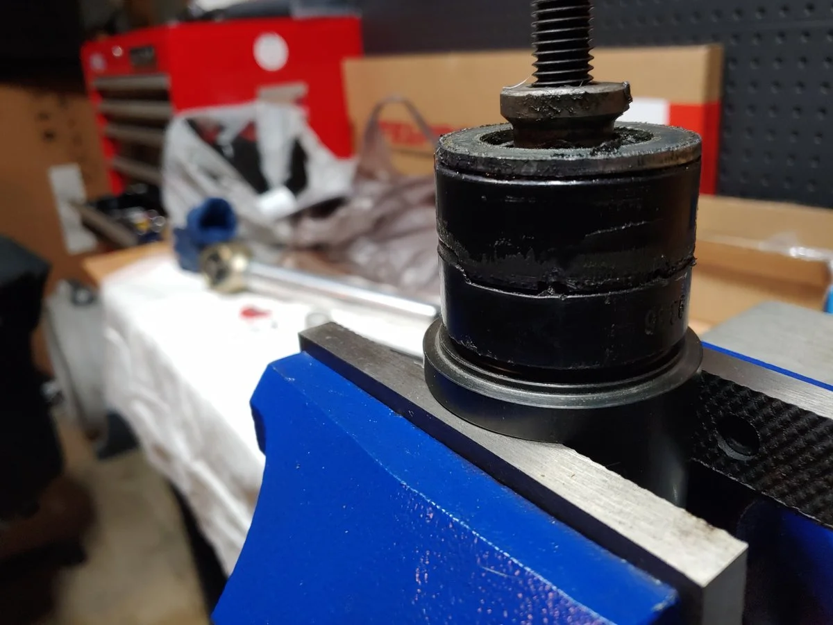

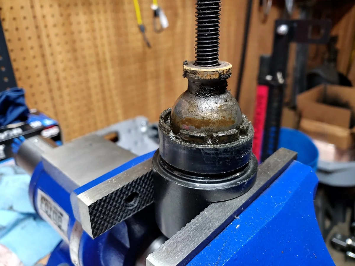

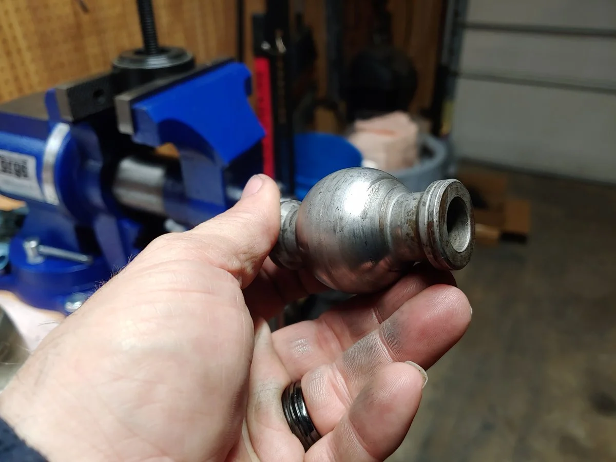

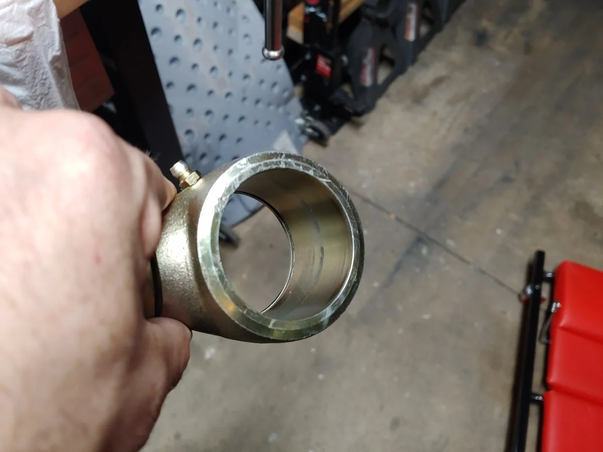

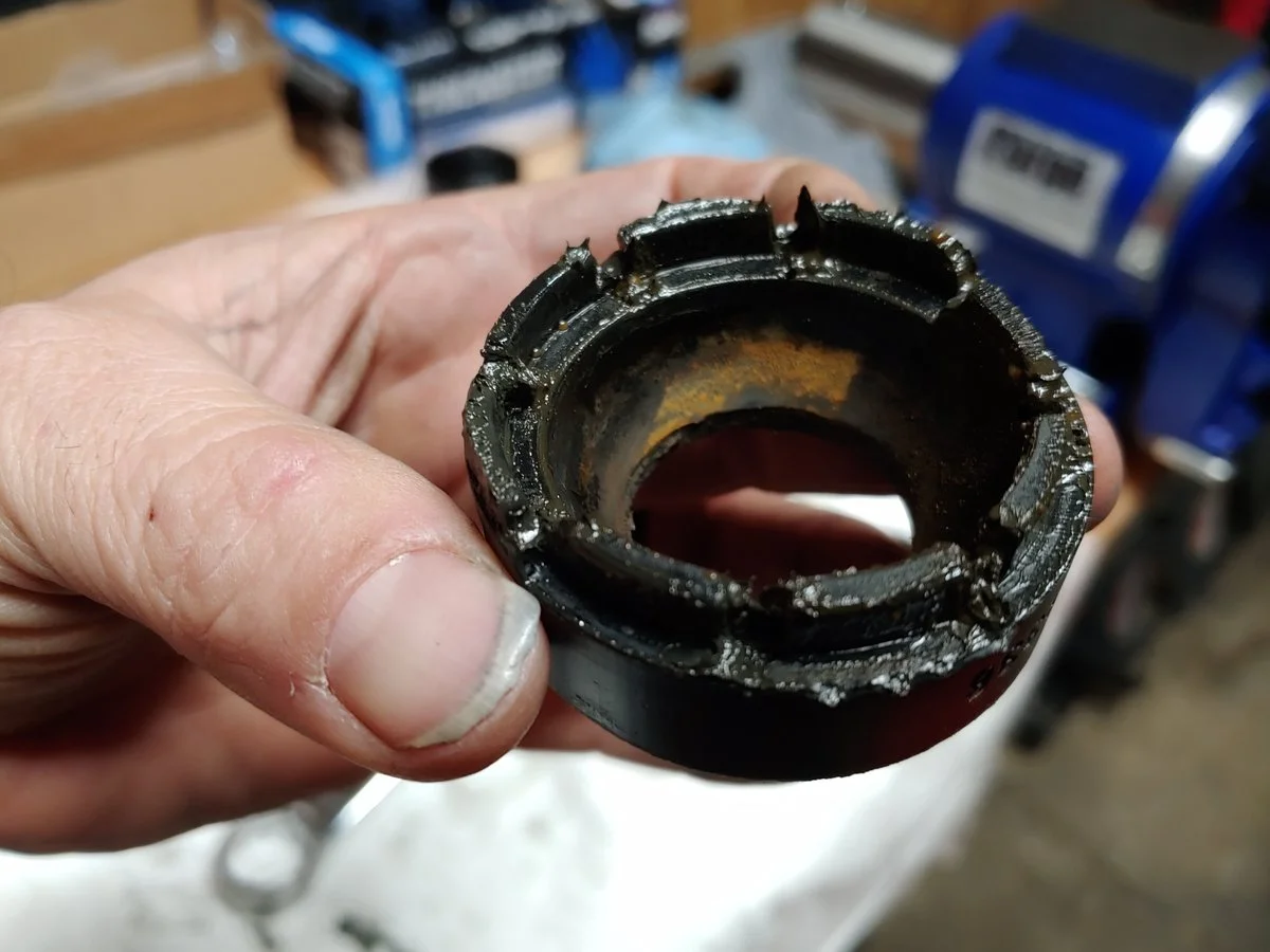

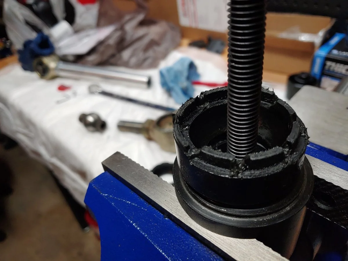

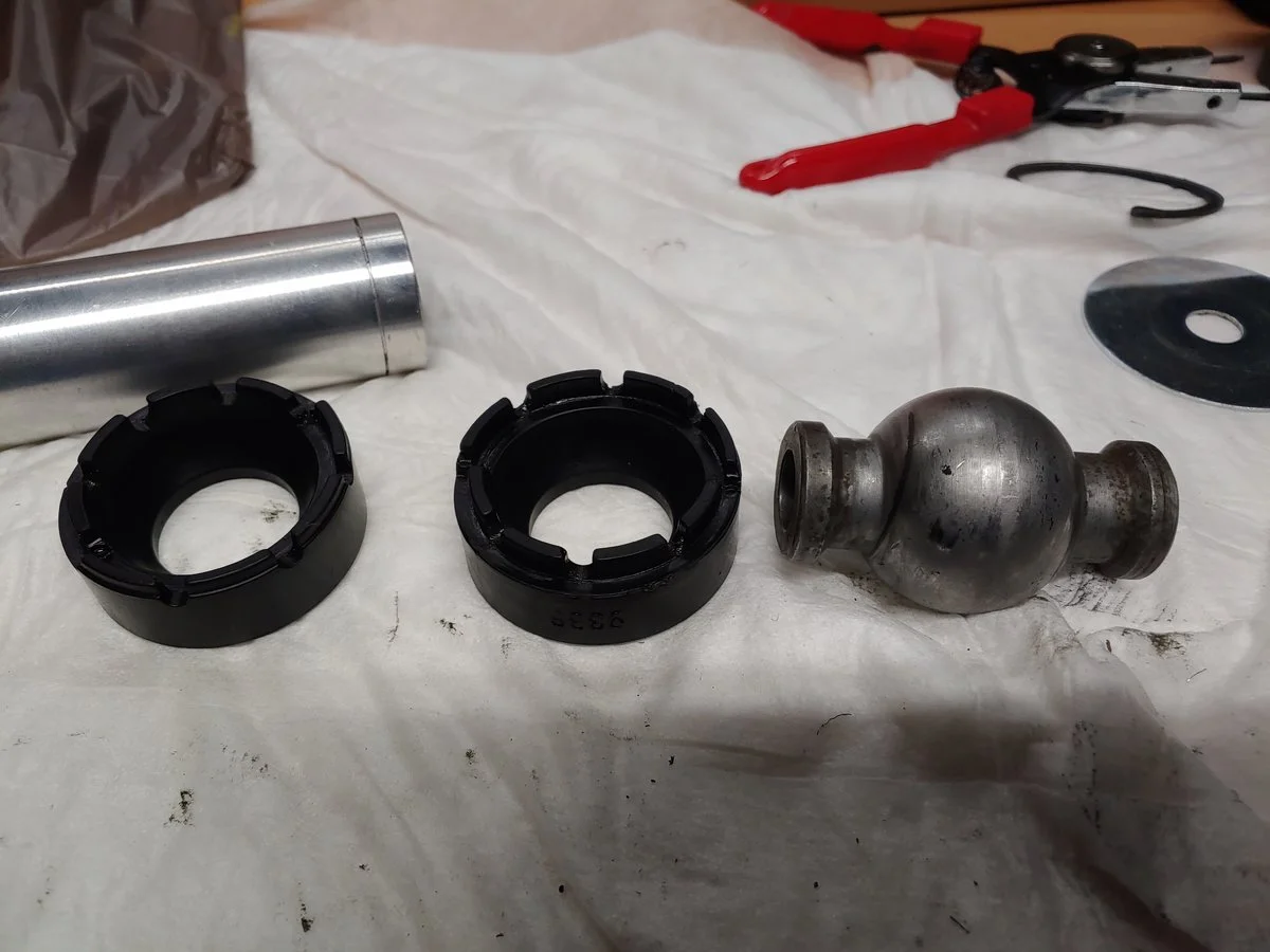

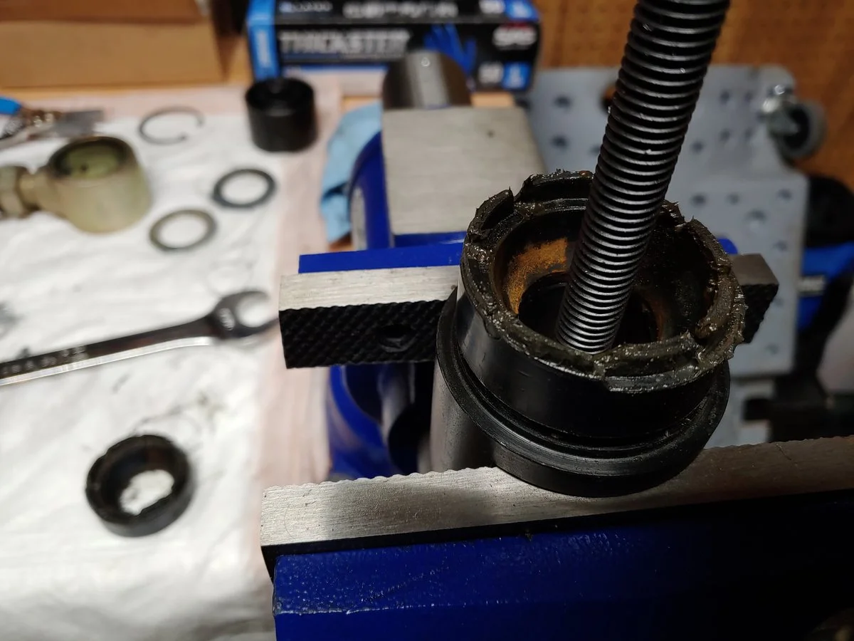

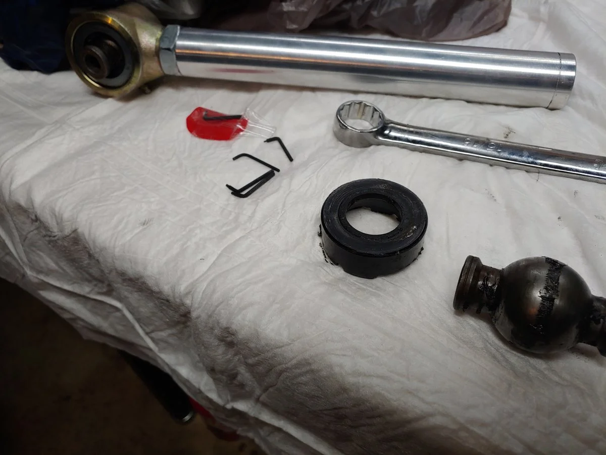

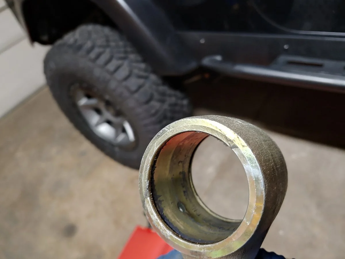

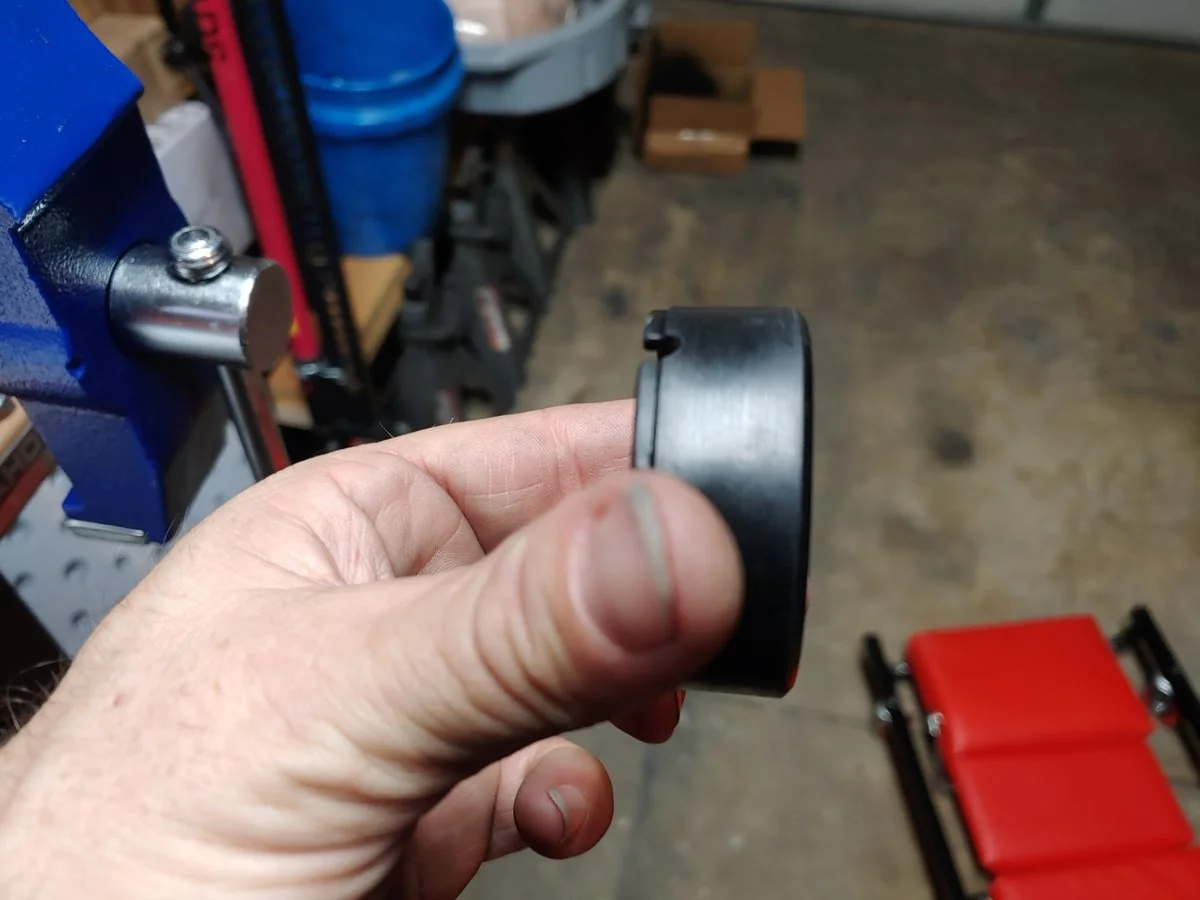

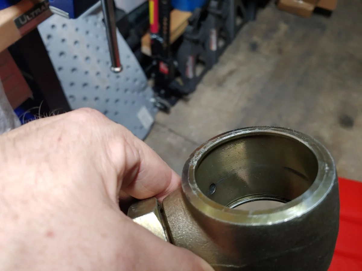

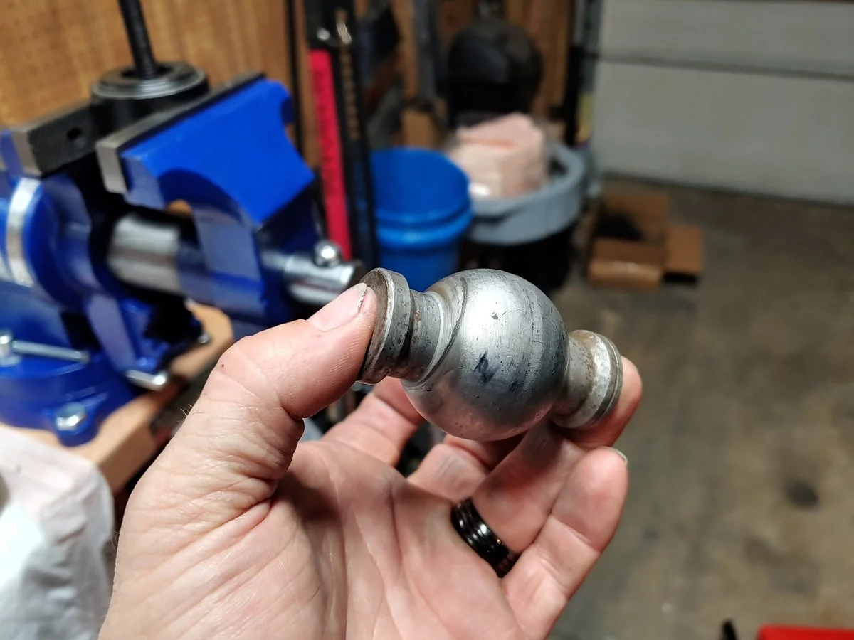

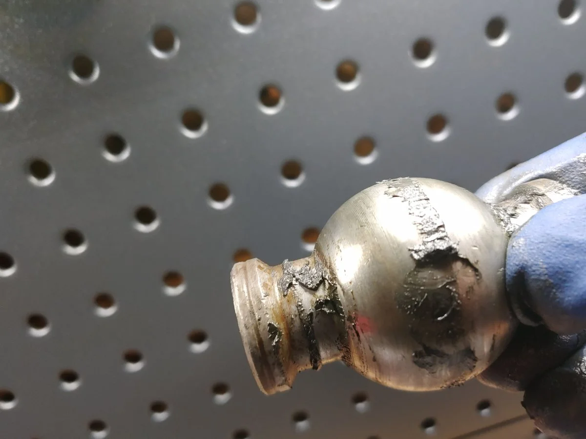

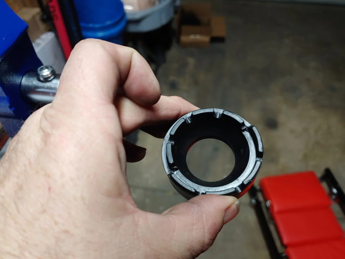

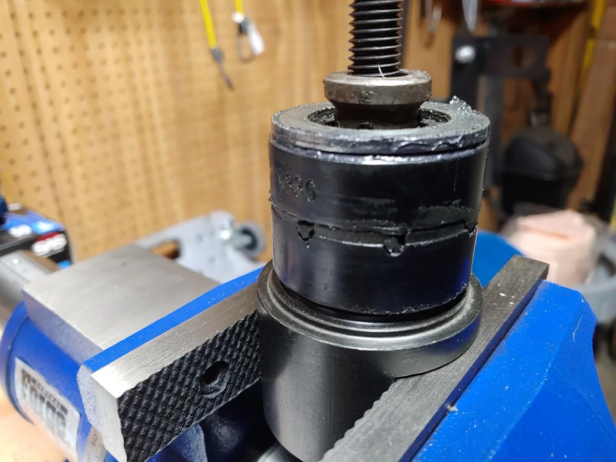

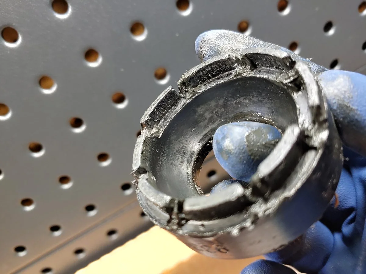

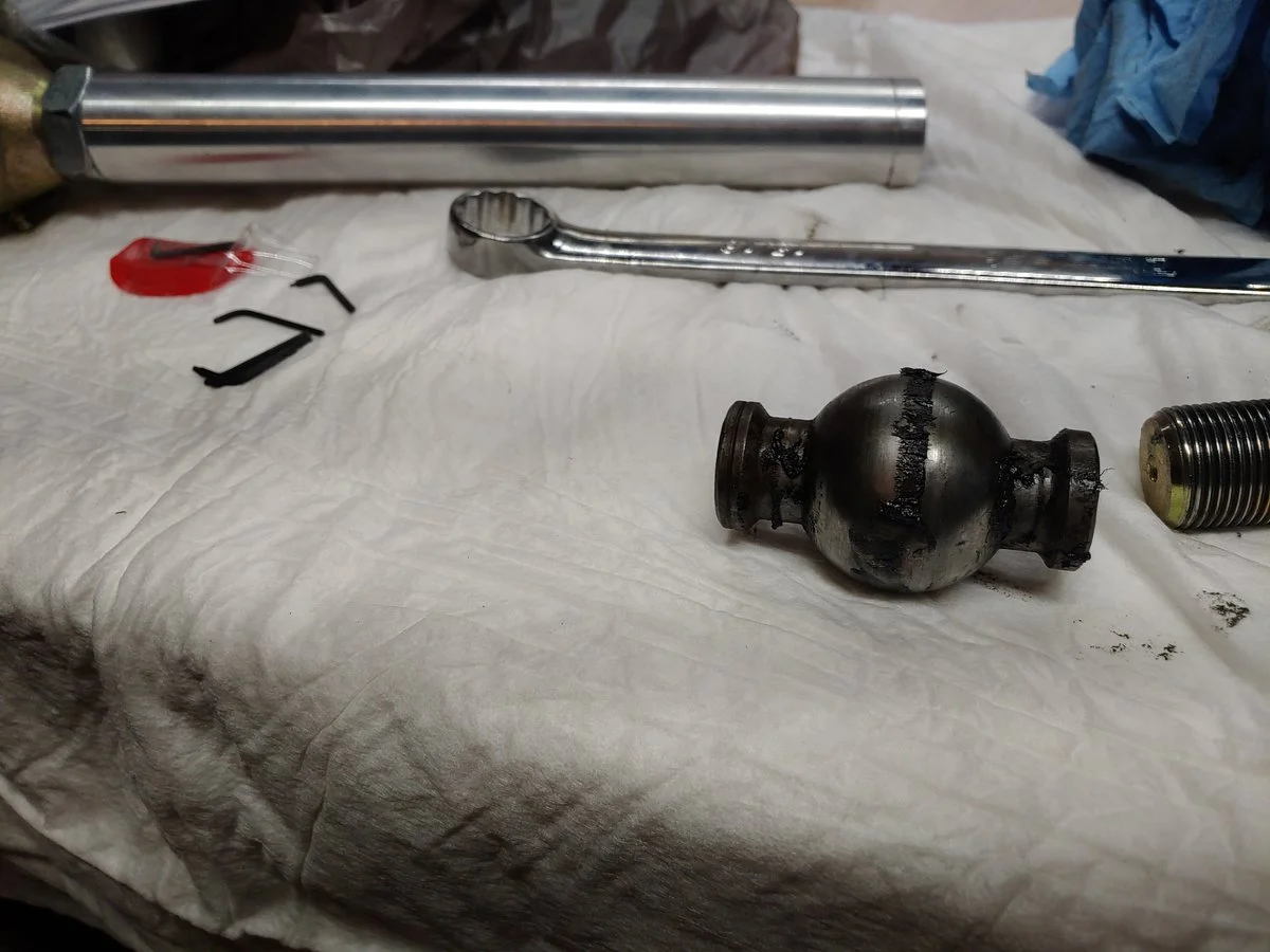

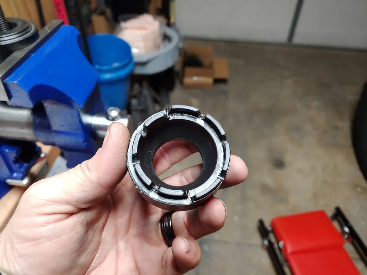

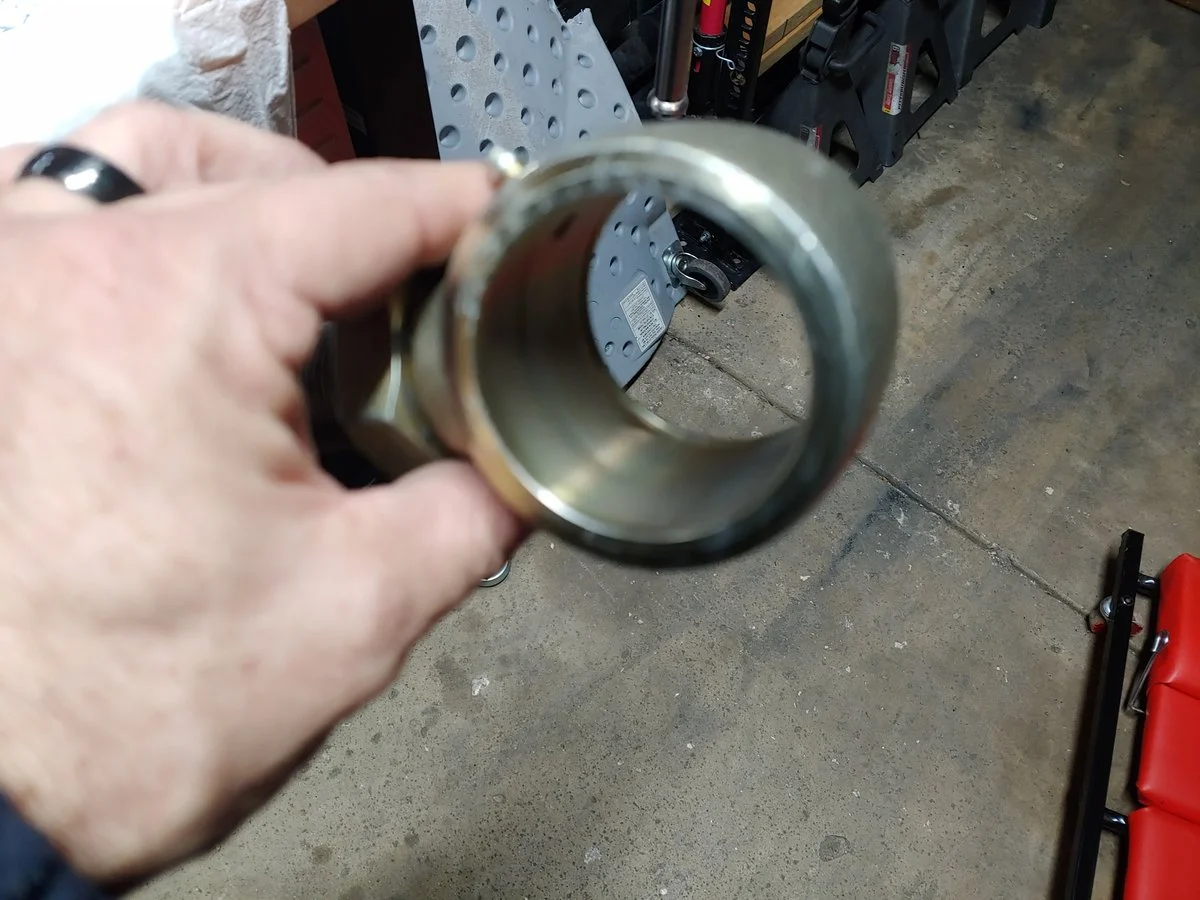

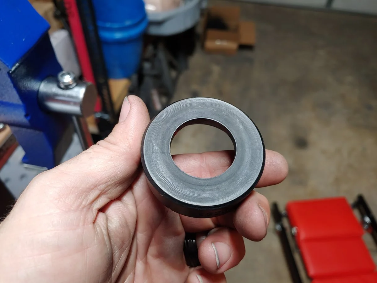

Here you go @mrblaine ... JJ disassembled. Photos before and after cleaning. I picked the joint with the least movement and making the most noise. I tried to get as many angles as possible since you won't be inspecting them first-hand. There seems to be a couple rotational marks on the center ball that wouldn't come off. Let me know your thoughts. Thank you.

Put some Redline CV-2 on just the ball and a light film in the races. Line them up carefully when you mash them back together and you should be good. The machining marks around the center of the ball are fine, don't worry about them.

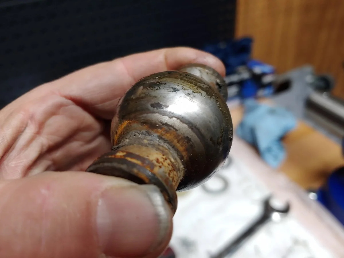

Good deal. I don't have Redline CV-2, but I do have the JJ moly grease that Currie gave me. Can I use that or should I get the Redline? By the way, just took rear LCA off and was worse than front. Dry and rusty, wtf?
Exactly why I don't like the body mounted grease fittings. I would not put them back together without the CV-2.
It is very easy to test why we use it. You have the stuff from Currie. Do one with it and then the other with the Redline. Put a screwdriver through the bolt hole and check the breakaway torque. The difference is astounding.
