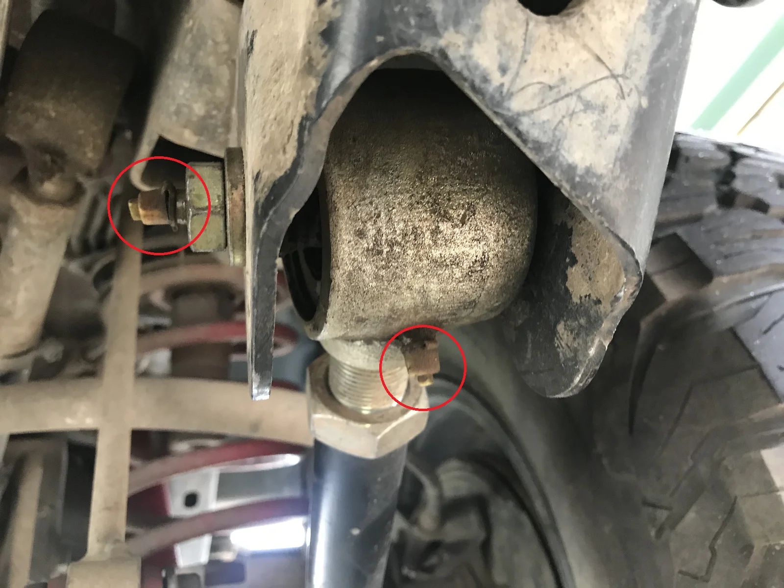

I've had 3 experiences with the fittings.
1. Won't take grease
2. Force grease in and it comes out around the bushing, between the arm and bushing
3. Force grease in and explode the bushing, that happened on an upper.
Those are the only 3 outcomes I've experienced

Potentially dumb question:
Is it a bad idea to try and use the grease zerks at all? In some cases so have been successful squirting grease through them, but not always. I’d hate to risk damage.
I don’t think I would bother, they’re easy enough to service and the pressure your grease gun may get to is pretty high so there’s a small margin of error.

I explained how it came to be that a nearly useless grease fitting wound up in the body. The only thing more silly than a nearly useless grease fitting would be NO grease fitting because the internet would never let that pass. OMG OMG OMG, however will I grease my joints? Oh Fuck, Currie sucks so bad because they didn't put a grease fitting in the body.
When I tried to grease them initially, being a 1st time JJ owner, I thought why in the world would anyone put a grease fitting on that you can't actually use? Mystery solved, thanks to this thread. The JJ grease fitting can't be used, but has to be installed, because the public demands it. The genius of the consumer is sometimes more than the mind can comprehend! o_O
Youse guys are joking around about marketing genius have given me an idea. Since I have zerks on both the bolt and the joint body, and if the Johnny Ball is drilled, and if the poly-whatever part of the joint is drilled, I can remove one zerk and use the other to pump grease through the joint. I might need no stinking tool. :)

Why are they where they can get knocked off?

Just let him wipe the zerk out with a Jack stand. It's not useful anyway.
Admission of guilt...I know a Jack stand will wipe out a grease zerk because I installed mine that way too, before I knew those zerks were useless and I wanted them accessible. Then I placed my axle on Jack stand at a convenient place... And proceeded to crush the zerk.

As another example, look at the grease fittings on u-joints. People actually do ask for them, which is why they sell versions with the fitting and some without. Just because the fitting is there, doesn't make it better, but the public wants it.
What do they do with the fittings when they get it? Either over grease, or under grease them. The sealed u-joints, without grease fittings then go on to live 200K miles. The greaseable ones don't. My point here is that in order to show that the providers are responsive, they sometimes have to do what doesn't make sense, if if they know it doesn't. I'm not saying it's right, simply that it is.

I explained. John invented the JJ. Then when its success was noted, others started knocking it off with cheaper versions. In order to compete against bullshit copies that are not as good, not the same and whose only value is a lower price point, John deleted the greaseable bolts as standard in order to reduce the selling price. In self defense, they added a grease fitting because the omission of same would cause far more bullshit than one that isn't exactly as useful as it should be. Like it or not, believe it or not, that is the way it happened and your insistence on being a little shit won't change that.
