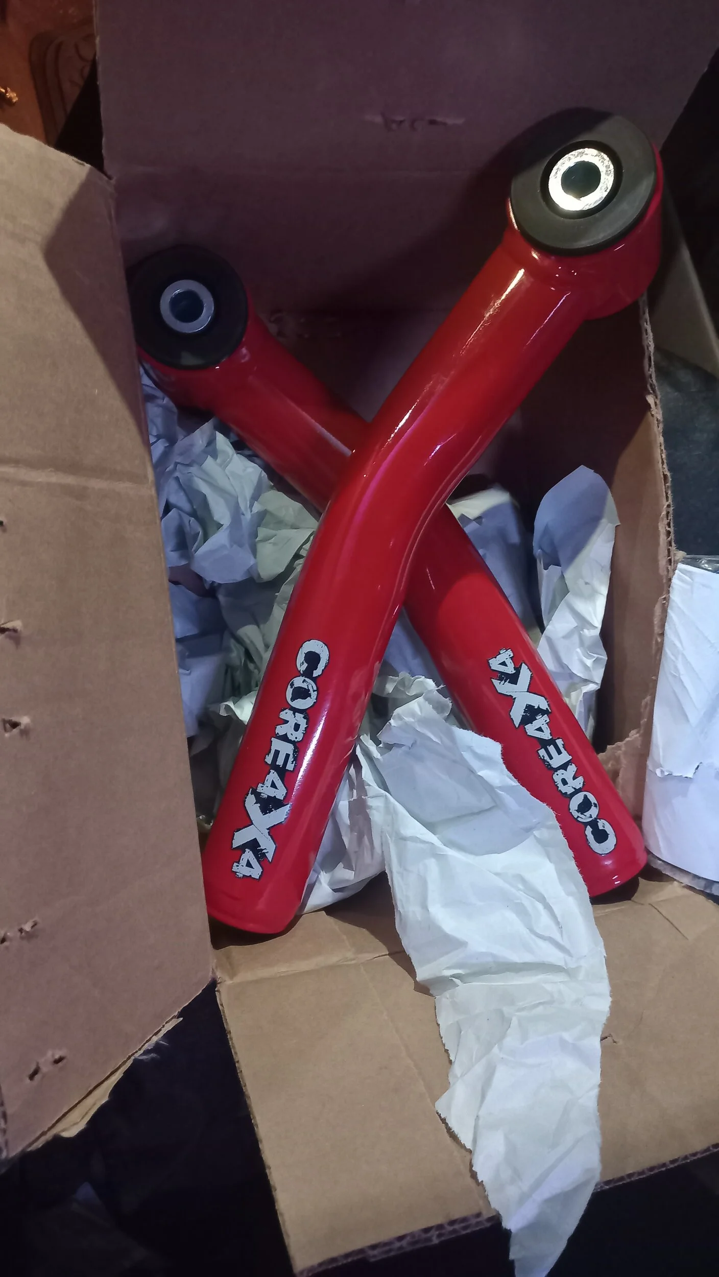

I recently got my new Core 4x4 control arms (the cheapest ones) with the intention of upgrading the adjustable ends with Johnny Joints, but then I crossed the idea of Antirock being mentioned by everyone that has been "the best upgrade done to their jeeps" so..... what would you guys think is better to upgrade first? the JJ in all the adjustable ends of the Control Arms or the Currie Antirock? (currently I have quick discos..) since the price would be around the same for the JJ and the antirock..... thanks!
