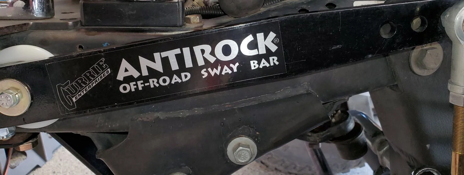

Currie/Rockjock Antirock Off-Road Sway Bar
Although the bars are now forged and the newest version has 3 adjustment holes on each side rather than 5, the Currie Antirock and Rockjock Antirock are functionally identical and share the same part number for the TJ. The name change primarily reflects corporate reorganization by the Currie family.
The Currie Antirock is a front anti-sway bar specifically designed for offroad driving. It works in conjunction with the rear anti-sway bar keeping both front and rear bars connected to evenly distribute forces between the front and rear axles aiding traction by keeping the weight on the tires. While much softer than the factory front anti-sway bar, the Antirock still helps control body sway and lean when off road making side slopes and off-camber situations less treacherous to negotiate.
There is one school of thought that advocates running the Antirock in the stiffest position that does not limit the desired articulation. [ @jjvw is from this school.] This practice results in a compromise position that still fully articulates while reducing body roll on the street as much as possible considering the limitations of the design. In my case, setting the arms at the recommended 10* angle from horizonal and putting end links in the middle position provided “okay” highway manners and full compression offroad without interference between the arms and the inner fenders. Moving the end links rearward to the 4th or 5th position would have resulted in undesirable although still manageable body roll on the street and potential interference between the arms and the inner fenders off road. The latter could have been remedied with shorter end links making the bars more horizontal on level ground, but there was really no benefit from doing because I already had all the articulation my tires and fenders would allow at the middle position.
There is another school of thought that the end links should always be set in the rearmost position allowing maximum articulation and that the resulting highway manners will still be “good enough.” [ @Jerry Bransford is apparently from this school.] The descriptor most often used is that the highway ride is “fine” or that the writer “regularly drives on twisty roads” with no issues. Such rationalizations may work for a rig that is seldom driven on the street or only to the trailhead and home, but it is less than optimum for a jeep that is driven long distances or is used as a daily driver. It is respectfully submitted that “good enough” is not synonymous with “good,” and “fine” is not the same as “the best it can be.” The Antirock is excellent at what it is intended to be, an “Off-Road Swaybar, but it is not so good at being an on-road anti-sway bar.

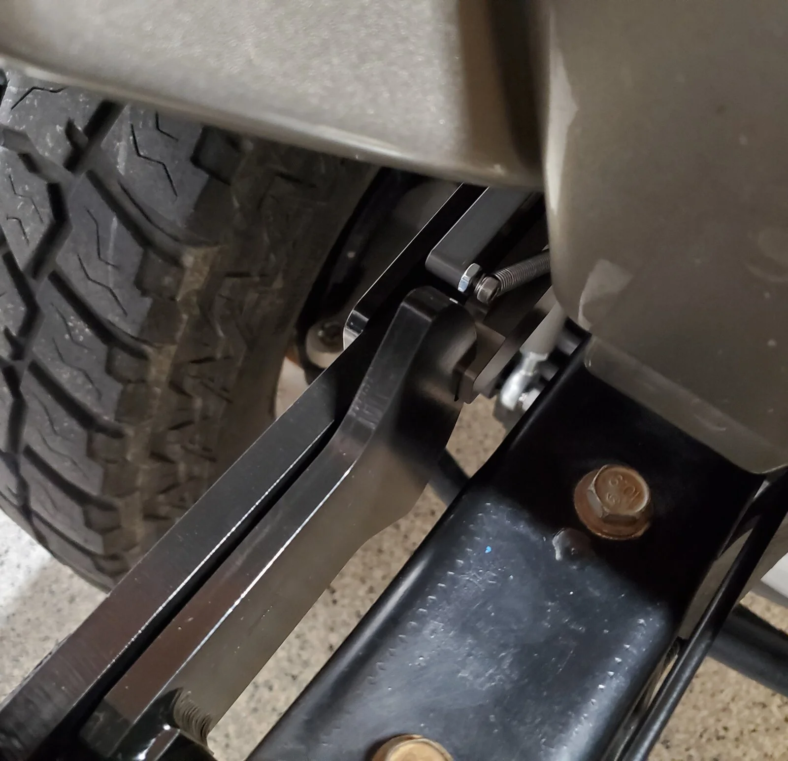

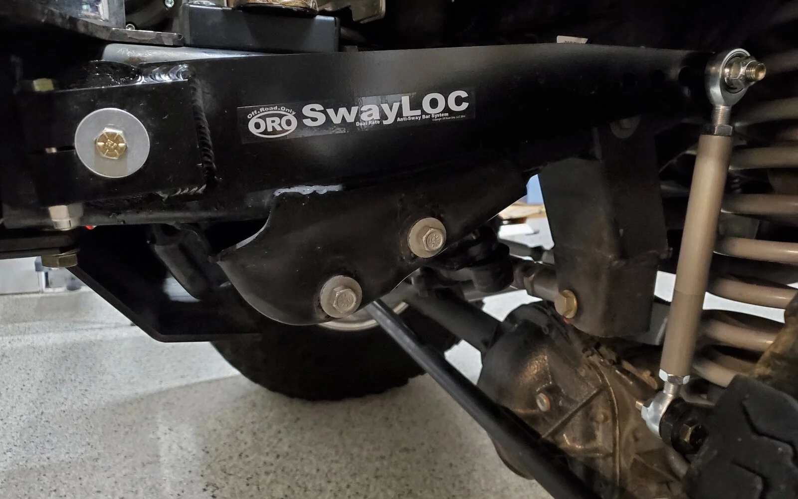

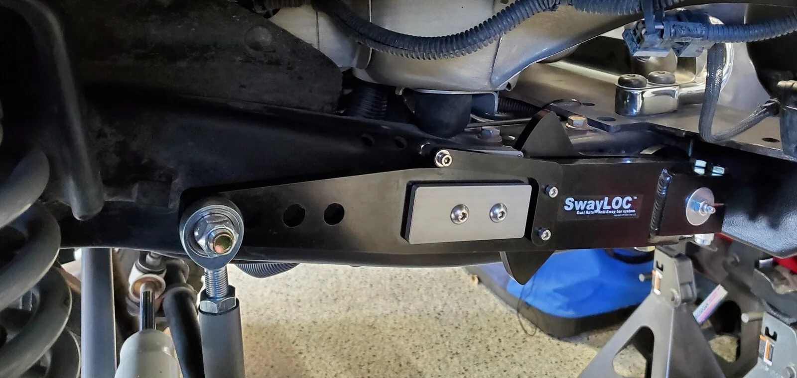

SwayLOC.jpgSwayLOC Installed Driver Side wide view.jpgLatching Arm.jpgSwayLOC passenger side.jpg
A cursory Internet search will reveal that Blaine Johnson (aka @mrblaine) was involved in the initial design of the SwayLOC and that the product was first brought to market in or around 2005. Further reading suggests that the business relationship between Mr. Johnson and the licensee of the design didn’t work out as planned and that Off Road Only had customer service issues related to ongoing changes/improvements in the product during the first few years after release. However, that same search will reveal that despite those issues, and despite the business relationship that hasn’t worked out as planned, Blaine Johnson still believes in the design and regularly purchases and uses the ORO SwayLOC in his jeep builds. In fact, it was Blaine Johnson who commented that my first reaction after installing a SwayLOC would be to wonder why I had waited so long to buy one and it was Blaine who was instrumental in a SwayLOC arriving at my doorstep.
From the SwayLOC installation instructions:
“SwayLOC is a dual rate anti-sway bar system that allows the operator an easy method of changing from on-road rate to off-road rate. The on-road rate is similar to the OEM anti-sway bar but allows a more compliant ride on highway. The SwayLOC will absorb some of the jarring that may be transmitted to the vehicle thru the OEM Anti-sway bar. The off road rate is unique in that the SwayLOC will allow full range of articulation on most vehicles, but will continue to provide resistance and will usually deliver a more balanced feel of the vehicle. This balanced feel is especially apparent when used with a rear antisway bar.”
My initial impression of the SwayLOC:
Handling on the road is even better than with the factory front anti-sway bar, handling and articulation off road is exactly the same as with an Antirock Off-Road Swaybar, and switching between the two is quick and effortless. In short, “Why the hell did I wait so long to buy one?!??” It is the best of both worlds for only $200-250 more than just an Antirock. Thanks, @mrblaine.

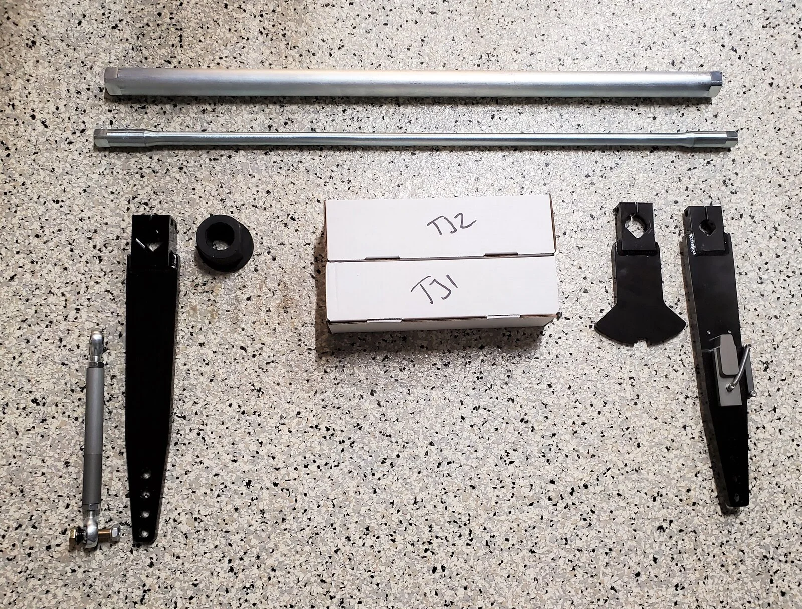

The OEM front anti-sway bar is 1.20" in diameter. The SwayLOC outer torsion tube is 2.50" in diameter. The SwayLOC and Currie Antirock torsion bars are both 0.75" in diameter.
The Currie steel arms are 1.75" wide at the widest point and 3/8" thick. The five end link attachment holes are 12", 13, 14", 15" and 16" from the pivot point. [The Rockjock version omits the closest two holes; the three holes remaining are in the same position as the rearward three holes in the Currie version.]
The SwayLOC arms are 2.50" wide at the widest point and 1/2" thick. The four end link attachment holes are 12.5", 13.5", 14.5" and 15.5" from the pivot point.
