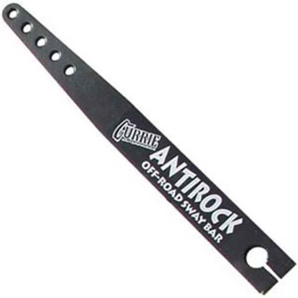

I grew tired of the Anti Rock sway bar on road. I only put around 2-3000 miles on my LJ each year, but it was enough for me to decide to put the stock sway bar back on, especially since I might take it offroad 1-2 times a year these days. This Swayloc has me reconsidering!

You won't be sorry. Arguably the best mod for the money.

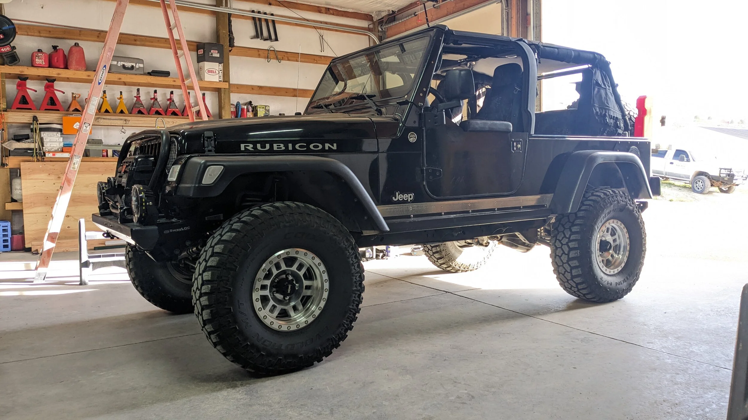

Well good news! I ordered the SwayLOC yesterday to replace my Teraflex single rate s/t swaybar. I found a shop that is interested in the Teraflex swaybar so they are going to remove the Teraflex and install the SwayLOC. Best part is, they are going to cover the labor to do the swap because i'm giving them the Teraflex for free in return for installing my SwayLOC. I should have it all done next week after it shows up. My LJ will have SwayLOC up front and I just installed the rear Currie Antirock on it last week. Should be nice and stable offroad in the rocks.

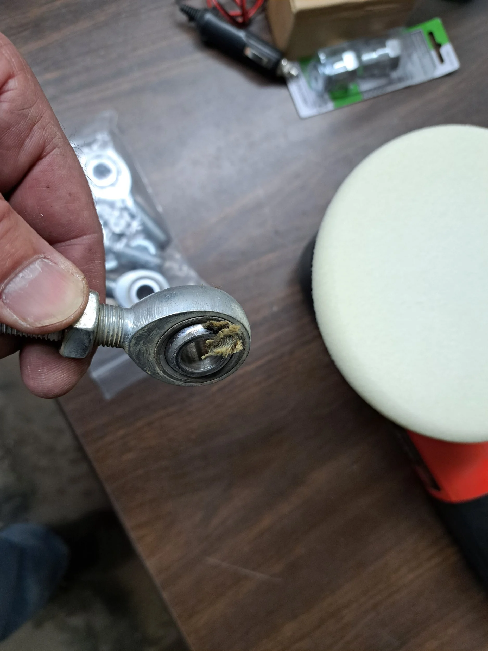

Outside of maybe a few shops, I doubt you'll find any that have installed and been around more of them than I have. The only quality issue I'm aware of in the current iteration which is about 7-8 years old, are the link rod ends. Some of them wear faster than they should.

I haven’t had any issue with the heims. I’ve had it 2+ years. If you have trouble get some good heims and be done with it. Dual rate rocks!
