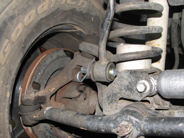

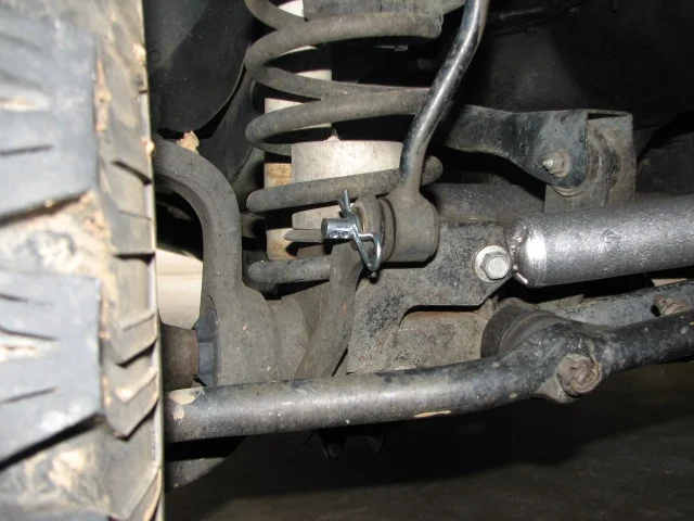

To put it simply, the anti rock keeps the body more level and supports traction to the lighter or up tire. Not necessary for a newby or mild trails. Go wheel first, then decide if you need/want it. You can make your own quick disconnects for $10 at the hardware store.

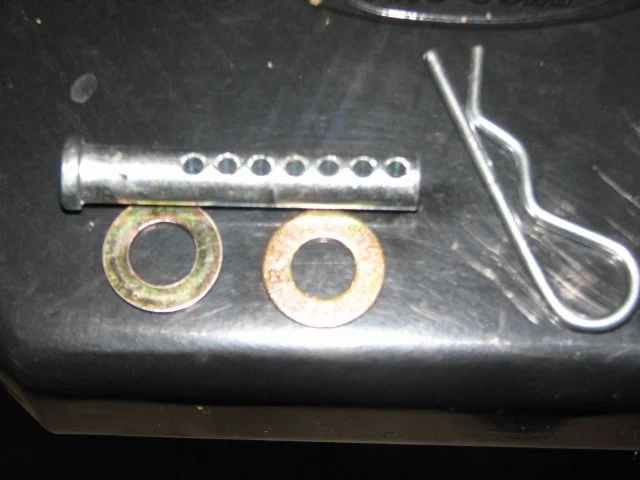

I'm not even sure a how-to for this is needed. It's so damn simple.
This is all you need:
2-1/2"x7/16" Clevis Pins (2)
Cotter Pin (2)
7/16" Grade 5 or better washers (4)
You can get these parts at ACE Hardware. Just make sure to get the highest grade you can, Grade 5, but preferably Grade 8.
