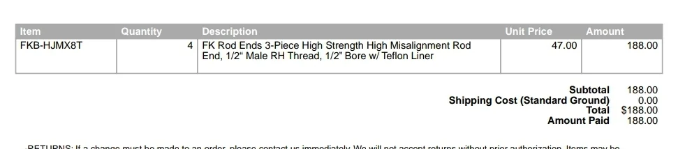

Look about right? A bit less coin than your selection.
https://www.summitracing.com/parts/fkb-hjmx8t?rrec=true
Finishing the SL install this afternoon so re-read the thread and found your links. Might as well have them on hand to swap if/when needed.
TIA
Looking forward to the test drive.
The part number looks different, but I didn't spend much time making sense of it. What I got were the higher misalignment rod ends because the 12" shock travel was binding the ones SL provided.

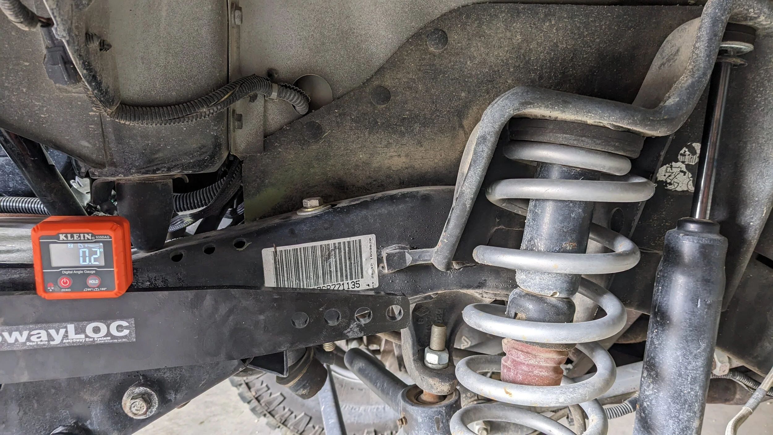

You aren't in control of that space. That is controlled by the width of the notches on the ends of the two torsion bars and the width of the tube that goes through the frame that the bars sit in. The two sets of arms need to be roughly flush with the end of each torsion bar. If that leaves a small gap between the inner and outer arm on the right side, that's fine, if it doesn't, that is fine as well.
This is such good news. Just finishing up the SL passenger side and find no gap. The instructions made me shudder.
As stated, roughly parallel to the ground to start, move up if they can invert under full droop, but not so high that they run into something above the frame like the grill or inner fender.
Good starting point?
10" shock, jacked up to 5" showing, SL set at 0*, level with floor.
@ Ride height 3.7* D, 3.9* P
Confirm whether/where there's contact?
Ya, I can do that. Wonder if my buddy will volunteer his forklift 😉.
Gotta say it feels pretty good thru the roundabout and at 60 mph.
You don't need a forklift. You know how to cycle axles already. Now imagine how you would get the sway bar up move up and down with the axle without it twisting at the torsion bar(s).

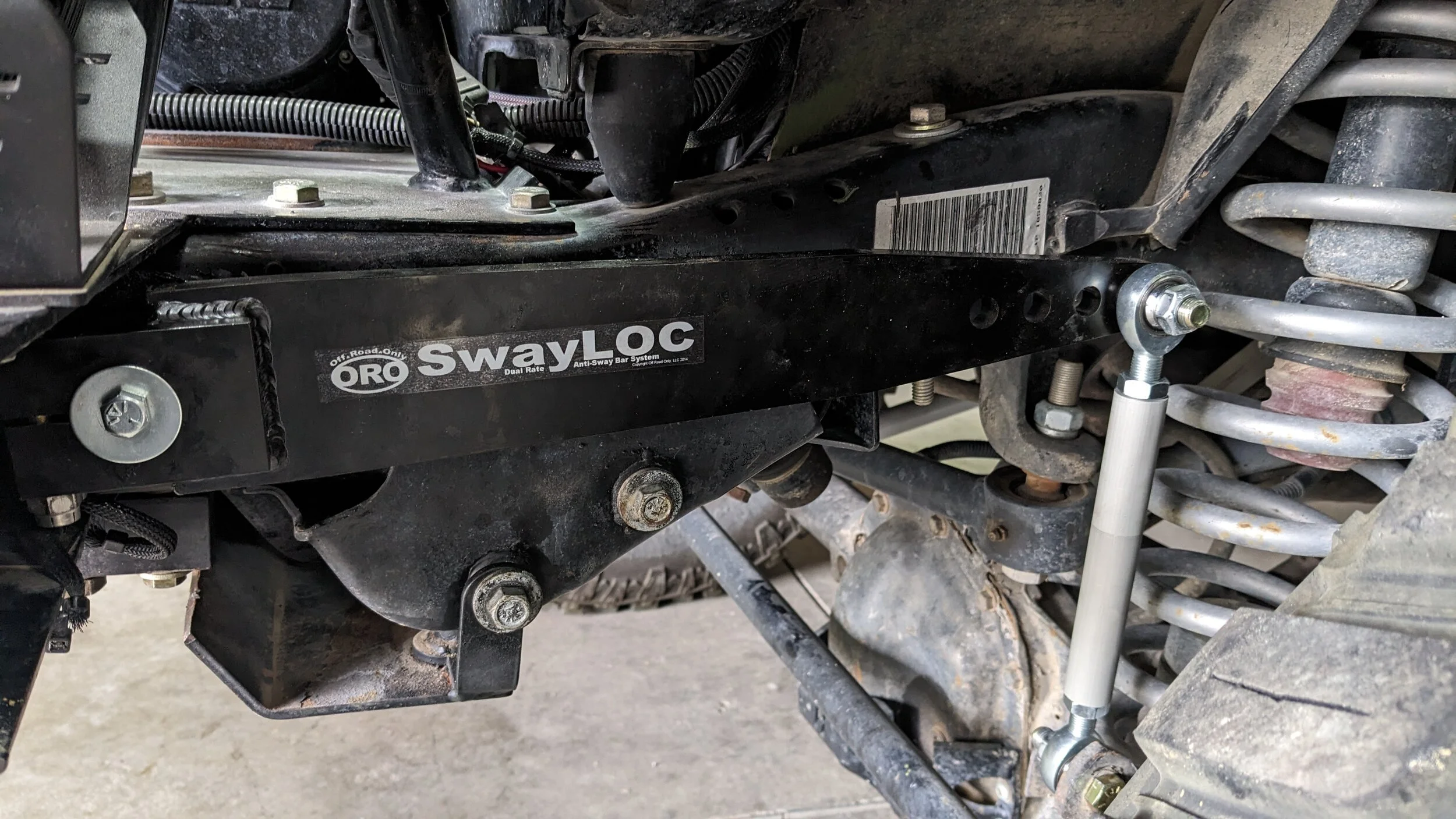

I just received my new air actuated SwayLoc today to replace my Antirock. I figured there has to be a reason it's on the passenger side because it's not as convenient to access versus the driver side.
You're thinking the wrong way - its on the passenger side so your wife can get to it quick when you tell her! ;)
