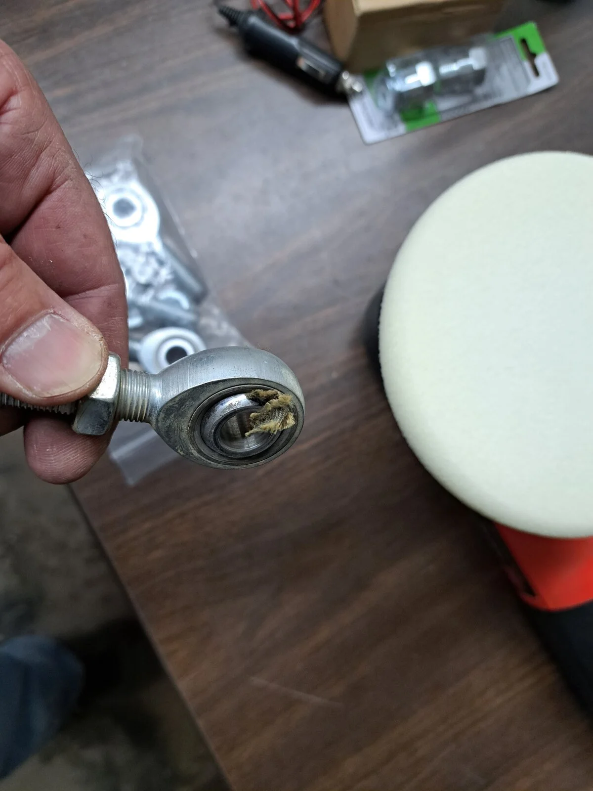

Check to be sure the rattle you hear isn't the heim joints. I've had 2 fail on me in a short amount of time.
If that liner you see working its way out escapes completely, the heim rattles like the Dickens.

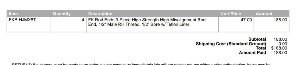

The provided heims have been the only noise I have identified coming from the SL. They survived about a year before the liner squeezed out, but I think I also damaged them with too much shock travel. The FK rod ends I replaced them with are still tight three years later.

Wouldn’t happen to have a link to those?
