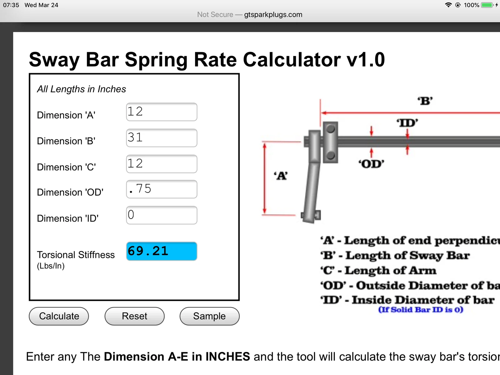

This is a rough calculation of the torsional stiffness of an Antirock. It’s about haLf of most spring rates per inch of travel.
