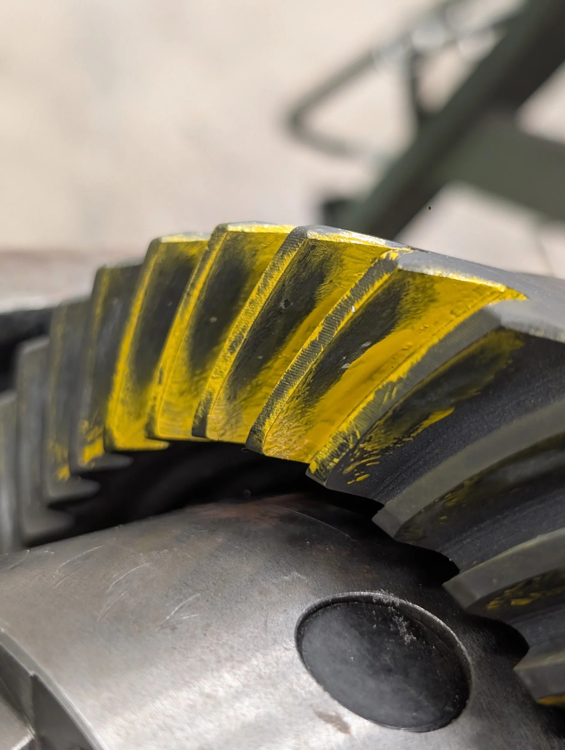

@hosejockey61 +3 thou, backlash is at 6

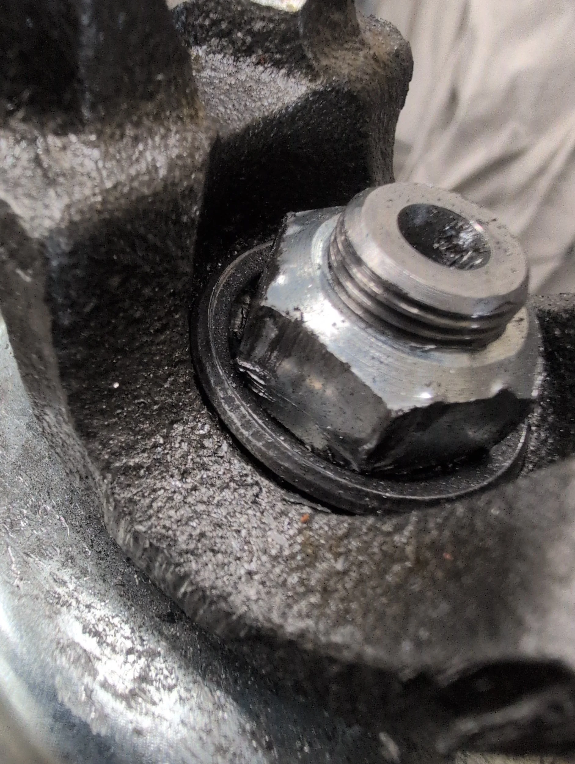

New development, I'm having difficulty setting the preload. The more I tighten the nut, it just destroys the washer & doesn't get any tighter

Update #58

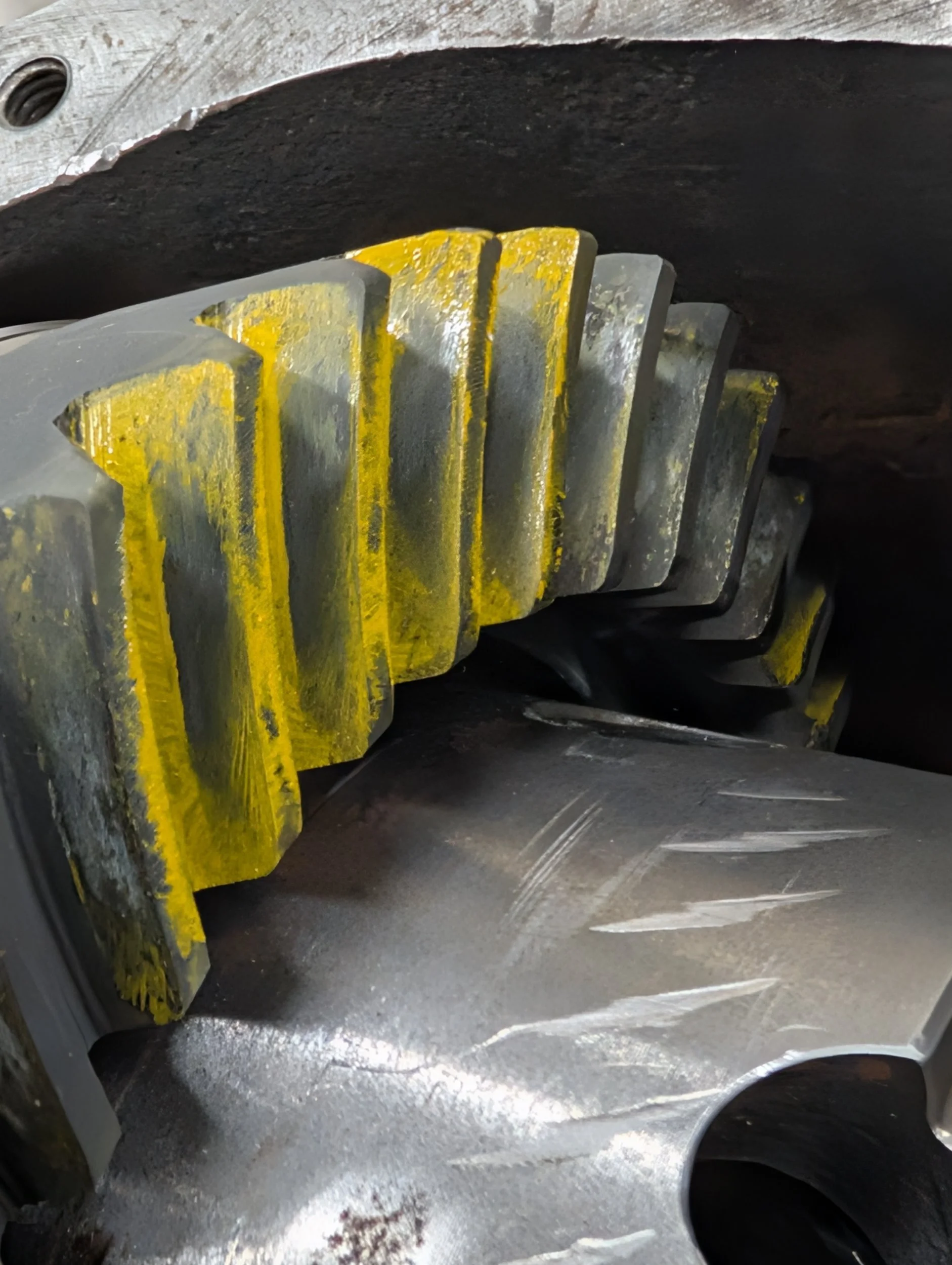

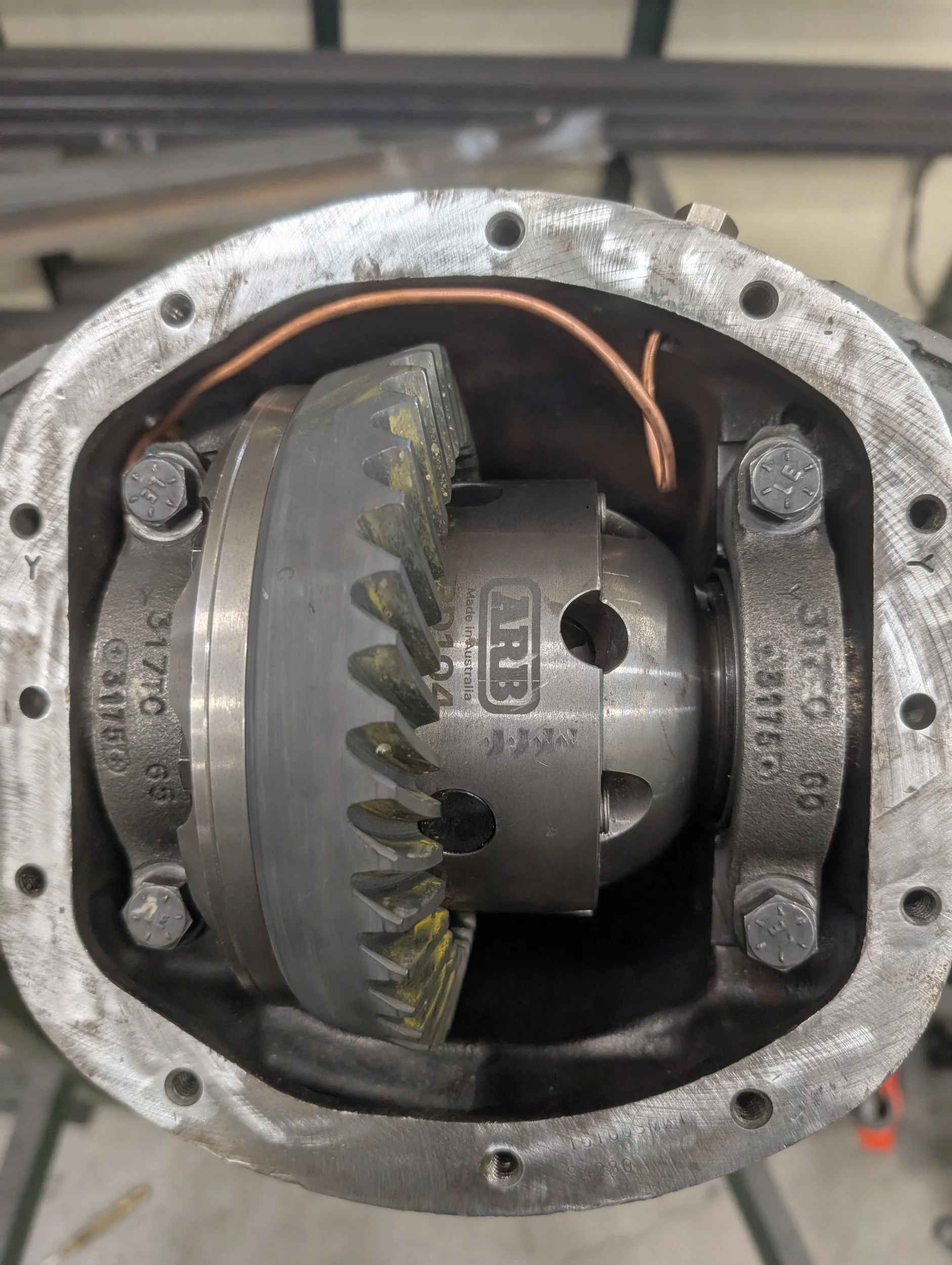

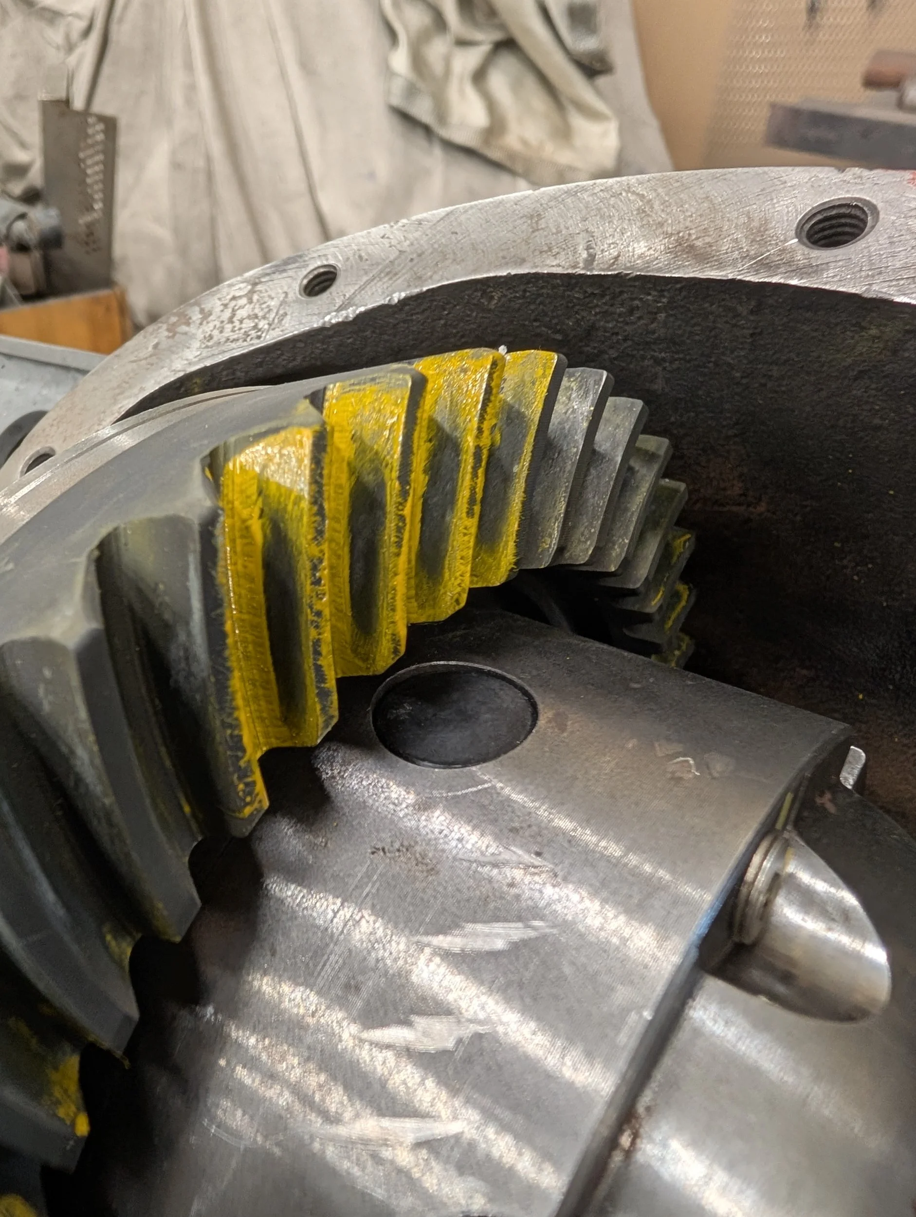

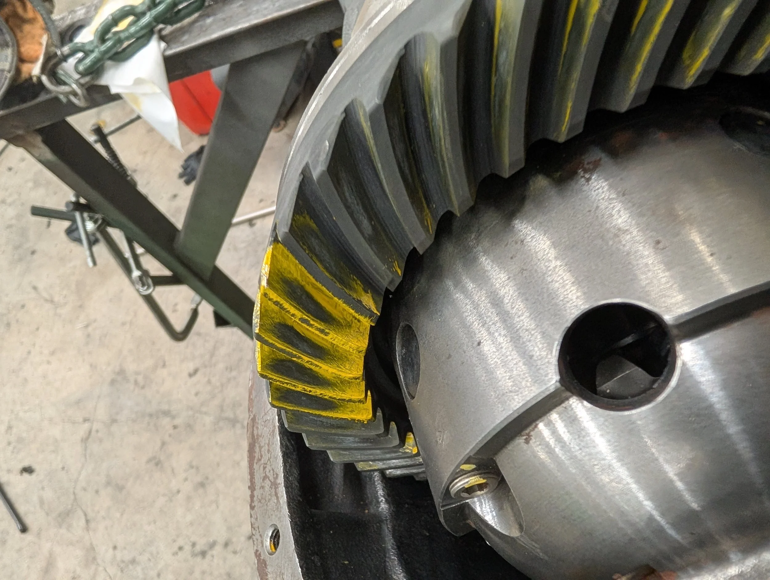

It's been awhile but I'm back in the garage. I didn't get much done but I'm happy to report that the front gears & locker are done. FINALLY. That crush sleeve really gave me some frustrations. I ended up ruining another crush sleeve but luckily I ordered a spare just in case. I got the preload set around 18-19
I also spent a few hours cleaning & wrapping my head around where I left off. I still need to get the rest of the front axle assembled & installed.
