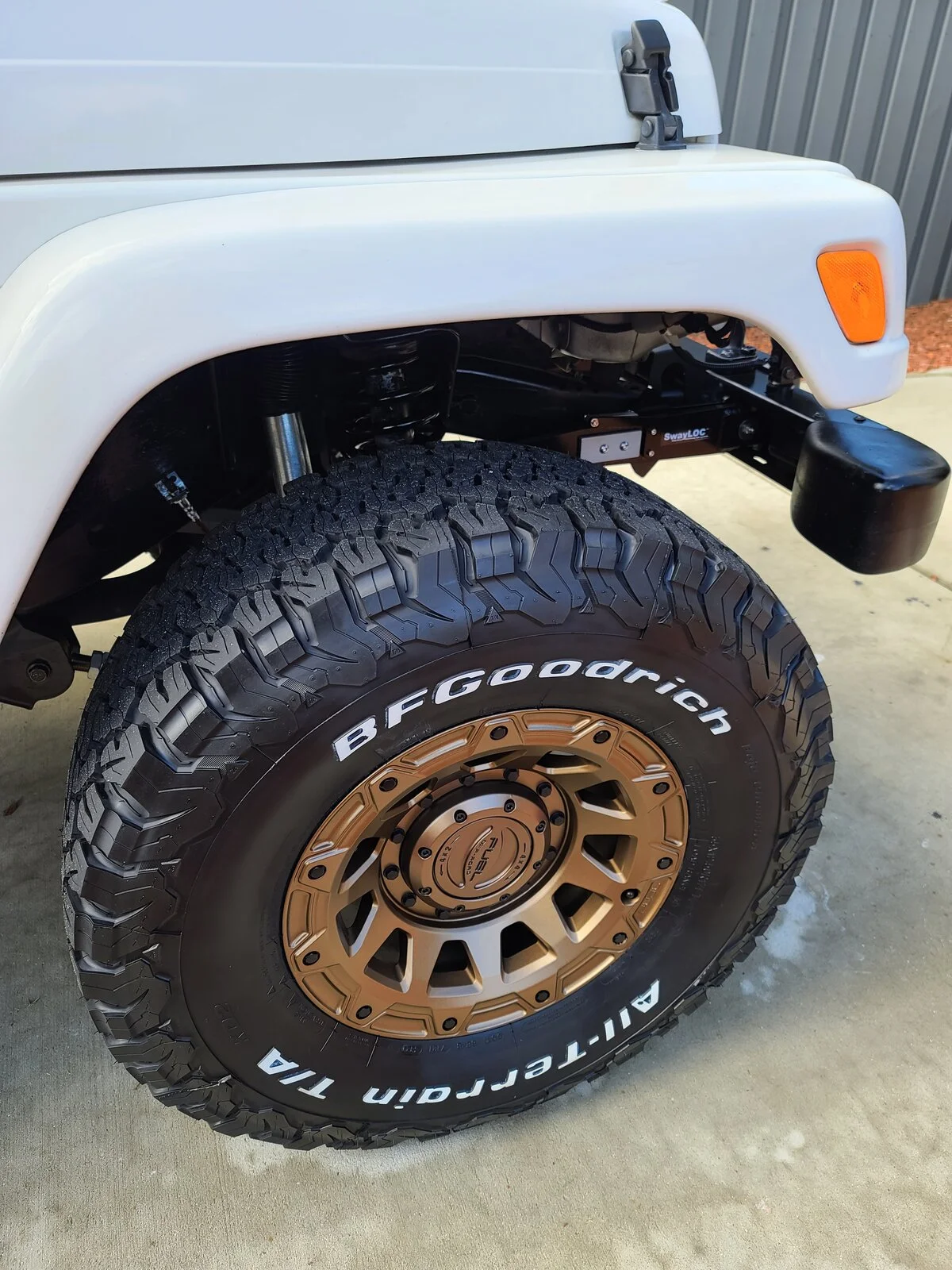

Modoc Guy, A few below deck mods in the past months:
Pics to follow.
4" Currie springs
Currectlync Tie Rod system
Currie RockJock front track bar
Currie Rockjock rear track bar
Red-Head Durango steering box
Bilstein 5160 rear
Bilstein 5100 front
SwayLoc front sway bar
Metalcloak double adj complete set
Adams driveshaft w/ SYE
4.88 gears
Front TrueTrac
Rear Trac Lok (already previously installed)
Yukon front Dana 30 chromoly axle kit
Yukon rear Dana 35 chromoly axle kit
Fuel 17" Bronze wheels
BFG KO2 17"

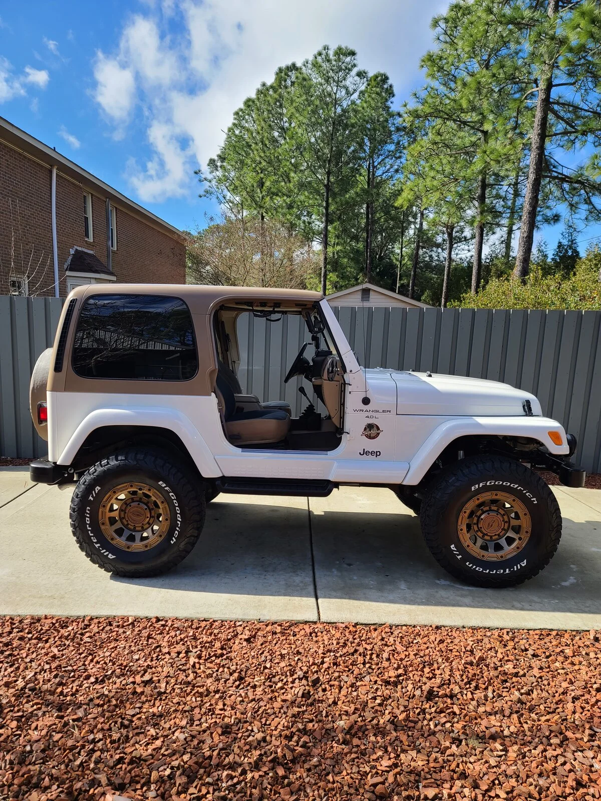

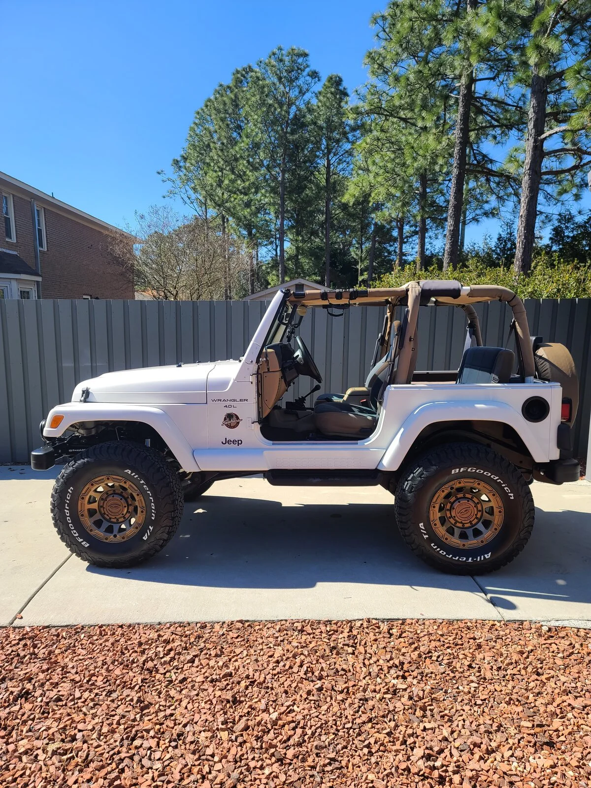

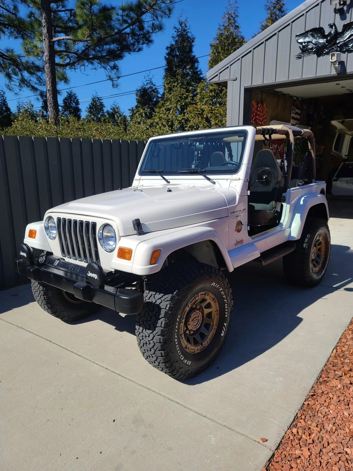

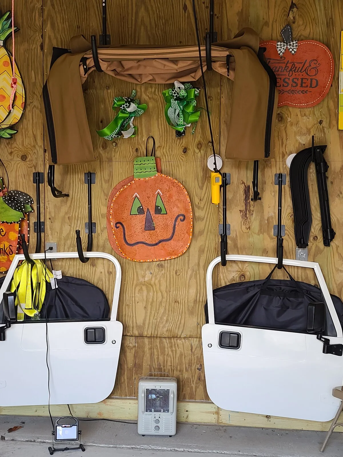

pics (of "wife's" Jeep and her "Jeep shed")

Man, you've got that rig squared away!
And it looks great! I like white. 👌

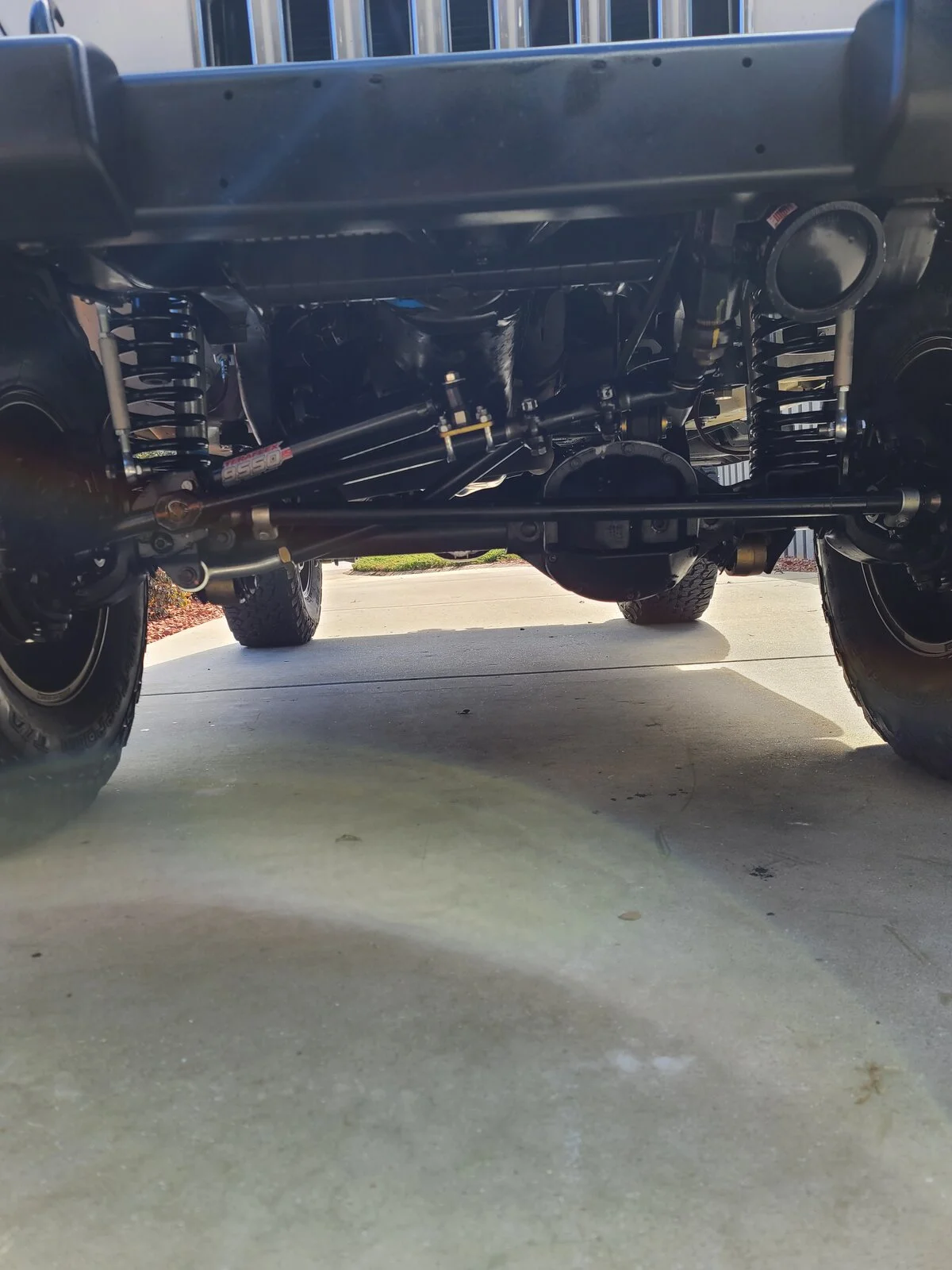

Your stabilizer bolt should point to the rear. Plate goes on the back, u-bolts on the front, bolt is back and angled upward slightly.
Reactions: Kiwi TJ
Thank you for checking that out. I'll get it corrected. Will I notice any difference while driving or in wear once corrected?
