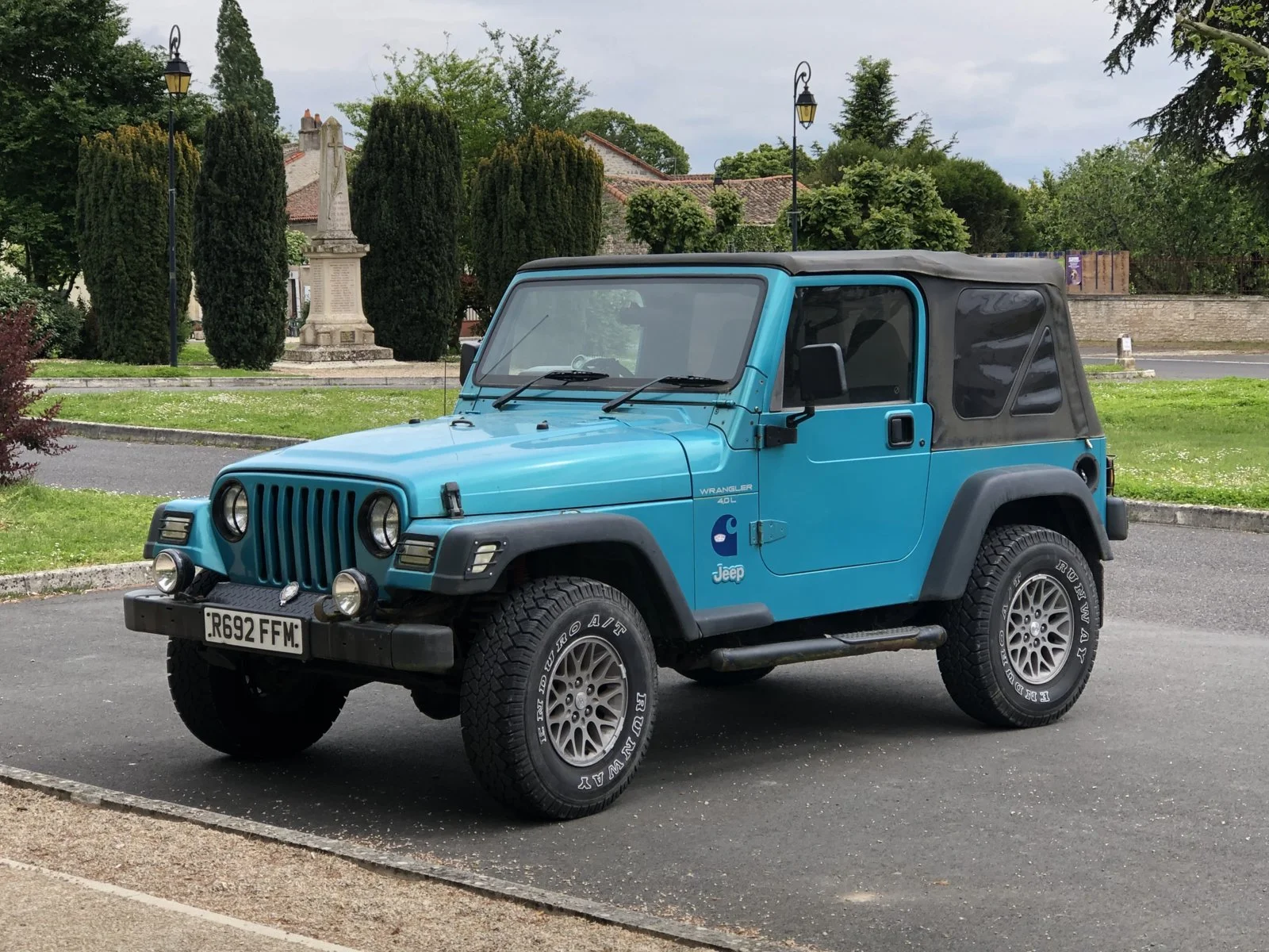

Just picked up a TJ

A couple of weeks ago I asked advice on the forum if there was anything I should do to a Jeep if it had been sat for several months. I planned to change the oil and check filters, belts, brakes etc.
In the end, it rained so I just made sure it had some oil in, changed the battery and checked the tyre pressures. One of the tyres was completely flat and the battery was difficult to change. It’s on the left hand side in a right hand drive Jeep, not easy to change because some relays are in the way and it has a heat shroud around it.
I set off from central France, back to UK the following day in pouring rain. Driving at 50mph, it was all over again the road and really difficult to steer. I got off the road soonest and headed back, I thought a rear wheel bearing or the diff had let go as it was making such a racket. Looking in the side mirror, I could see the wheel wobbling about. I checked the wheel lug nuts and they were all loose! Yikes! All tightened and back on the road for an uneventful trip home.
Things about the Jeep that I like/dislike (in no particular order/sense):
The soft-top makes it really noisy (my ears are still ringing)
It comfortable to drive, I’m 6ft 5
The engine runs out of puff on a long hill requiring a couple of downshifts to maintain speed
The soft-top doesn’t leak
The sills are really tall making entry/exit difficult
The gear shift is very smooth
I could only do 52mph comfortably because the wheels require balancing
Rust has sprouted on the front fenders/wings
Hopefully, it’ll pass its annual test tomorrow. I’ll let you all know how it gets on.

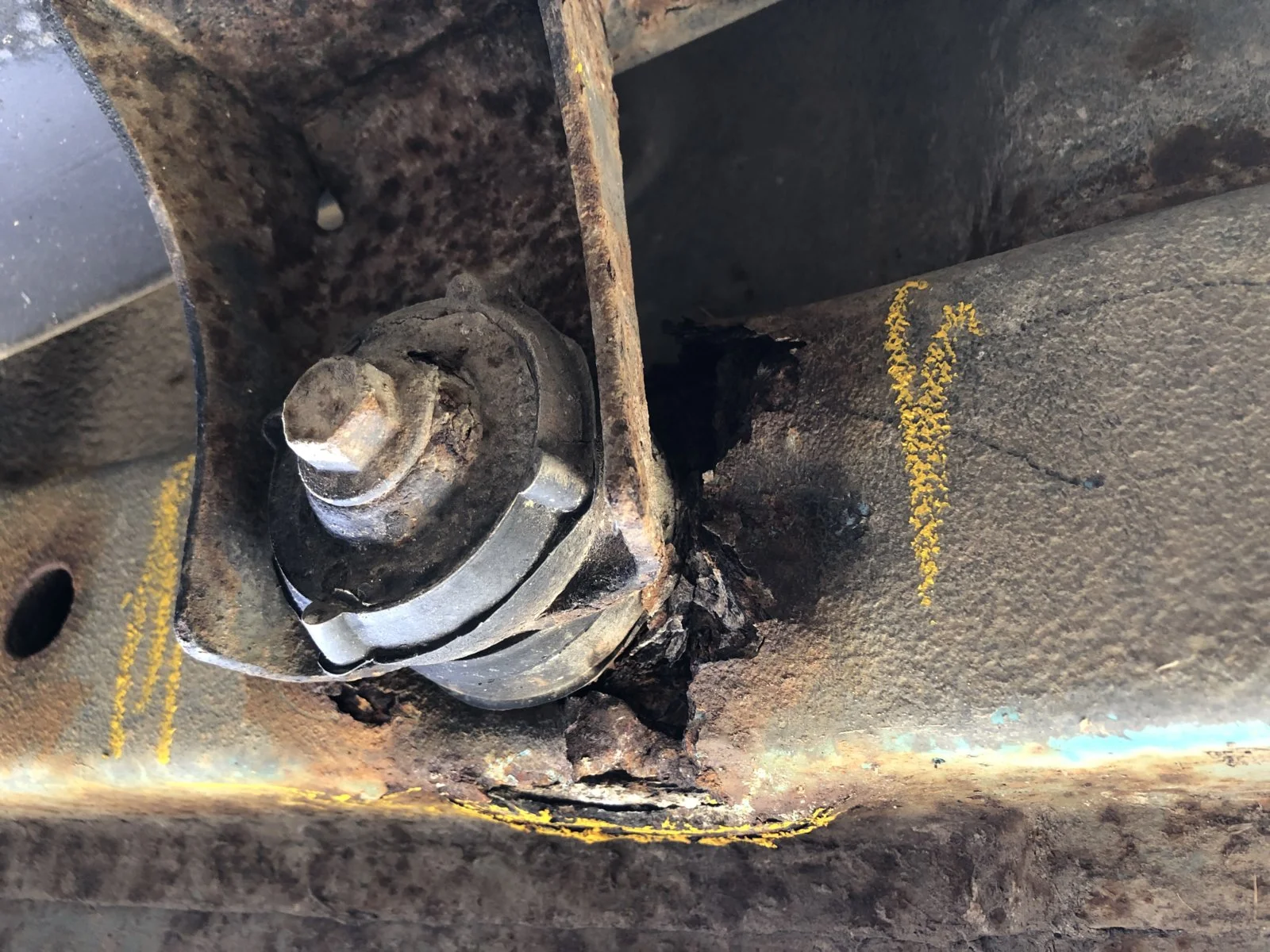

I can’t recall when I last saw a Jeep Wrangler on the road in UK. It failed its annual test. 😩 Badly; very badly!
It also lost 1.5 litres during the test; it’s a 4.0 not a 2.5!

It looks like the inspector thought your TJ was a bit too rusty.

I’ll probably get it repaired. It’ll still be worth more repaired than if it had a one way trip to the scrapyard.
My wife is horrified that I have just driven it nearly 500 miles with “Dangerous defects”. I drove it home from the Test Centre too!

The “fuel pipe corroded *Dangerous*” made me smile too.

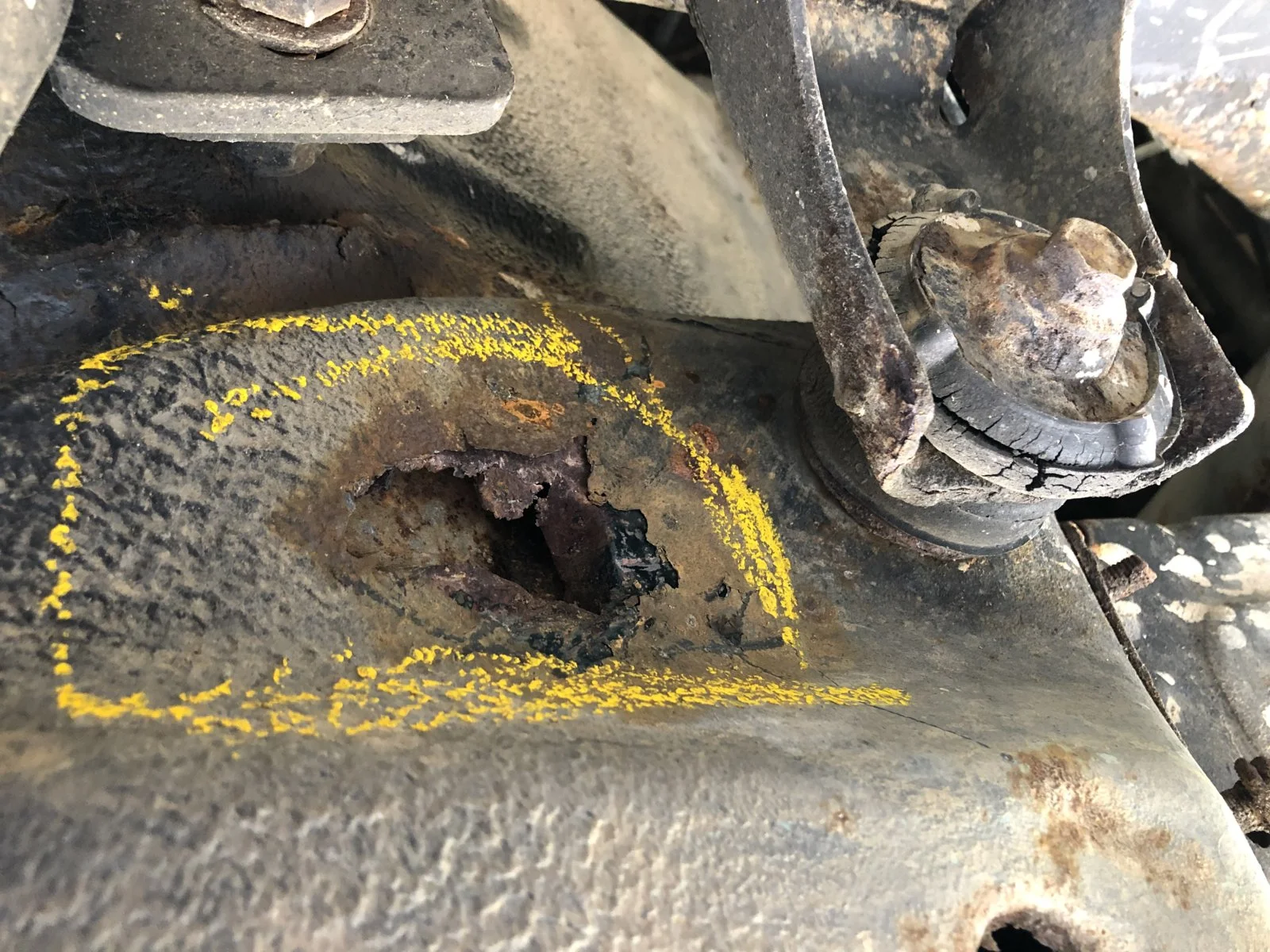

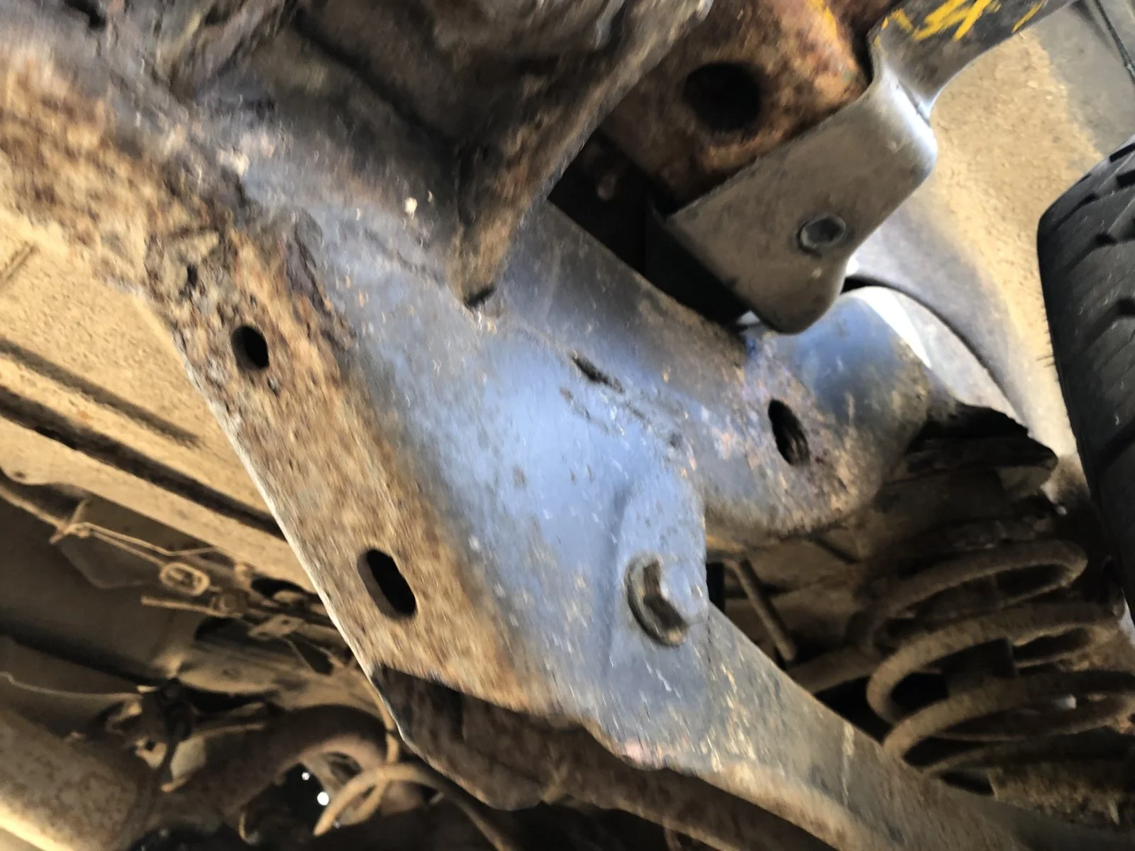

Some pictures of the corrosion issues coming up.
Some pictures of the corrosion. The main problems were where the frame joins onto the body.

That is all reparable. The surface rust around the control arms doesn't look too bad. That you could likely clean up with wire-wheel and then use a rust treatment paint like POR15. The center section looks like garbage (maybe you say rubbish), but these sections can be purchased from SafeTCaps. Likewise the torque box(s) likely need to be replaced. I didn't see fuel or brake lines, but I can image they look bad.
It will be annoying because every bolt is going to give you trouble removing it.
I didn't see any rust on the body so this definitely seems worth the investment to get the frame solid.
Many thanks for the encouragement DetroitTJ. After its MoT failure, I was really thinking about either just trying to sell it as “spares or repair” on a well known Internet auction website or perhaps breaking it for parts; but someone I know also thinks that it is salvageable and is coming to see the TJ tomorrow with a view of getting it welded.
