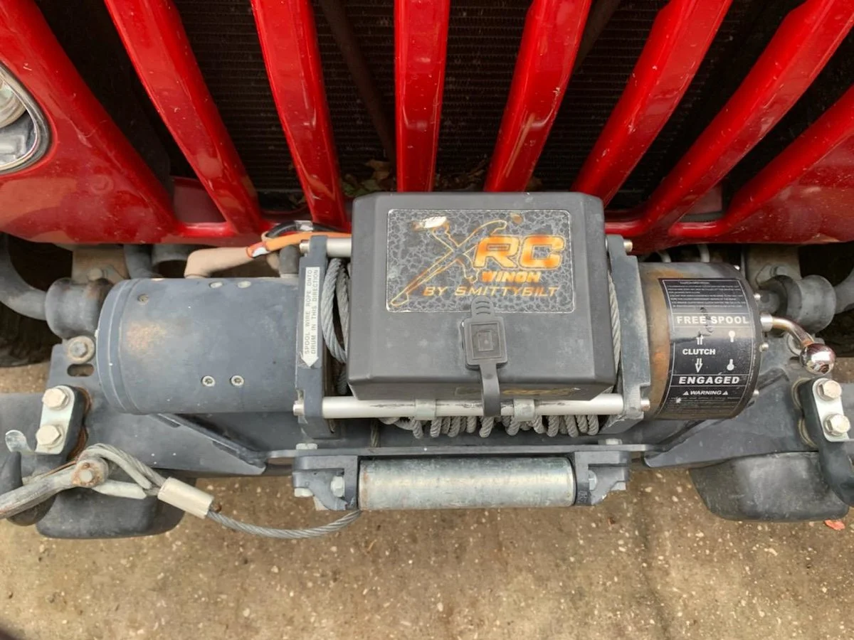

Thanks for all the options and help everyone! Looks like I'll move forward with the Smithybilt winch plate

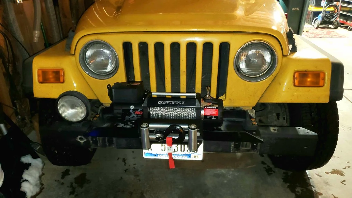

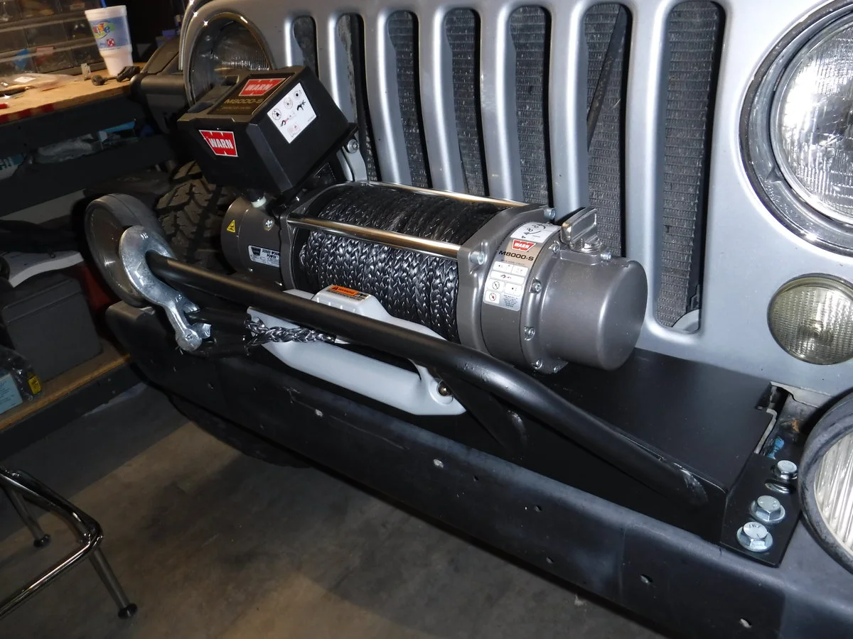

Tomken also makes a raised winch plate, which is what I mounted on my LJ.
https://www.mcssl.com/store/tomken/tj-yj-lj-perm-winch-plate
The photo below shows that there is plenty of room for tow hooks next to the raised portion, although I did use slightly longer bolts when I got around to installing them. I later replaced them with d-ring mounts which required much longer bolts.

I wish I had known about that winch plate before I had bought my Smittybilt plate. My Smittybilt plate had been fine, but I really like that winch guard that's on it.
Do you know the diameter of the tube?

That's a really nice mounting plate and my favorite of all the aftermarket designs. I had one on my previous TJ.
Reactions: Neal
I had to go out and measure it, it's 7/8" OD. Pretty skinny, but it works fine to protect the winch.
Reactions: MountaineerTom
Actually, Jerry, I have you to thank for the idea in the first place. I had just bought my LJ about 6 years ago and had been reading up on The Forum That Shall Remain Nameless when I came across a comment you had made concerning the Tomken winch plate and how much you liked it. After looking it up on the web I decided that it was the plate I would buy when I got a winch. I have been very happy with it and recommend it to everyone who asks about it.
I think it was about a month after I put my Smittybilt plate on that I came across the Tomken plate. 😖
