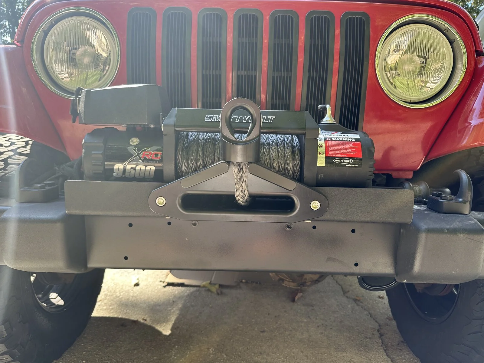

I’m running this EAG Winch Mounting Plate - 12000 lbs Capacity Fit for 87-06 Wrangler TJ/YJ https://www.amazon.com/dp/B00SKCTS8U/?tag=wranglerorg-20
It did require angle grinding for the WRG fairlead. Stock with rollers was perfect.

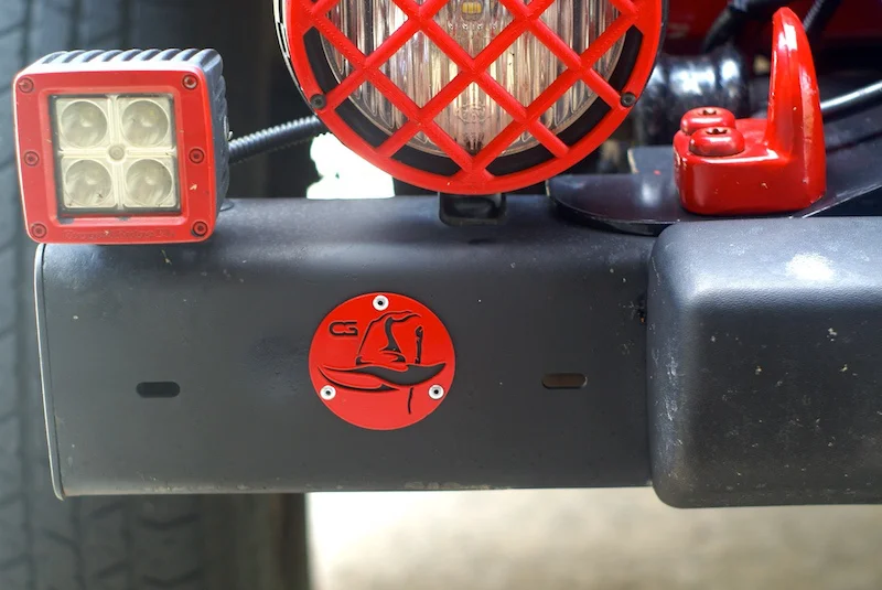

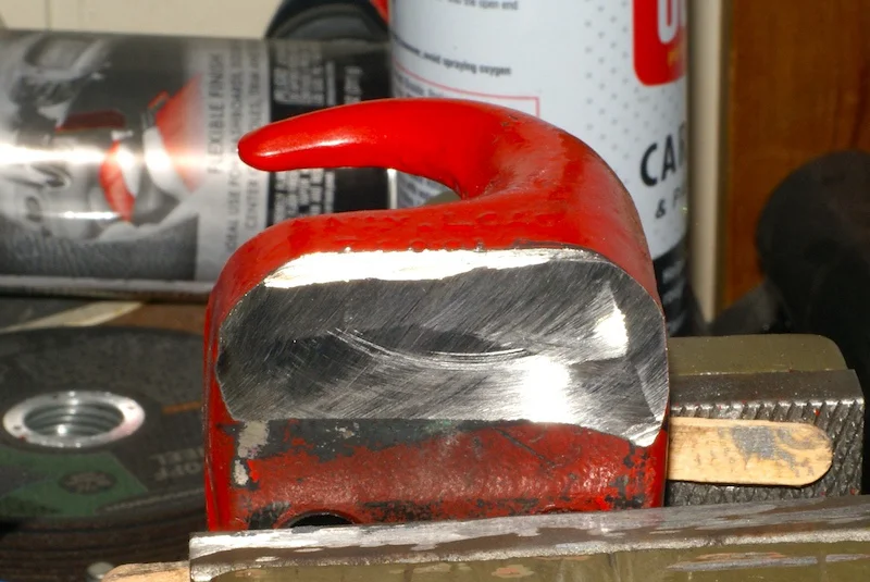

FWIW, its possible to use the stock front recovery hooks with most/many raised plates if you have an angle grinder:
Primed, repainted, and bolted back on!

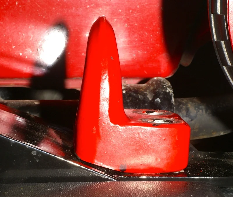

Going down the list as I read them so someone else may have pointed this out but the rest of the world just swaps the hooks side for side so they don't have to grind. ;)
And that works if you don't have stock foglites - or otherwise are using that location. There are also several very nice aftermarket hooks that will bolt right up either way as they're not as wide as the OEM with the offset holes.

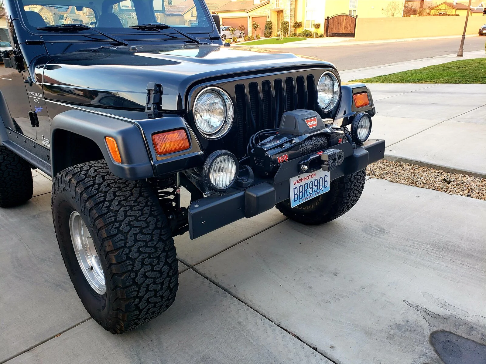

Anyone use this winch plate https://www.quadratec.com/products/92122_2900_07.htm. or something similar you can recommend for mounting on a stock bumper? I have the Mopar “Stubby” end caps and I am satisfied with this setup for the time being. Would like to throw a Warn winch on as my first mod. I would also like to be able to keep my stock recovery hooks as well and on some raised winch plates I have seen on YouTube it’s not always feasible.
I got this one from Quadratec https://www.quadratec.com/p/rough-country/winch-mounting-plate-jeep-wrangler-yj-tj-1189
I have the exact setup you are describing.

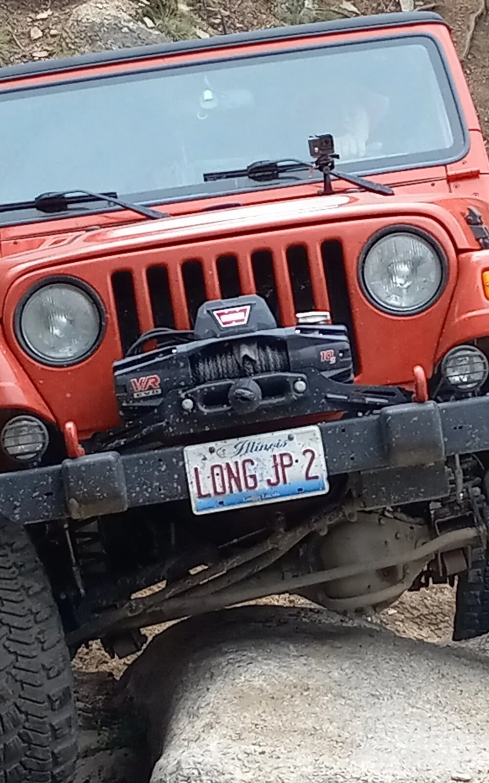

@LONGJP2 bet you didn't have to grind those did you?
