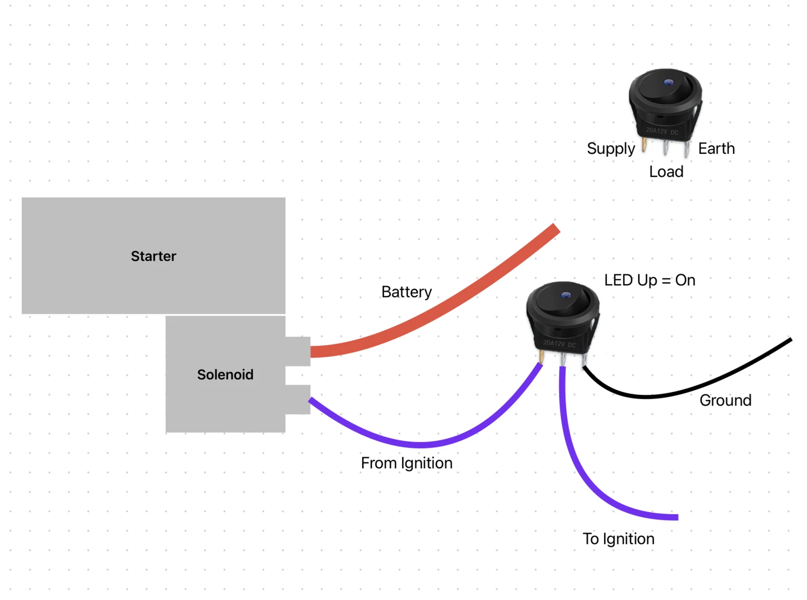

Hello, I was working on a custom kill switch. I have a 3 prong switch and it's the only one that will fit in the specific location and orientation that I need, otherwise i'd just use a two prong switch. I was planning on connecting the switch directly to the starter under the Jeep. There are two wires coming out of the solenoid, a thick red (I assume goes to the battery) and a thinner dark wire (I assume goes to the ignition). Can I just connect the switch to the wire going to the ignition? I made a diagram and attached. Seems like it would work. Let me know. Thanks!
Connecting the kill switch to the thin dark wire coming out of the solenoid, which is most likely the wire going to the ignition, should interrupt the electrical signal to the starter when the switch is turned off. However, keep in mind that this switch will only affect the starter operation and may not completely disable all electrical systems in your Jeep.
If you are looking to install a more comprehensive kill switch that disables all electrical systems, including things like fuel pumps and ignition as well, you may want to consider consulting a professional or referring to a wiring diagram specific to your Jeep TJ model. This will ensure that all necessary circuits are interrupted when the switch is turned off.
Good luck with your project!
Thanks for the response Chris.
Keep in mind that a starter interrupt switch won't prevent a manual transmission vehicle from being push started. You would need to interrupt other circuits as Chris posted.
