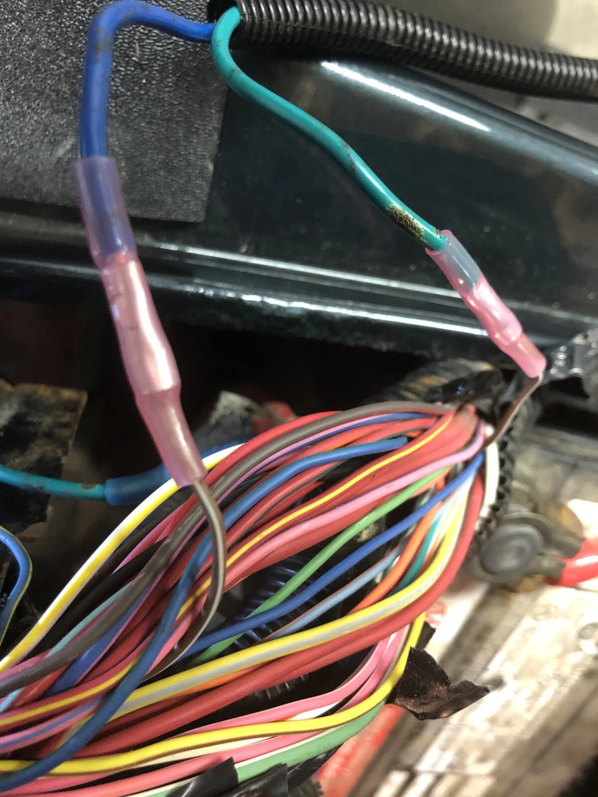

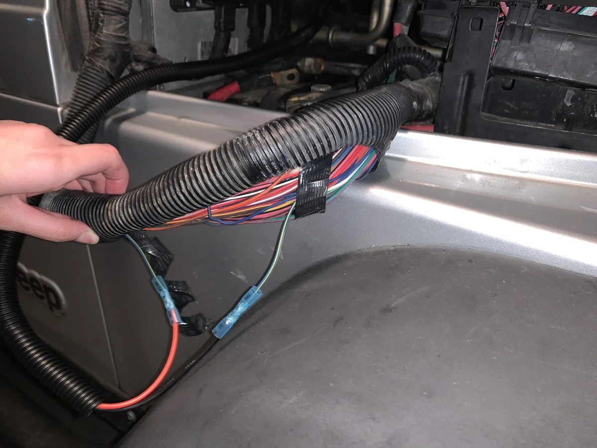

Old thread I know but I wanted to post this in case there was another jeeper out there looking for guidance like me. I just did this. This wire bundle is located next to the battery. That blue with yellow traced wire runs inside it. Here is a picture.
I HIGHLY SUGGEST for the wire to be spliced just a bit higher than where I did it. Once you try to put all tubing, etc back in place, it is too tight right next to the battery. Mine is super tight and I messed up by connecting my Orange wire through the “outside”. It works fine therefore I don’t want to mess with it.

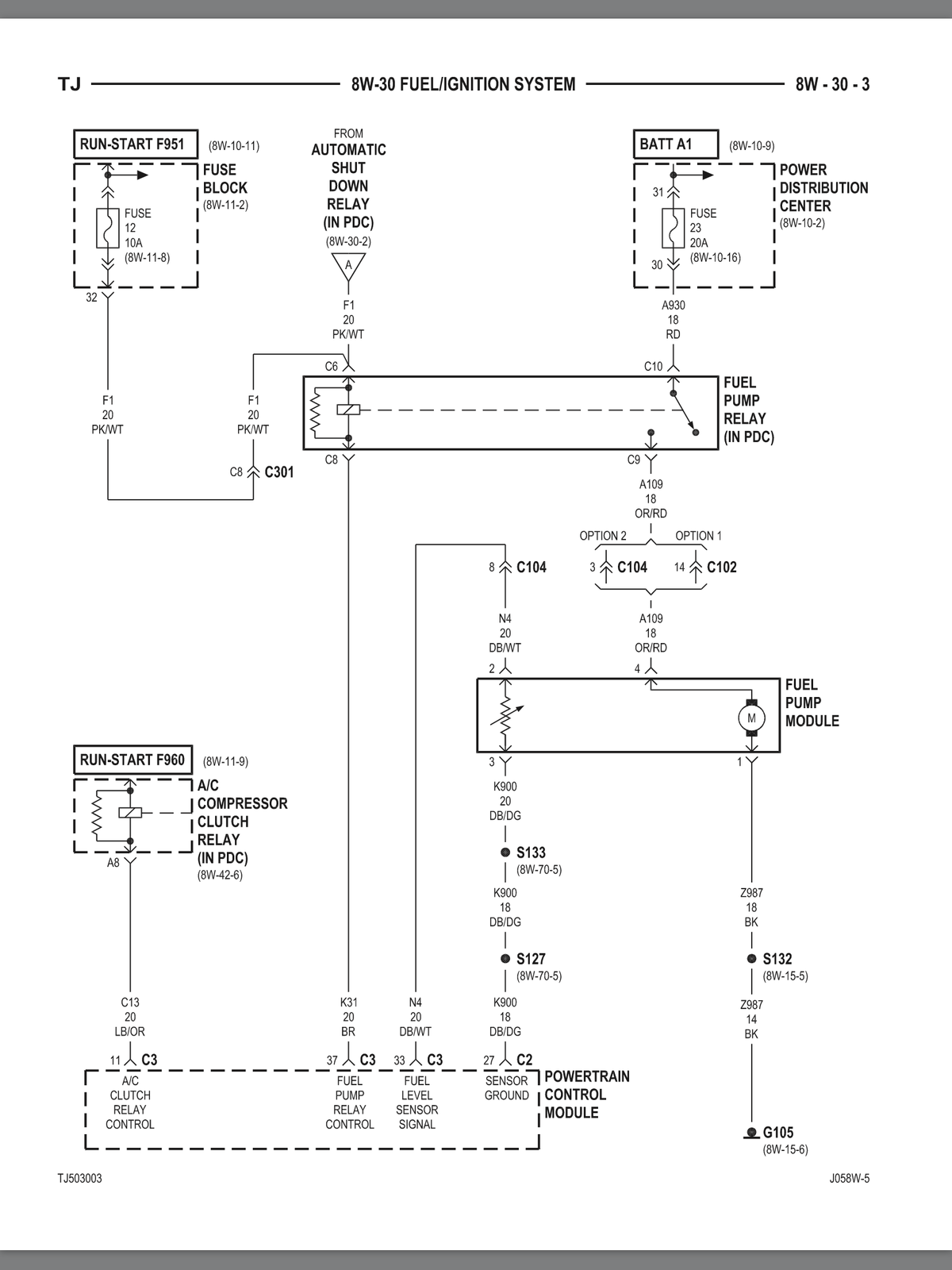

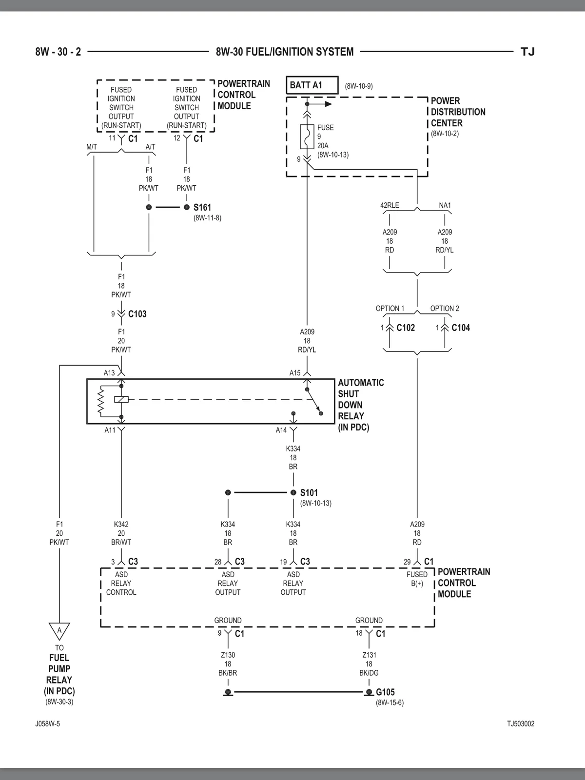

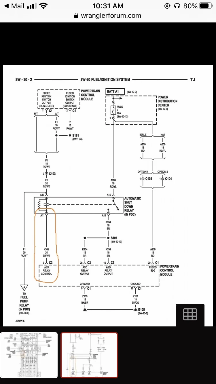

Thats what I needed, thanks @dbbd1 . It was the Brown/white wire on mine.
My fault for not doing my own research before I started. I saw the thread, found the same color blue/yellow going to what turns out to be the A/C relay right next to the ASD and went for it. The Brown/White wire was the fix for my 06.
