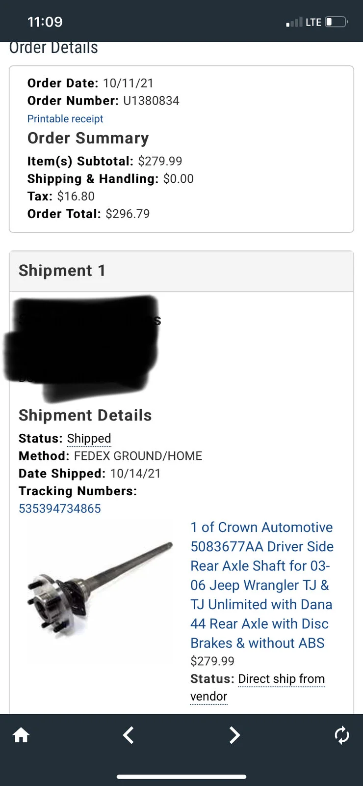

Since this is a Crown replacement, everything else being good, I'd suspect the Crown seal. These don't have a good history. FWIW, Spicer is generally preferred.

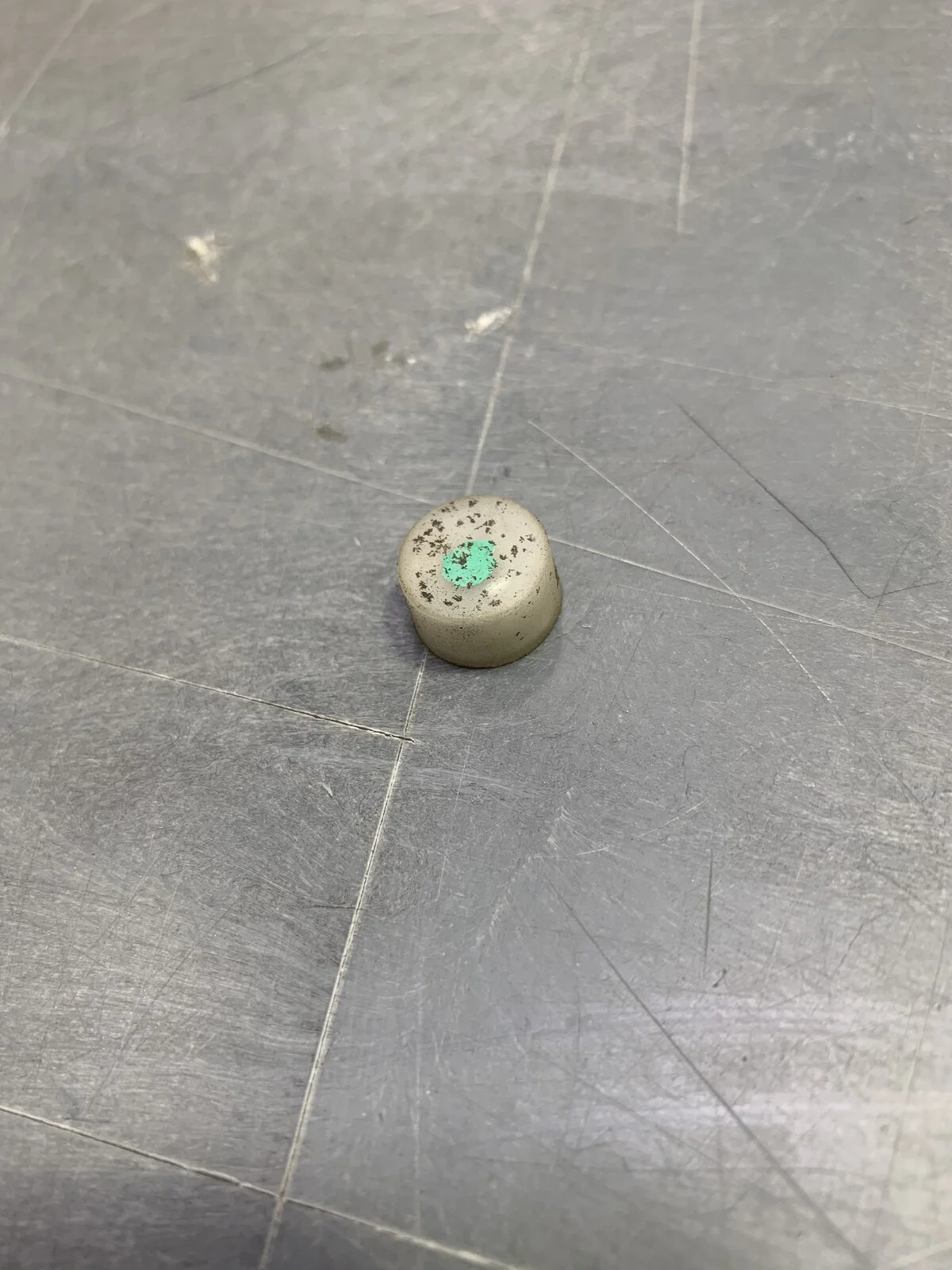

Not only did I check the vent, but I pulled off the cap on it…not sure how it breathes with that on there…
The cap isn’t really a cap to seal it off. They usually have a small hole to let air move in and out. Sometimes the end of the cap will actually have a little movement to it.
Just did some more reading, and I’m thinking your right. National or spicer seems to be the the right move.
The sucky part is you now have to replace the bearing, to replace the seal! :( Timken here!

The cap isn’t really a cap to seal it off. They usually have a small hole to let air move in and out. Sometimes the end of the cap will actually have a little The cap isn’t really a cap to seal it off. They usually have a small hole to let air move in and out. Sometimes the end of the cap will actually have a little movement to it.
Could those small holes, I’m assuming on the side, just below the cap be plugged? The cap was on there pretty tight, my next move is to drive it awhile with the cap off to see if those small holes being clogged are the culprit…
They could be. What I’ve done in the past to check is pull the hose from the hacks housing and blow through it. If you can move air through it, it’s not clogged. If there is resistence and air won’t flow, it’s clogged.
