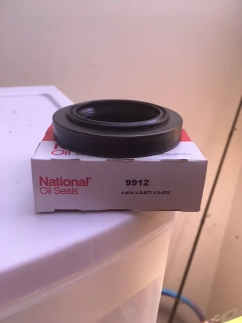

Jerry and all, just for some observational input. I have a TJ Rubi with about 308k and have been suffering from this seal issue as well. I had to have the rear dif carrier bearings replaced at around 250k and replaced the original wheel bearings at the same time just because they were old. They were not leaking but one of the carrier bearings were sounding bad so I figured there would be trash in the gear oil because of that. I used Timken bearings and seals and they started leaking shortly after the install. I bought a new set of axles, bearings, seals and retainer plates just to make the change out quick and easy. I again utilized Timken Bearings and seals and they are leaking again. I had purchased another set of bearings and seals but have been putting things off until I can better determine the cause of the seal failure. I also used permatex gear oil silicone on the last install as a precaution. I have read here that the National seals seem to perform better so I bought a set just to compare. The National seals utilize a unique two piece design in the metal ring that compresses slightly to expand the rubber seal on the outside of the seal when the retainer plate is tightened. The inner seal design that seals the rotating axle also looks like a better design than the Timken. The original seals went for around 275k miles so there must be something different with the Timken that is inferior. I would sure like to see a set of original seals just to see to OEM design. I beleive they were Spicer but not sure. I would like to have one of them to compare. The Timken seals and packaging I have look legit, but the seals themselves are manufactured in Indonesia. The Nationals are Mexico so I guess that's just where we are with everything today. I'm going to install a new set of Timken bearings with the National seals and keep my fingers crossed. I am pretty confident the superior design of the National seal will cure the issue. I'll update in a few weeks after i get them changed.

Timken makes Timken...maybe. There may be two or three companies that use the Indonesian manufacturer and Timken is one of them. I just can clearly see that the one sold under the National brand is clearly different and is a better design...and I among many others are having problems with the Timkens being sold. The Timken 9912S seals that I have wern't bought through Amazon so if they are counterfit it must be a widespresd thing.

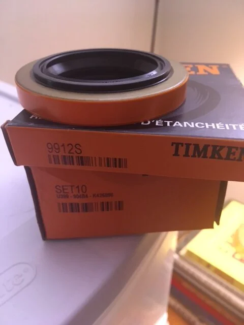

Nope ...they are just Orange with no rubber on the outer rim of the seal. In what says is a printed in the USA Timken 9912S box that states they are made in Taiwan and the seal itself has Indonesia molded in the rubber. May be counterfeit junk or just Timken going on the cheap but the bottom line is what I have are trash....and they clearly say 9912S. From a local independent parts house.

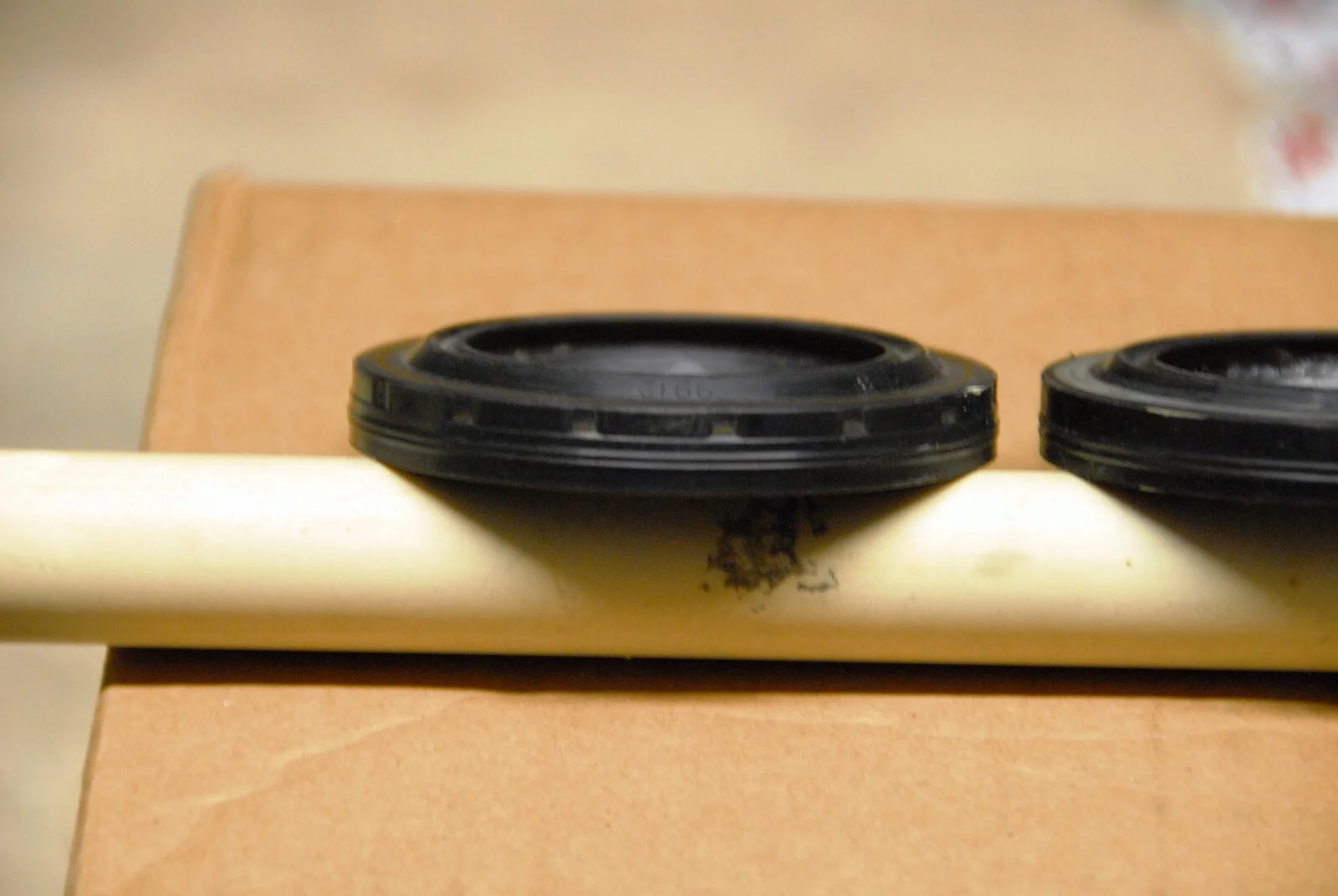

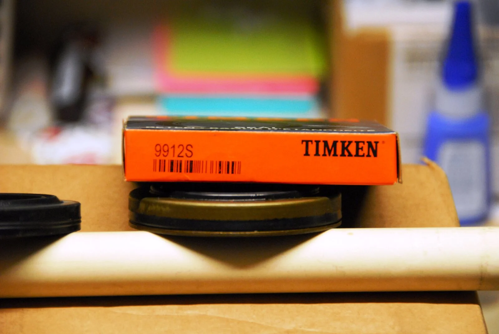

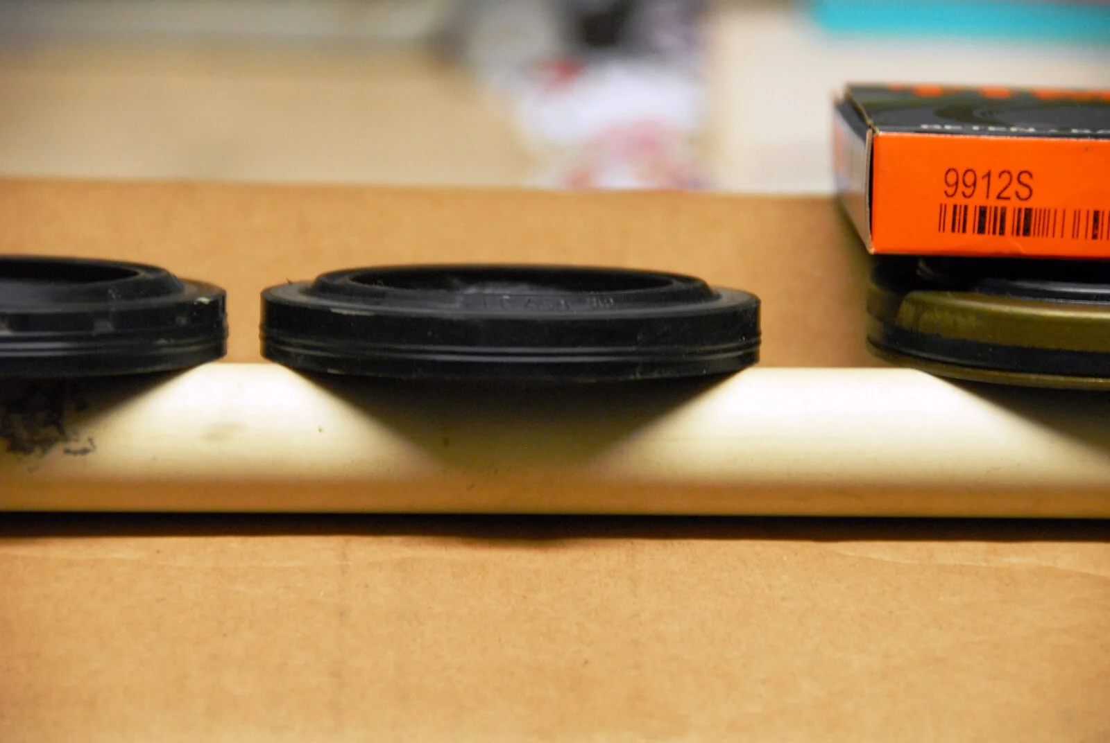

Not sure who is fucking who but those are not 9912S seals.
Timken 9912S box and seal.
CR out of a Spicer box.
Yukon 9912

Either someone at Timken screwed up and put the wrong seals in the box or the vendor is messing about. I've used dozens and dozens of the Timken 9912S with the expandable skirt purely because of that design. The other style with the ribs around the perimeter is far too easy to nick on the way into the housing end which will leak.
The seal with the orange lip will never seal in a housing end, that is simply not how that style works. That is a drive in seal for something like a pinion, or output shaft on a t-case.

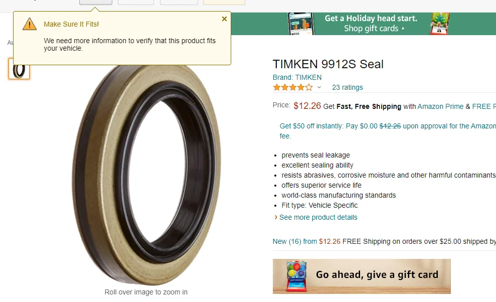

Where do you get your 9912S from? RockAuto? Seems like Amazon is the only place shipping the false one, and that you get a legit one that works from other places.
