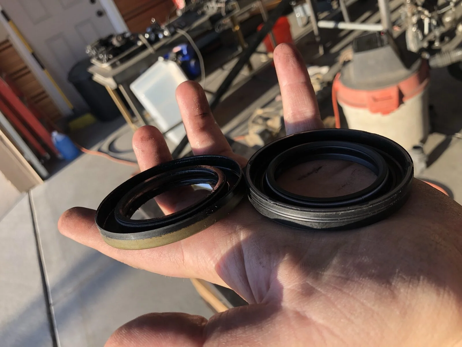

My .02¢. if you buy on amazon you get screwed. I had a buddy buy brand new Timken 9912S on Amazon and the were some knock off BS that leaked right away. I happened to have a spare set of seals and bearings and the seals were way different than Amazon. The true Timken seal should have two ridges around the circumference. I'm hoping that @rasband can post some pics of the difference. The TRUE Timken seals feel beefier and heavy duty vs. Amazon crap.
This was so frustrating (also thank you!), here’s a side by side. The left is the garbage from Amazon, the right is from the BFH garage (I think he used summit for that order). I’m mostly moving on from Amazon, shipping speed be damned.
Mine was missing ridges you can see in the right and it was substantially lighter.
Reactions: Tob
