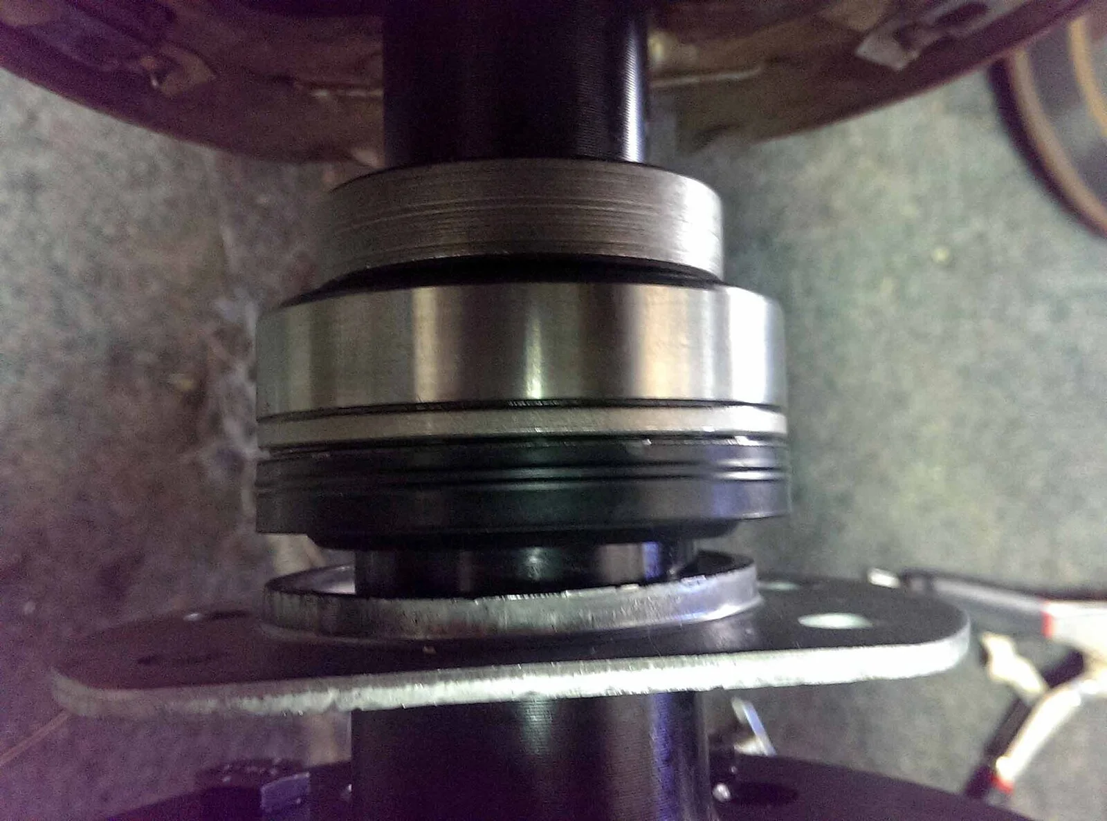

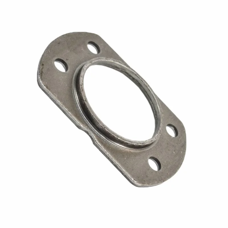

What does your axle retainer bracket look like, which one of the below do you have? Assuming you have rear disk brakes, do you have the bottom style bracket? If you do, is its lip facing inward toward the seal like in the bottom photo?

The Dana 44 shafts for both disc and drum brake options use the same seal, shaft collar, inner race, and bearing. The only parts that are different between them are the 4 bolt retainer which has a lip on it instead of being flat like the drum brake version to compensate for the thicker cast disc backing plate and then the other part is the wheel studs are not the same.
