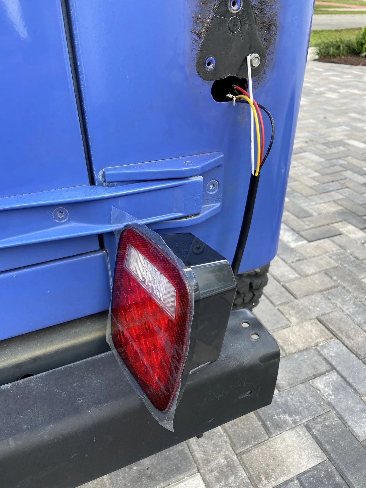

LED backup lights
Looks like a trailer wiring harness.

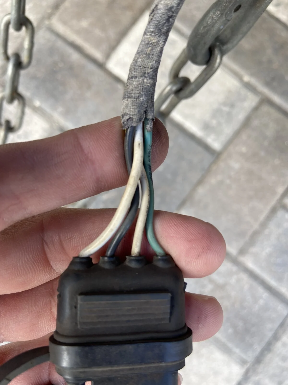

I do have a hitch for a trailer. The cables are different colors as well though. See attached.
Alright lights work with brakes, turn signals and when I turn them on the headlights. The reverse LED not coming on though on both sides. Any ideas??
Try reversing the polarity on the led bulb
Just becasue there is a red and a black wire on the harness, doesn't mean tht they are connected correctly inside the fixture housing at the PCBA.
Use a meter to confirm the voltage/polarity at the harness on the Jeep. Then connect the light straight to a power source such as the battery to confirm operation THEN match the wiring for the light to the harness at the Jeep based upon function, not wire color.

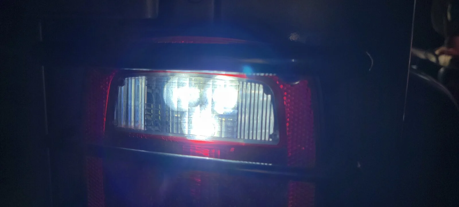

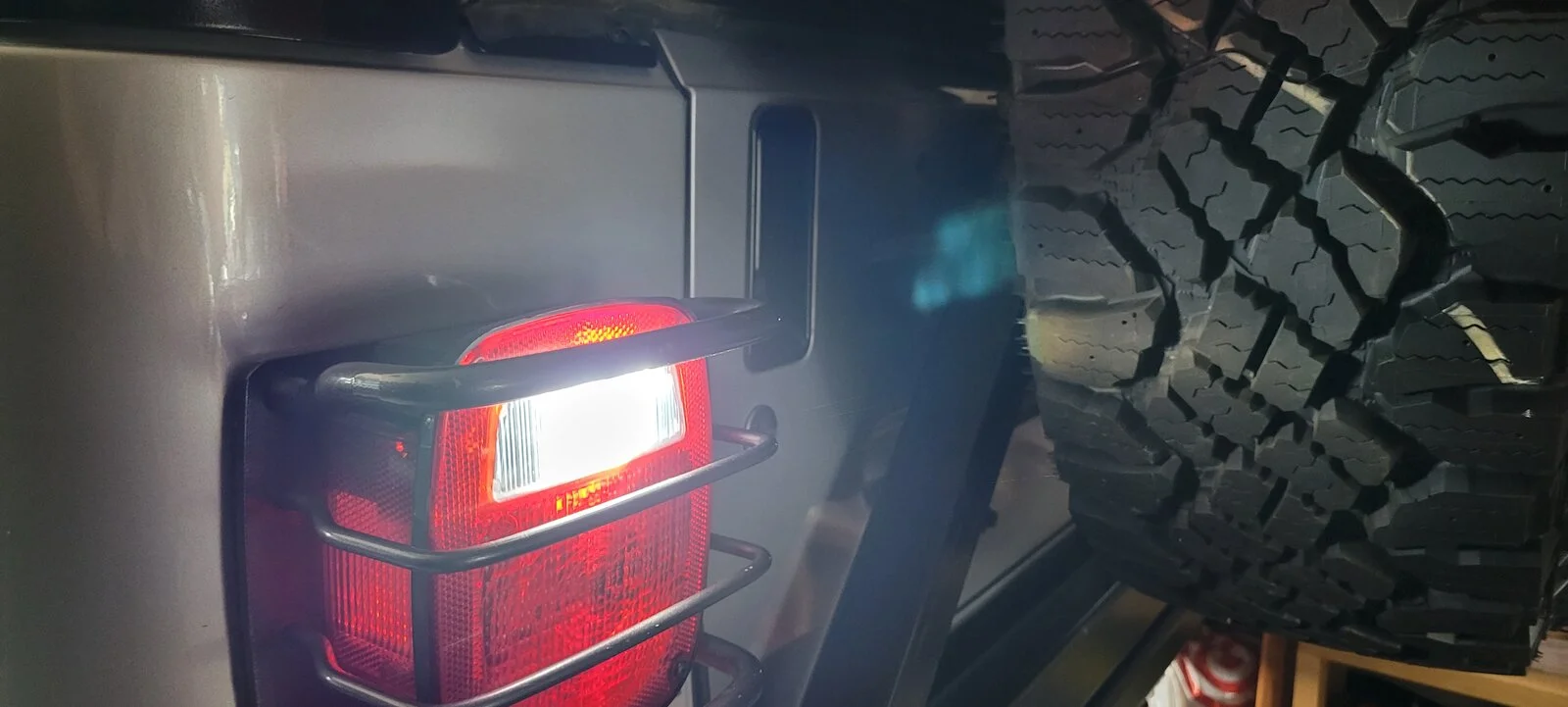

Installed today. AWESOME, AWESOME, AWESOME!!! Bright (I'd hate to be standing behind when I pop it into reverse) and an easy process. Thanks Claytone!!!

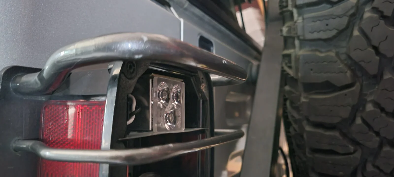

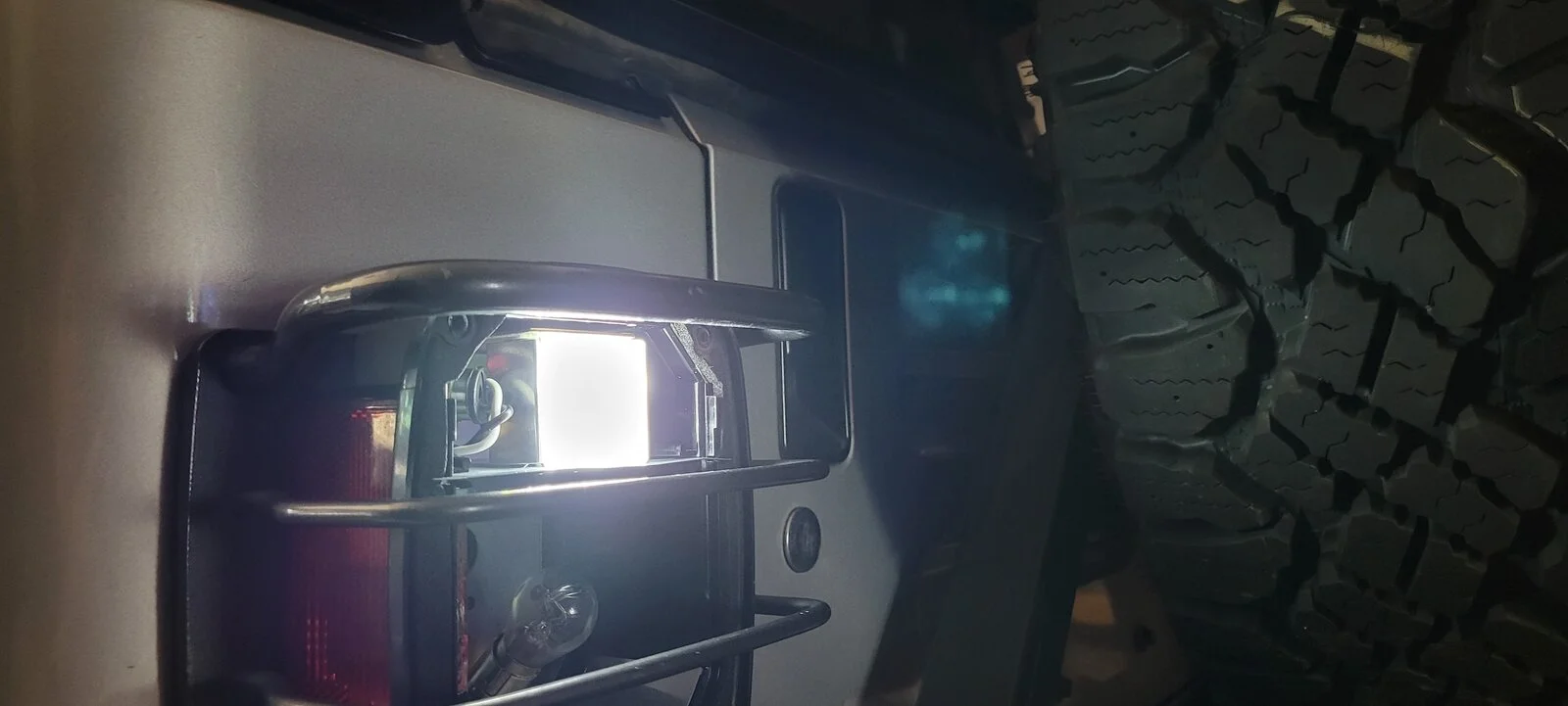

Installed them today too! Great lights! I decided to put them a little off center and pushed back slighlty to clear the connector in the back. A 1/8 drill bit works really well. Including the nail was a nice touch. Thanks!
