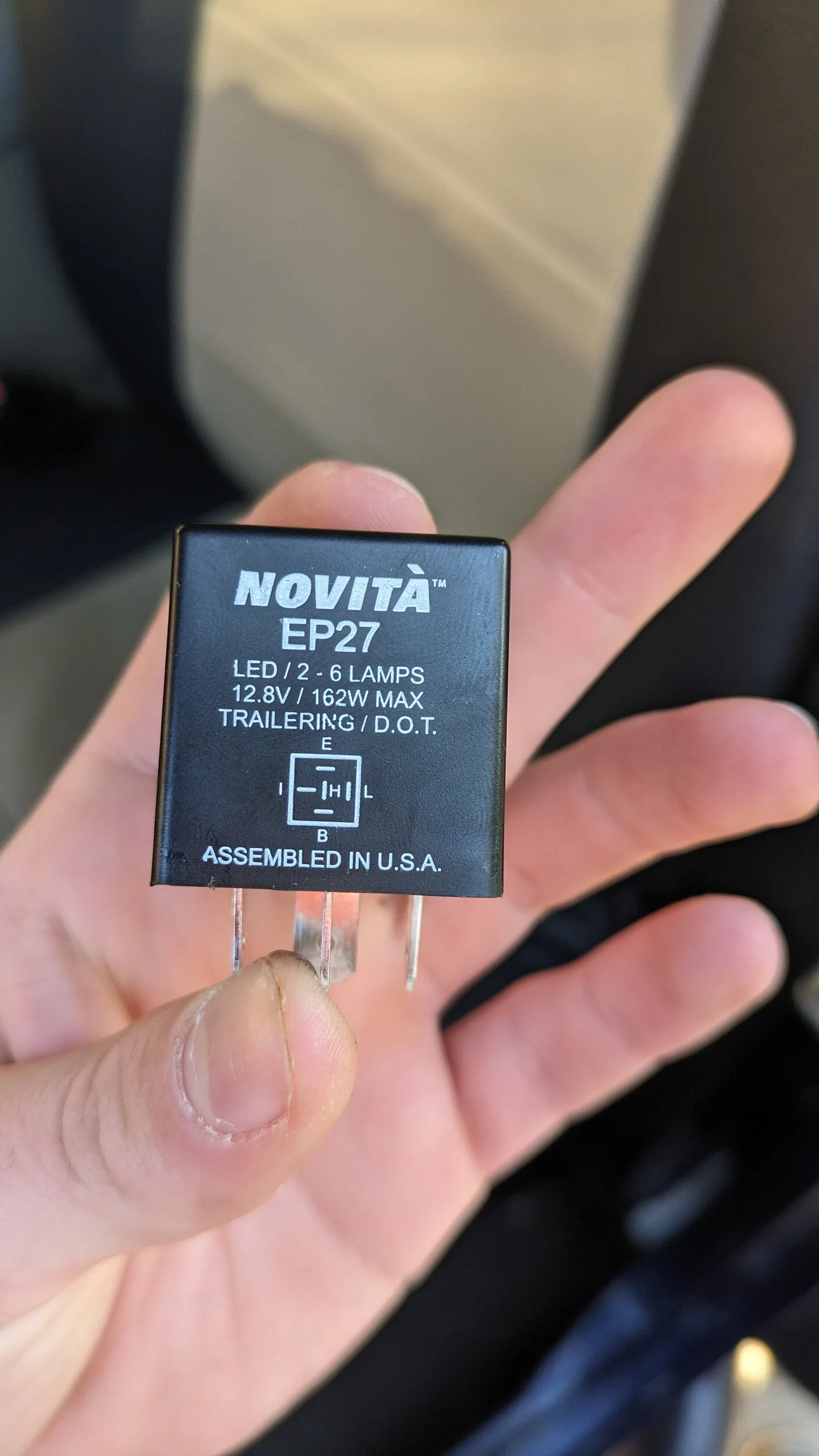

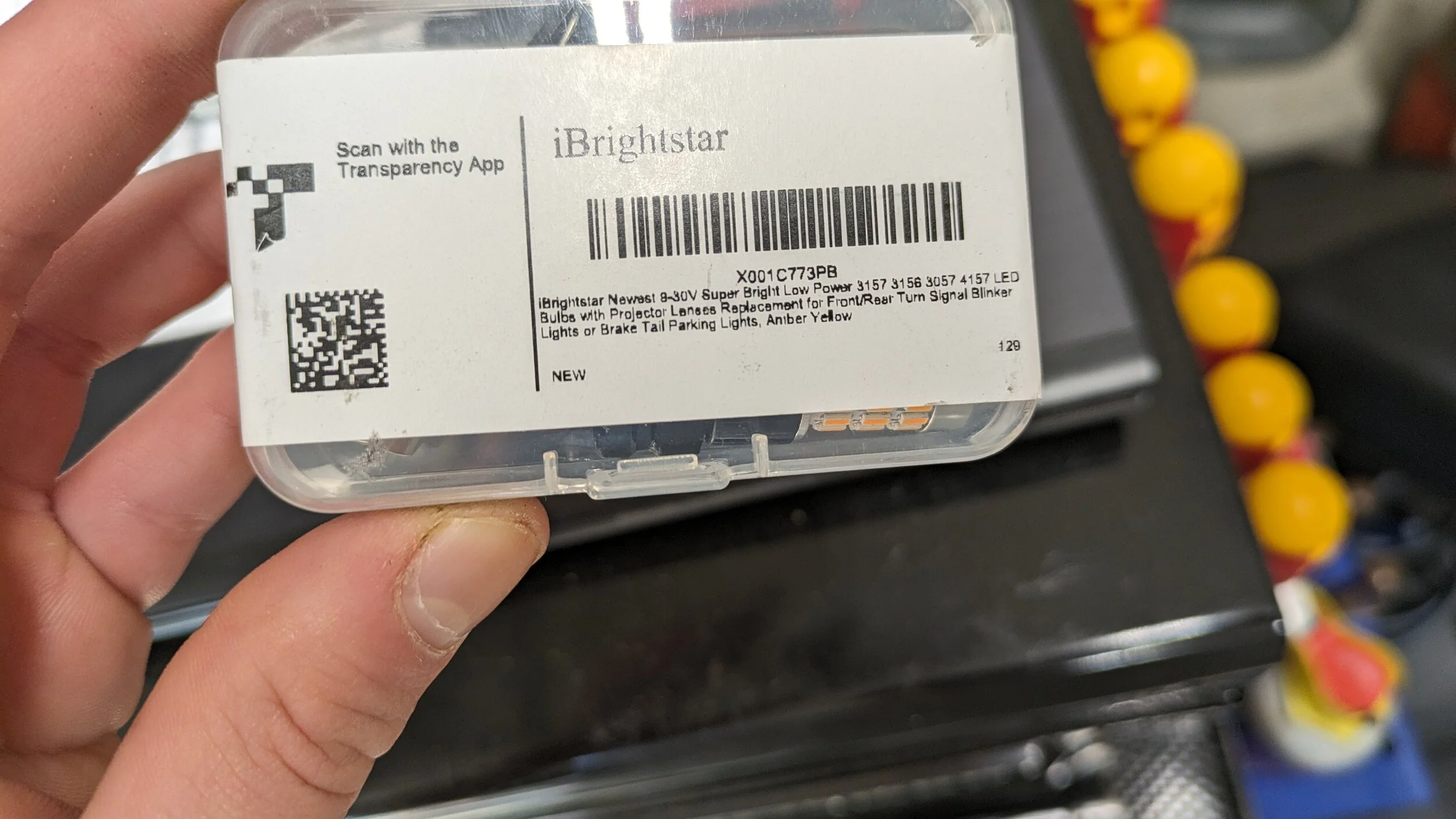

Alright, first off I got my spring spacers in and she's raised 2 inches!
I then tried to change the 2 front turn signals to LEDs, the only other leds on the car are the reverse lights. I tried a Novita ep-27 flasher, cause that's what I thought I needed. Apparently I did not do enough research cause the turn signals worked fine, but the hazards made my relay freak out. when i turned on the parking lights only the left side lit up????? I am very confused as to what the hell is going on.
I have a 2005 sport 4.0

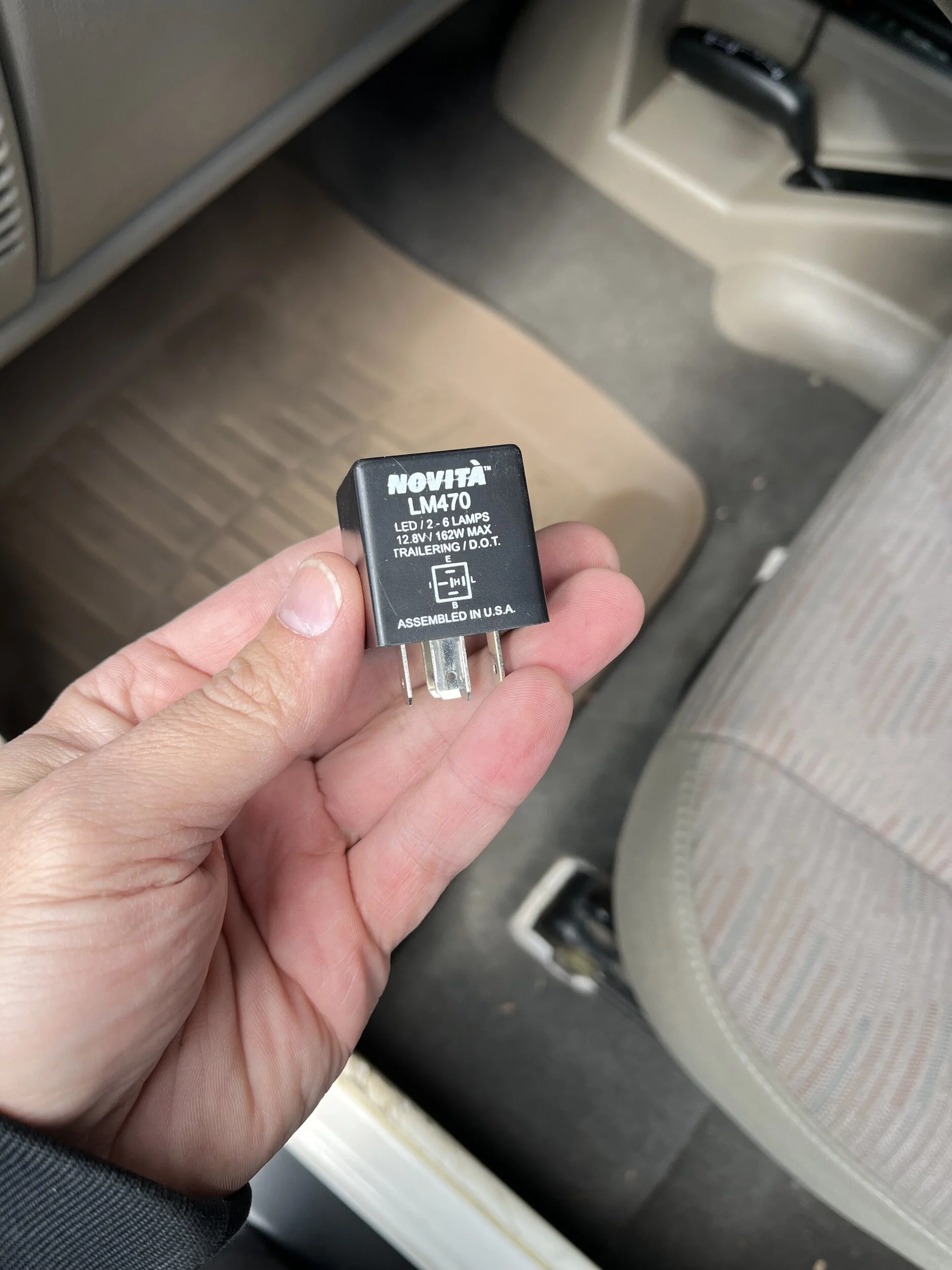

Cheaper ones typically don’t play well with a combination of LEDs and incandescents. This is the one I used for my Savvy tail lights and it works fine, but pricey at $35.
I think what you need is an EP-26, not an EP-27. That's what @Chris has. 97-00 and 01-06 also use different relays.
https://wranglertjforum.com/threads/question-about-led-turn-signal-lights.1216/ See post #11
