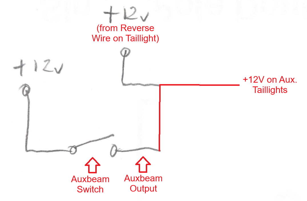

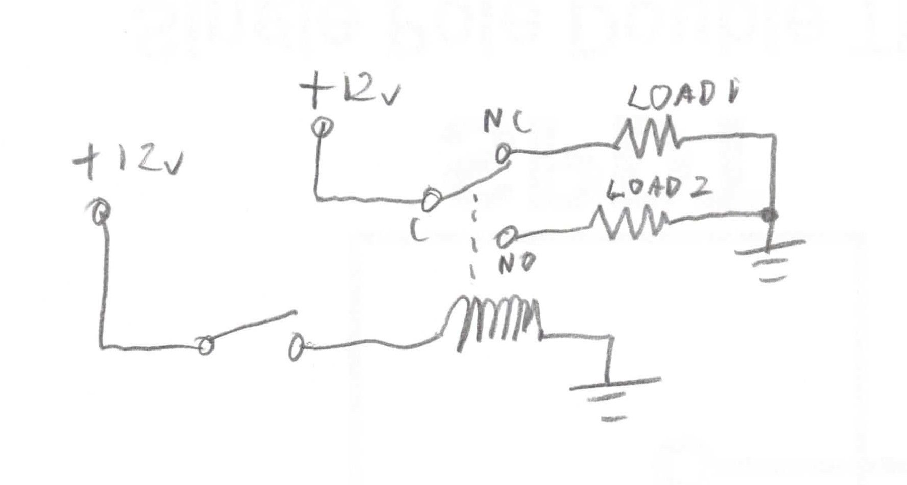

You have my attention. I appreciate your confidence level. Any chance you can help locate a diagram I can use to follow along?Easy enough. Use a SPDT relay activated by the SPST switch. When the switch is OFF, the relay is in one position, when the switch is ON, the relay will be in the other.
