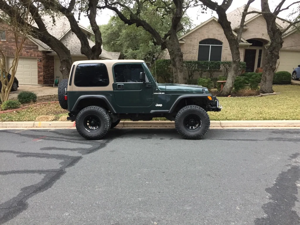

OK so my build list is complete. I made some tweaks from original list.
Remaining parts are being ordered and I should have this done within the next few weeks.

Here we go!
