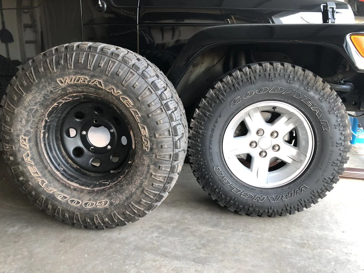

Well I think the 5000X will be the ones. So just got a message from buddy for the Duratracs basically he dropped price by $100 wants them gone.. basically the set of 4 for ~$370 on the 5x5.5 ford rims..

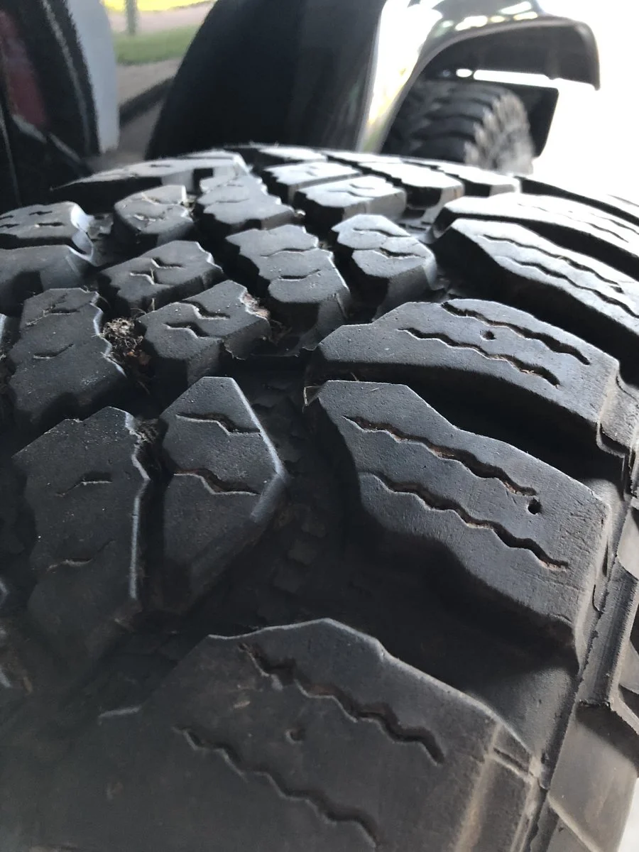

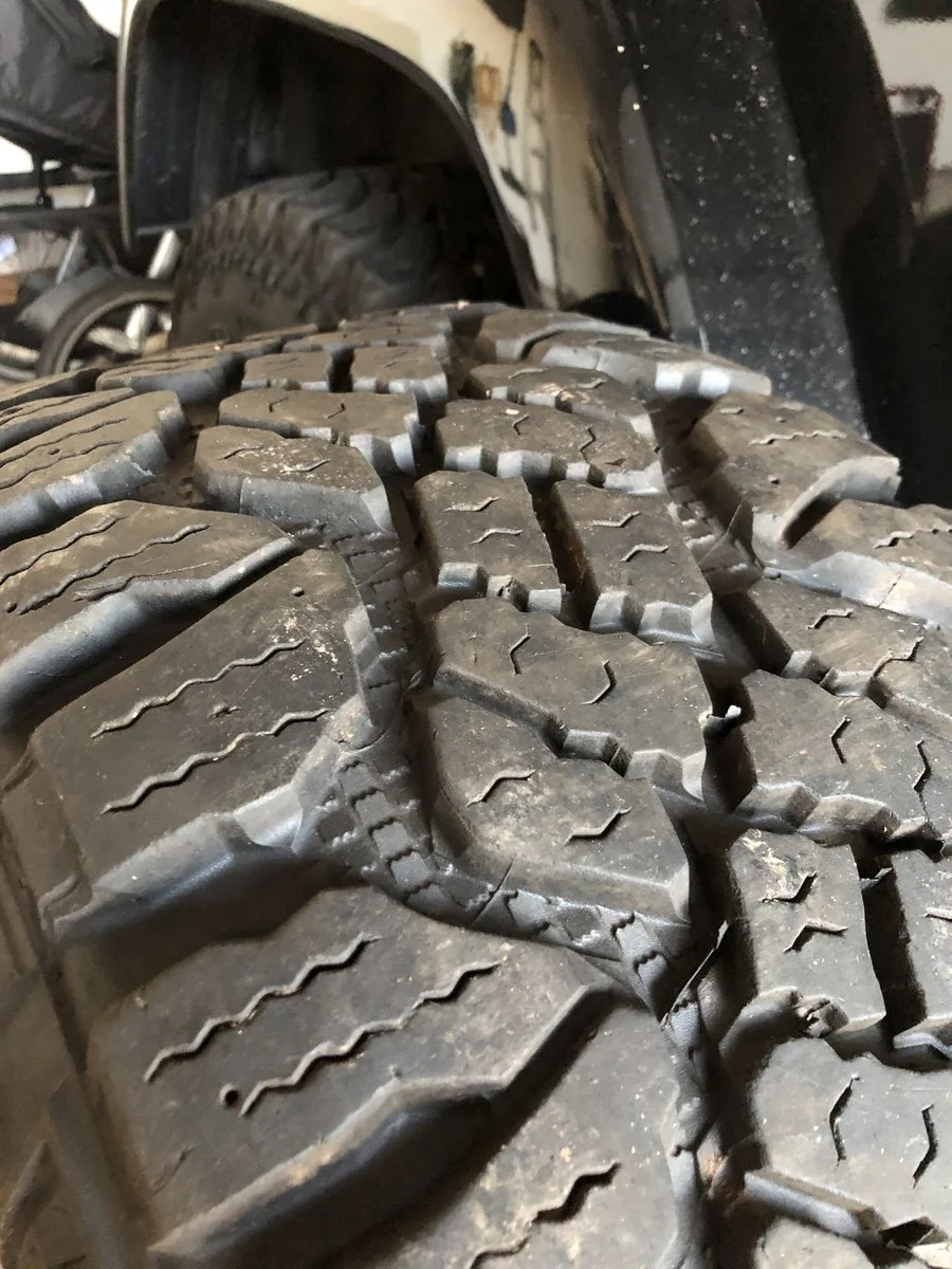

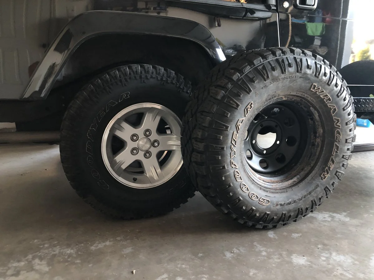

Thanks for the feedback. So this happened earlier today.. got them for $350. The rims of course don’t fit but I plan on pawning those off. Tread measures consistently 14/32s. Not in those pictures but they clean up well too. Now I gotta get on that lift kit.
