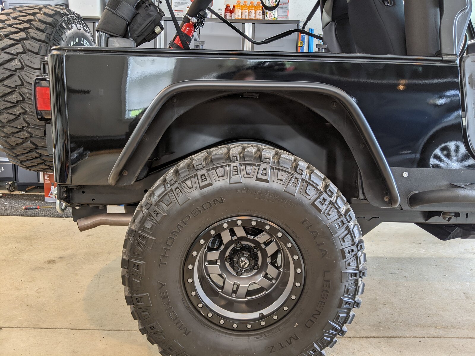

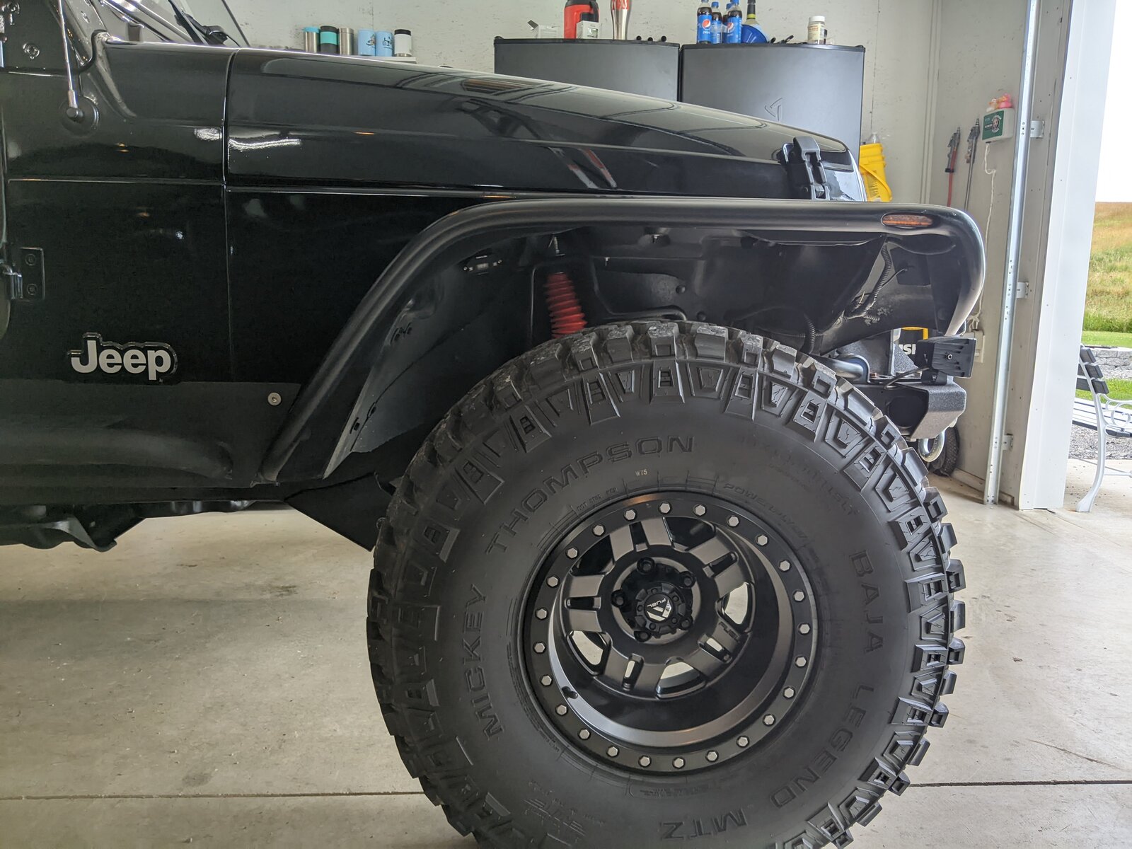

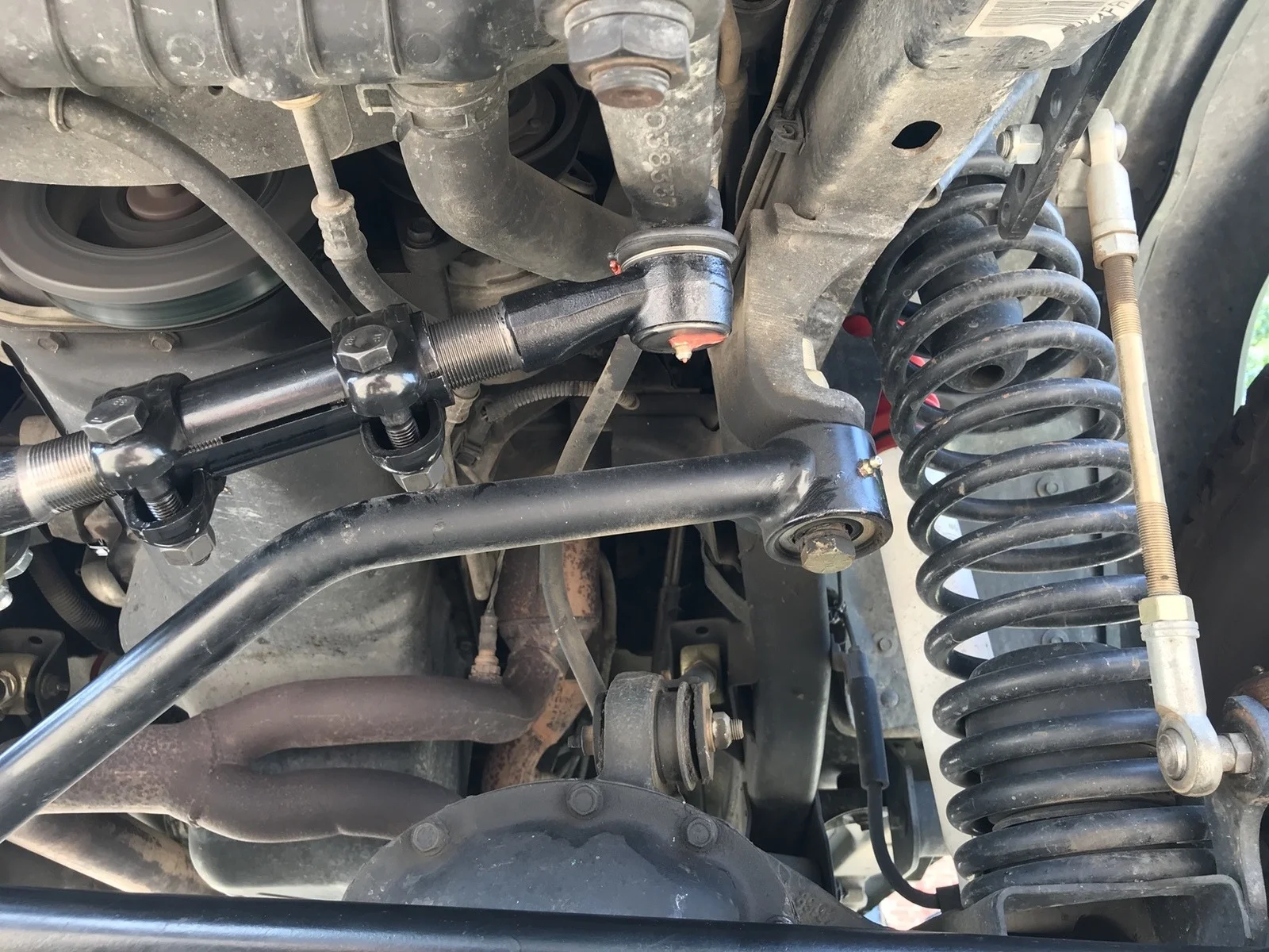

I have an '05 LJ currently with a 3" lift. The off-road shop I took it to talked me into 35's and adjustable control arms (said it would be fine for what I do). The tires slightly rub the rear inner fenders on the off roading that I do. I'd like to go to a 4" lift to eliminate the little rubbing that occurs. I already have a 1" tcase drop.
Can I run 4" springs and shocks without changing to a SYE and new drive shaft?
If I need a SYE and driveshaft, can I eliminate the tcase drop by just removing the spacers?
Are there any other items I'd have to change along with the 4" springs?
Pictures added to show tcase drop and current ride height at 3" lift.

Dumb off-road shop. Don't go back there. They could just be trying to upswell you. Get you to come back when you realize it’s not enough lift and tell you all the stuff you need.
Here are your options.
Option 1:
You could add a 1.25" body lift and get some more clearance for your 35's. You may clear. You can clear for sure if you add more bumpstop.
Option 2:
4" lift you will definitely need an SYE, DC and rear control arms to adjust the pinion.
If you did this you could remove the TCase drop.
Going to 35's is no joke. If you ask me if there is more to do, my answer is I don't know because I don't know you're entire setup. My guess is "yes" because very few are ready to go straight to 35's from 33's. Think brakes, steering, adjustable rear trackbar, front driveshaft, et. al.
You will for sure need adjustable everything especially to keep your axle’s centered and pinion adjustment I’m running a 4 inch suspension lift and 1 1/4 body lift but I still have stock driveshaft (Tom wood dc on order) but haven’t run into any problems

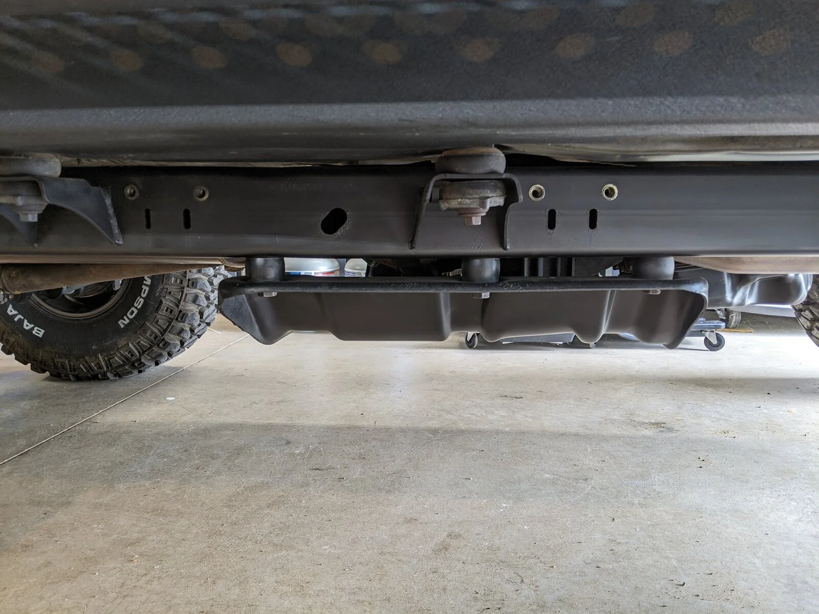

The shop added adjustable control arms with the tires, but didn't adjust the rear correctly. While cleaning the Jeep after a Jeep festival, I noticed the rear differential was rubbing the gas tank skid while off road. I watched videos and read through the forum and adjusted everything to be centered at full stuff. I adjusted the pinion angle to match the 5⁰ from the transfer case. While I did that, I changed to 5 inch bump stops. A regear has been done (5.13 with the automatic), as well as a powerstop brake upgrade. I plan to go to the heavy duty Rubicon Express Y steering upgrade. I'll also go to chromoly axles at some point too. If like to stay away from a body lift if possible. It barely rubbed with 3" of lift, I was hoping to get away with adding another inch to the springs. I'm not opposed to a SYE and drive shafts if needed (they are the only things on the Jeep with any sort of rust).
5 inch bump stops may be extreme most on this forum say you need at least 4inches of up travel. A 1 1/4 body lift is really the way to go to solve your problem. It’s incredibly easy to install
Lots of backward things in here. Save some money and frustration.
What’s the issue with a small body lift (1-1.25”)?
1. Body lift is the best bang for your buck mod you can do. Even if you have aesthetic objections, those can be overcome.
2. Y-steering is not an upgrade. It’s a downgrade. Stay with the Haltenberger style (TJ) system.
https://wranglertjforum.com/threads/what-is-the-best-steering-for-my-jeep-wrangler-tj.2956/
3. You shouldn’t have 5” bumpstop with 3” lift. When I was there I had full clearance with 2” bumpstops (and a 1.25” BL), so equivalent of you having 3.25”. You definitely aren’t utilizing the travel you could be.
I have about 9k in my setup to run 35s. That's just parts. I did all the wrenching myself. 4" spring lift and 1.25 body lift. And I still get some slight rubbing in places under heavy articulation. It ain't cheap to run 35's.

Another vote for installing a body lift, highest return mod you can do.
You’re lucky as an LJ owner, you can likely get away with a 4” lift with no SYE/DC if you keep those tcase drop spacers.
But if you want a tummy tuck, those spacers have to go and the mods list get bigger.

While that steering maintains the factory inverse Y geometry that you want with stock axles, is is not adjusted for a spring lift the way RockJock is where the tie rod ends are angled to put them in a neutral position while at the new ride height. Very few get this right along with several other details.
If you don't want to spend the money on RockJock, then use ZJ steering.
Reactions: Thomas-2005-LJ
You need a non-compressible 1.25" body lift like Black Magic Brakes or Savvy. Then you need the GenRight raised body mounts to get rid of half the body mount kit you just bought.
Thank you for all your input. I've been looking at all the components to go 4" springs and a body lift. If I go the SYE route, I can get rid of my tcase drop. The ideal plan is to get everything right without cutting anything. I think it's time for a parts list.
