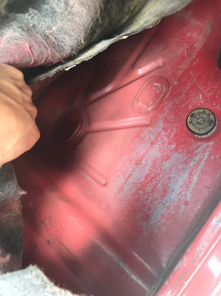

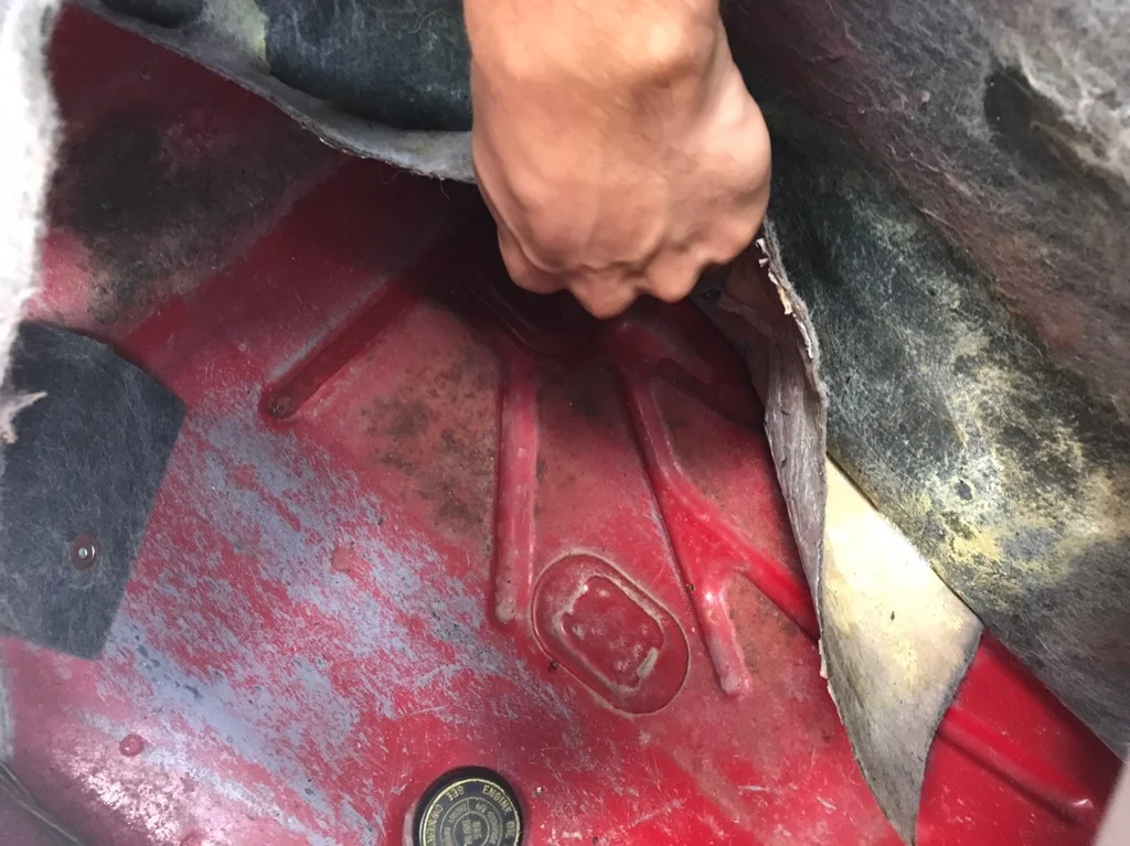

Sooo I've had the back carpet out for a while now and the original paint is in good shape and I've checked under the driver side panel for rust and never found any. However I was curious and realized I've never looked under the passenger floor board and found a huge spot of it:( It's more of a surface rust but I'm not sure what I should do, possibly sand paper and a protectant. Any thoughts? IMG]https://uploads.tapatalk-cdn.com/20180528/508ceced7d4e8d096779e5a62046c756

That’s nothing at all! Wire wheel it and paint over it. Simple as that! That is super easy to deal with!
Reactions: Nicholas
Like everyone else said wire wheel and paint. I had surface rust in the same exact spot and I used it as an excuse to bedline the interior
Reactions: Nicholas
Dont forget the in-between step of cleaning up all that rust-dust you just wire wheeled off,quick wipe of acetone and shop towel to prevent that crap getting right back to where you just removed it
Reactions: Nicholas

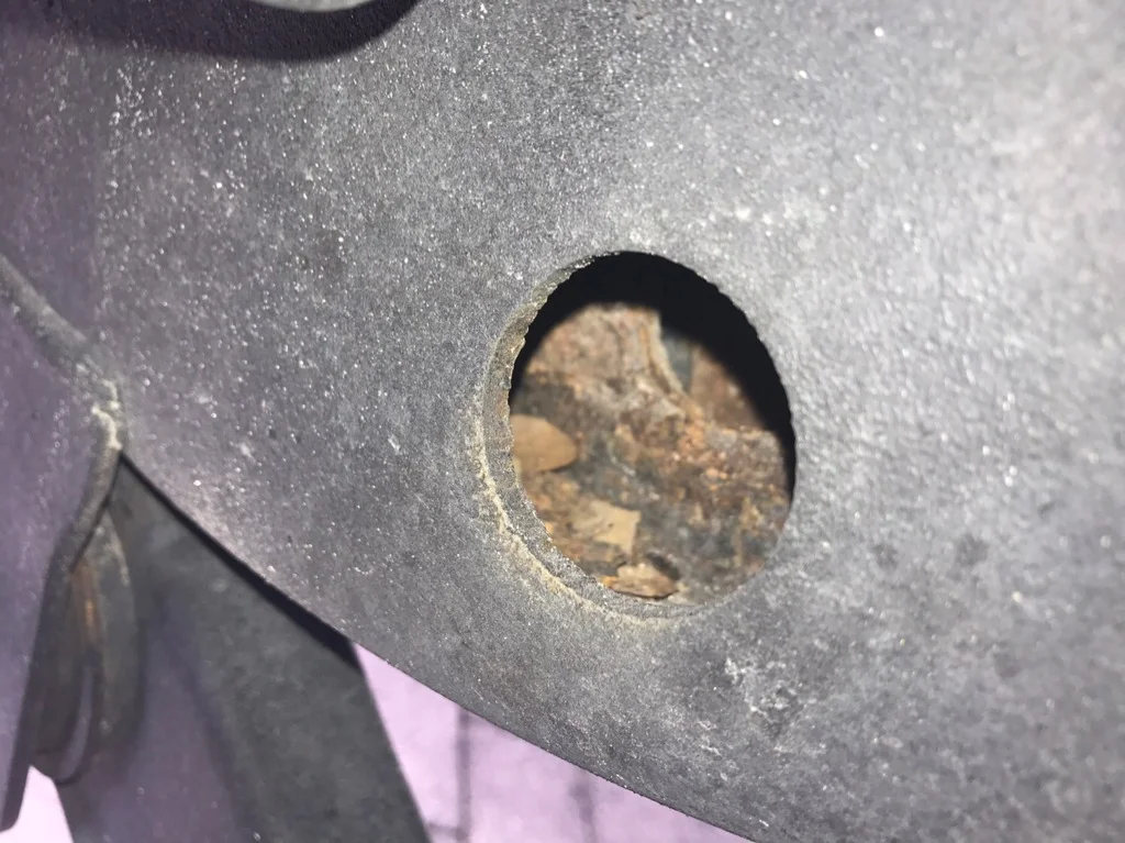

Also one more thing, anyone think this is something I should be worrying about? Since I got it the frames always had some rust inside, some thin flat chunks are visible from the outside, seem to be coming off but I'm not sure what I should do.
