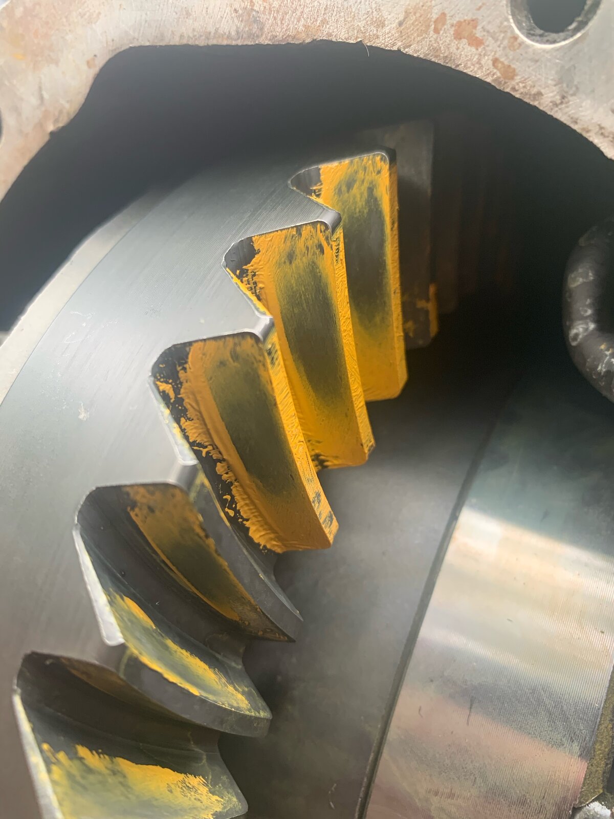

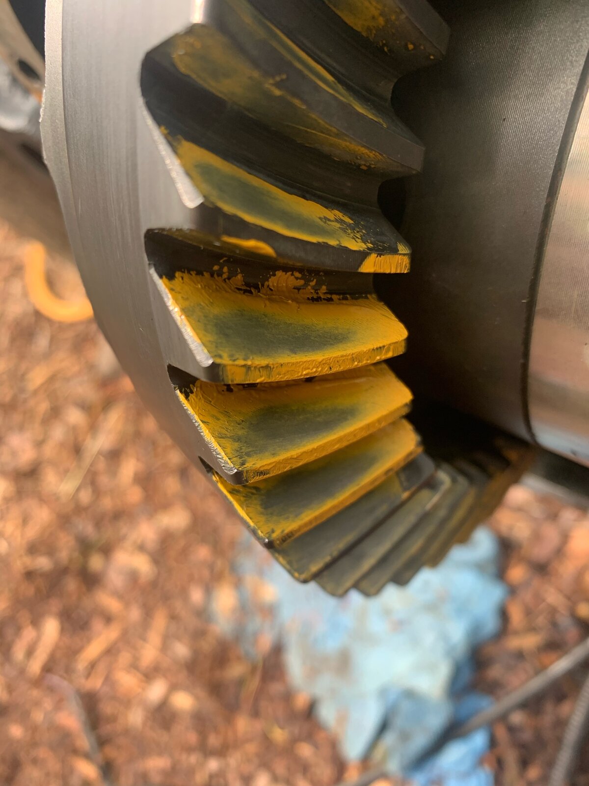

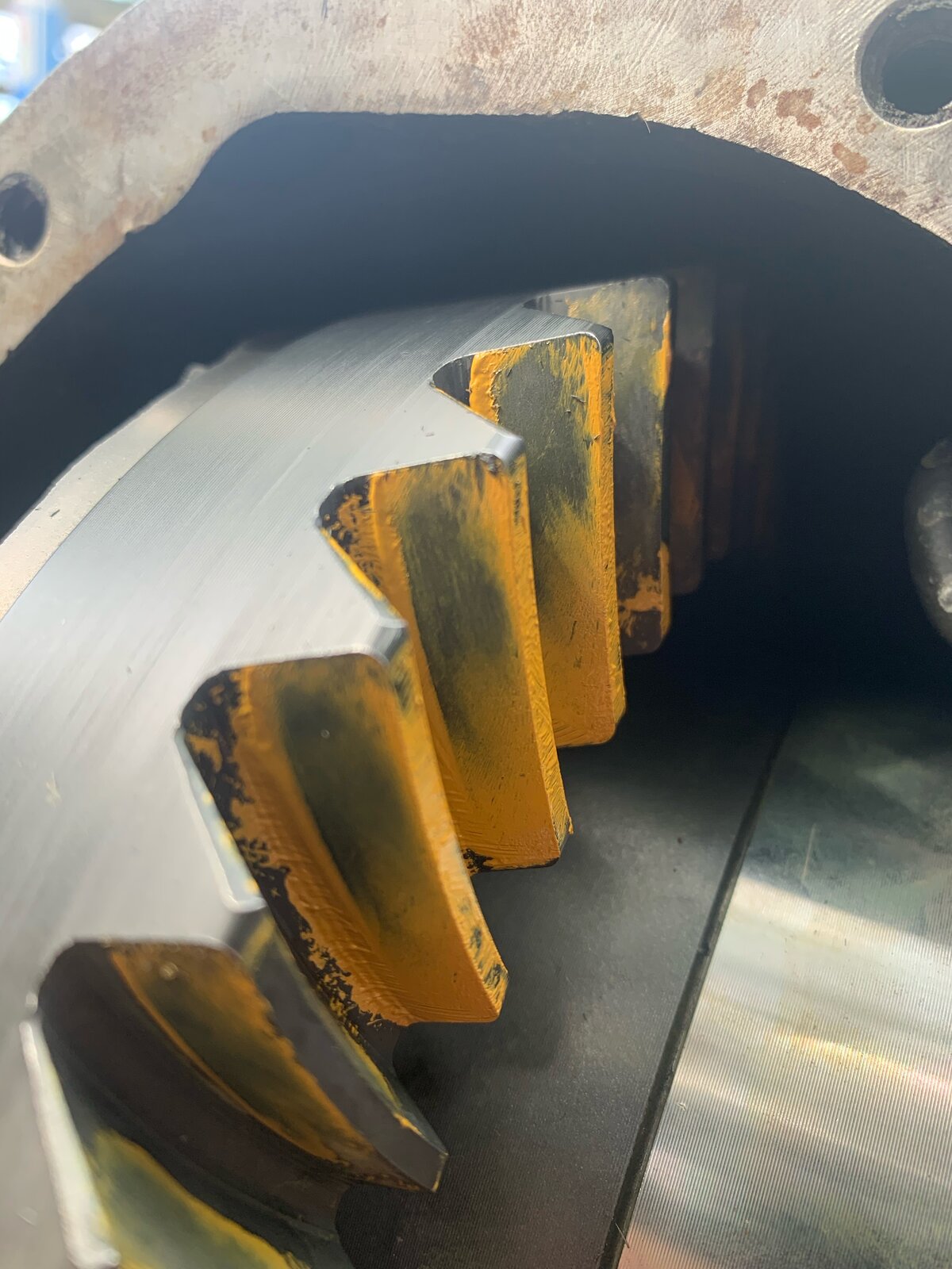

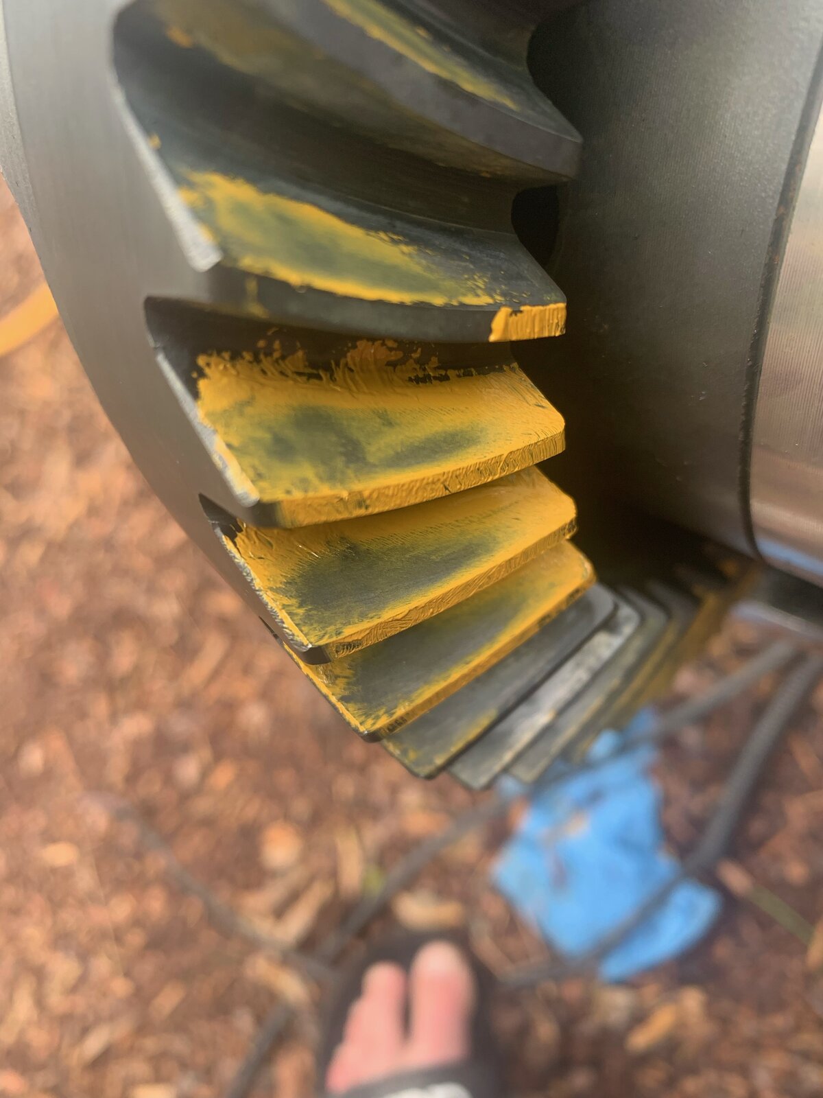

Between the first pattern and the current pattern, it looks better than what i see come out of ALOT of shops. You wont have issues with either pattern.
That is great to hear. I contacted a buddy's dad who messaged his mechanic and he said something very similar. Thinking I may bring it by the offroad shop kinda close to me so I can support local, have my front bearings pressed on, and talk with their gears guy, with the axle actually being present. Thanks for the message!
We all want our Jeeps to be perfect but the reality with gears is that the “acceptable” spectrum of patterns is “acceptable” for a reason.

Okay, I think I have a pattern that I am fully satisfied with! I added a bit to the backlash and 1 thou to the pinion depth. This is 7 thou backlash, and bearing caps fully torqued down.

I think either is good. I feel good about the second last pics I posted. I am going to finish buttoning it up and hopefully, it serves me well. I appreciate all the help. Hopefully, when I do the front end it'll only take a pic or two to get it to smack on.
