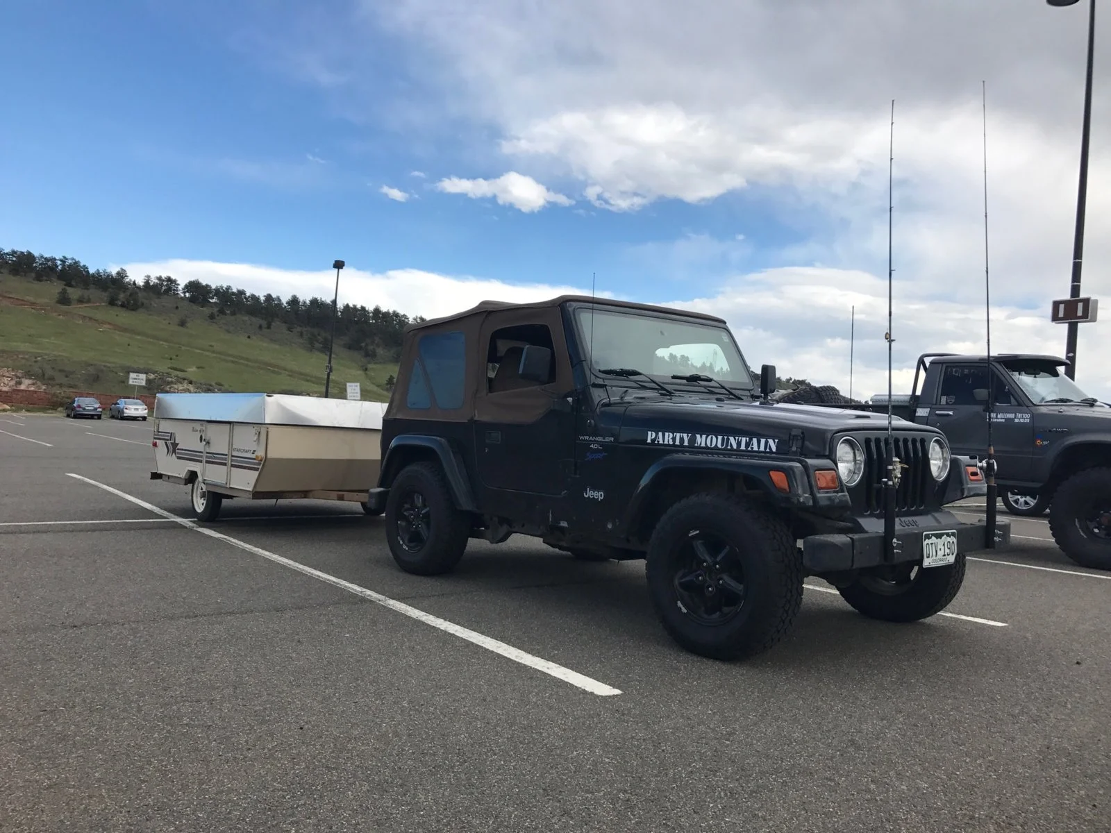

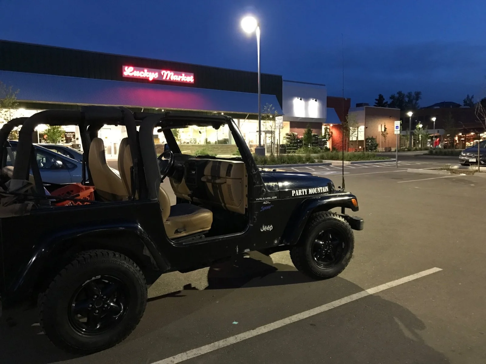

I've got a bone stock TJ Sport V6 Auto. My suspension is shot and I am looking for something new to try out. I mainly drive on the road but also get on some easy to moderate trails out here in Colorado usually twice a month. I'm not trying to go for a big lift but am hoping there is an upgrade off the stock suspension that will keep my ride around the same height. My plan is to order the parts online and have my local 4x4 shop install them. Admittedly I don't know much about picking out parts or installation so any thoughts would be greatly appreciated. Budget is around 2k
