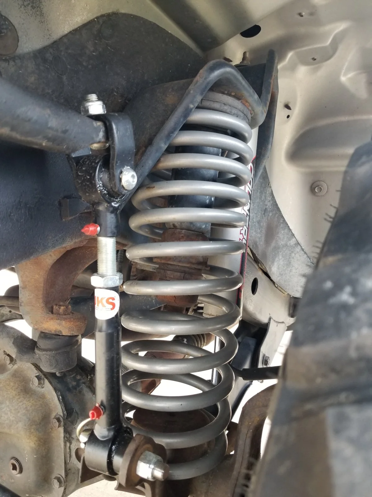

Alright I'm just making sure I do indeed have a 2.5 inch lift. It seems like I have a decent amount of clearance for 33 inch tires so making sure it's not more lift than what I thought.
Measure the springs at ride height. Factory was 12" front, 8" rear.
Well I already know that the springs are 2.5 inches from research on RC lift kits. But just making sure there isn't any spacers or anything that I'm not recognizing.
Are they actually giving your Jeep 2.5"? The actual lift height is entirely dependent on the Jeep's weight. RC can only guess what yours is.
I don't see any additional spacers.

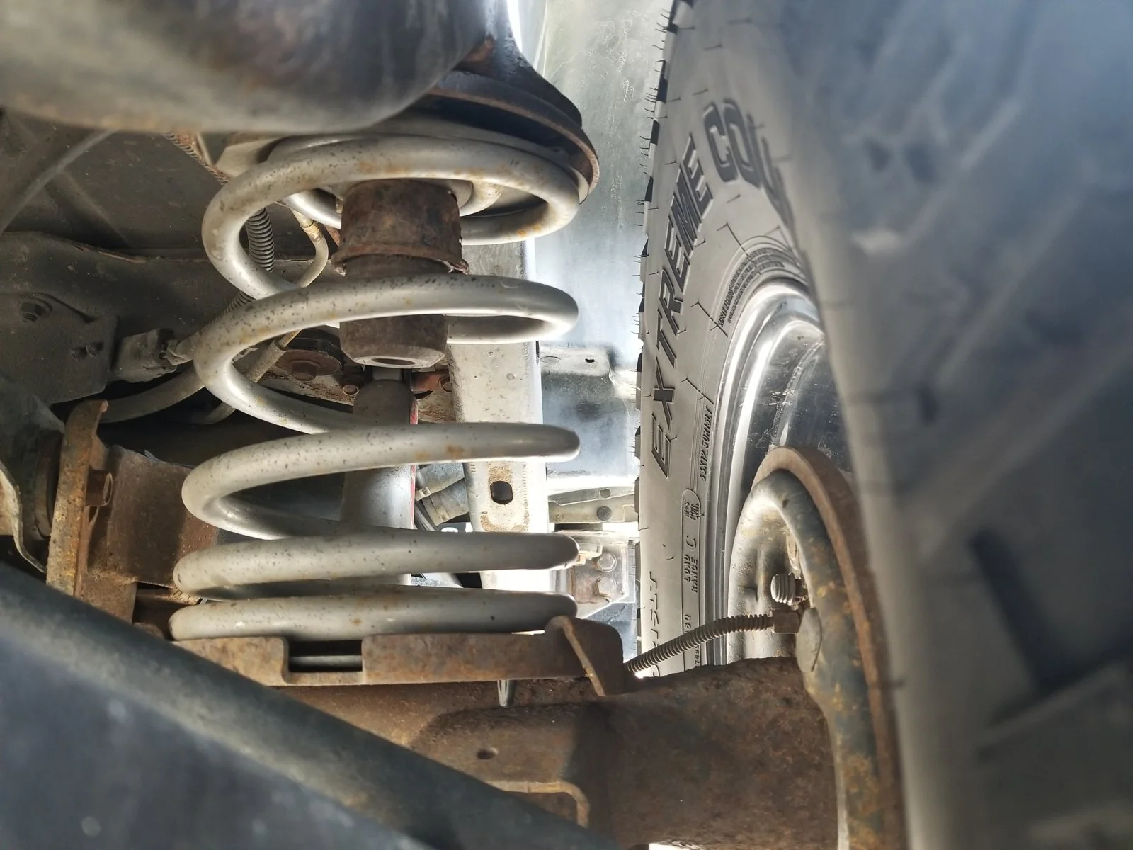

Do I measure the isolators as well? Or just the springs themselves? Just the springs are right around 14.5 so it seems about right.
Reactions: JMT
You have to measure. Springs sag, your jeeps weight can be higher due to additions such as bumpers, winches etc... So measure for yourself and see. Measure the coil springs only, not including the coil spring isolators at the top.
After you cycle your suspension, ideally, you’ll add the needed bumpstop up front to the lower perch. The rear you can do above the bump-stop cup or on the lower perch.

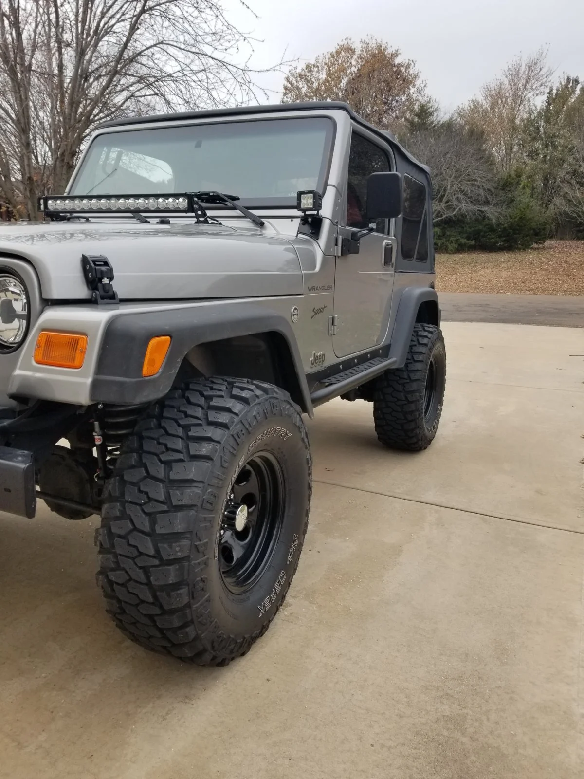

2.25" and 1.75" lift. It isn't uncommon for a kit to have less lift in the rear in order to reduce the factory rake. Personally, I wanted to keep that in mine.

I find it strange that I have as much clearance as I do with just that much lift.

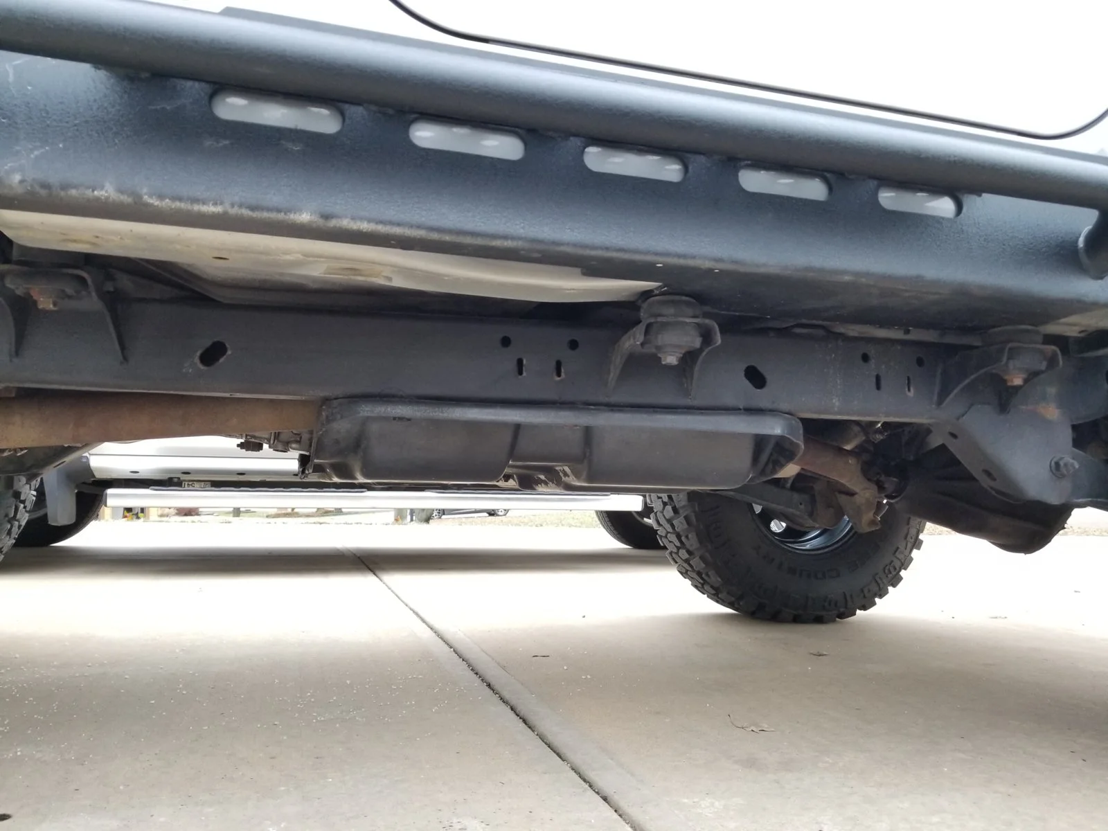

The bump stops are not extended on yours. One thing I can tell you is that your 33s will rub the front fenders at full flex without some BS extension. I've never set that up without a body lift in place, but it will require at least 2" in front. Less if there is a body lift. The rear needs some amount to protect the shocks. Subtract that extension from the space between the cup and axle pad and you'll see that you may not have as much clearance as you think you do.

Wait, do I have a body lift already?
