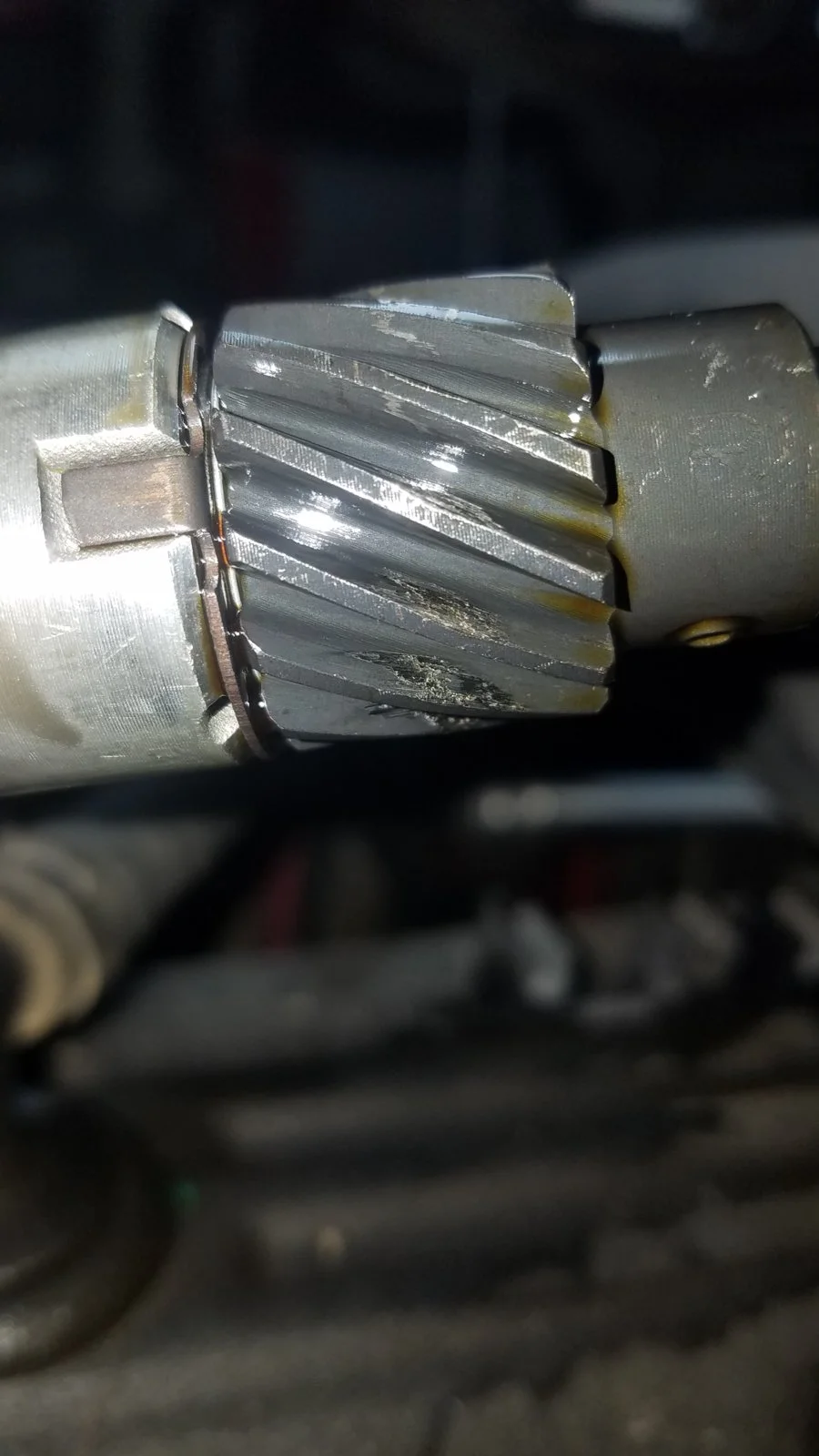

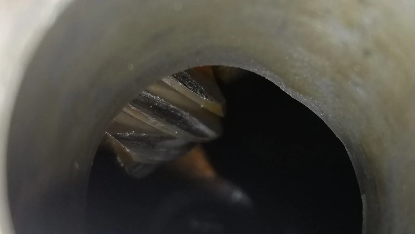

I have a 2005 4.0l. A year and a half ago I replaced the OPDA with a Crown unit, but I keep getting p0340, p0344 and p0016 error codes. I took the OPDA off and found this (photos of cam gear and OPDA gear below).
I am pretty sure my problem is that the cam gear has been worn out causing it to mesh incorrectly with the new opda, and chewing the teeth on the OPDA gear.

I am trying to get Jeep to replace the camshaft for free or reduced price, but I need a Jeep technician to say that the cam gear is worn and causing the error codes, but the technician said they inspected the gear and didn't see any wear. They are saying that the cam and crank sensors need to be replaced. I don't think they ever actually looked at the gear. I am going back tomorrow to show them the pictures I have.
I spoke with someone at Chrysler and made a claim. If a tech. Says the cam gear is worn and needs to be replaced, the agent I spoke with said they may foot the bill or do a partial payment.
I am assuming the Jeep technician is not going to go back on his/her initial ruling. If that's the case, may last resort will be to take it to another dealership and show them the pictures and hope they agree that the camshaft needs to be replaced.

LMAO! That cam wouldn’t pass any engine builder I know inspection.
