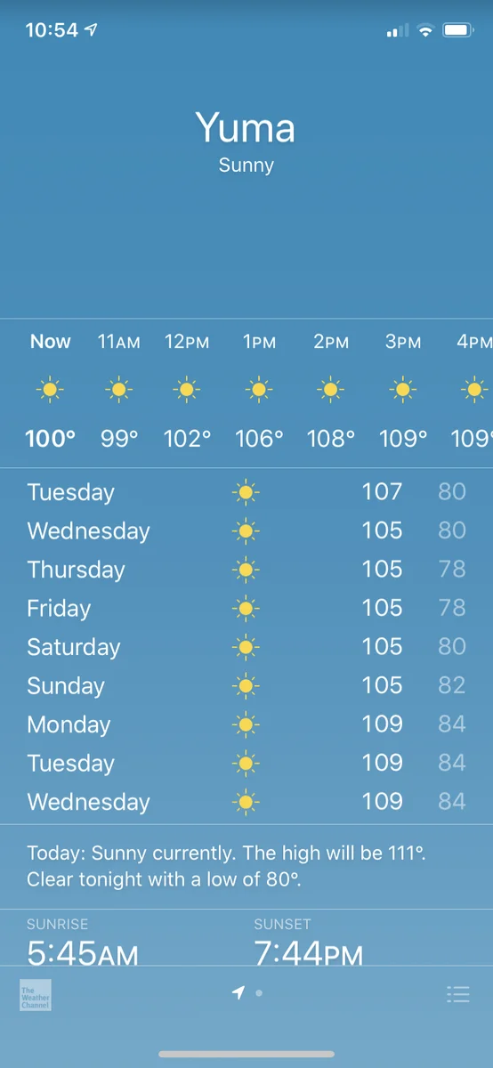

are you guys complaining it's hot where you are? It's going to be 105 degrees or above for at least the next ten days
and I also have a black Jeep
