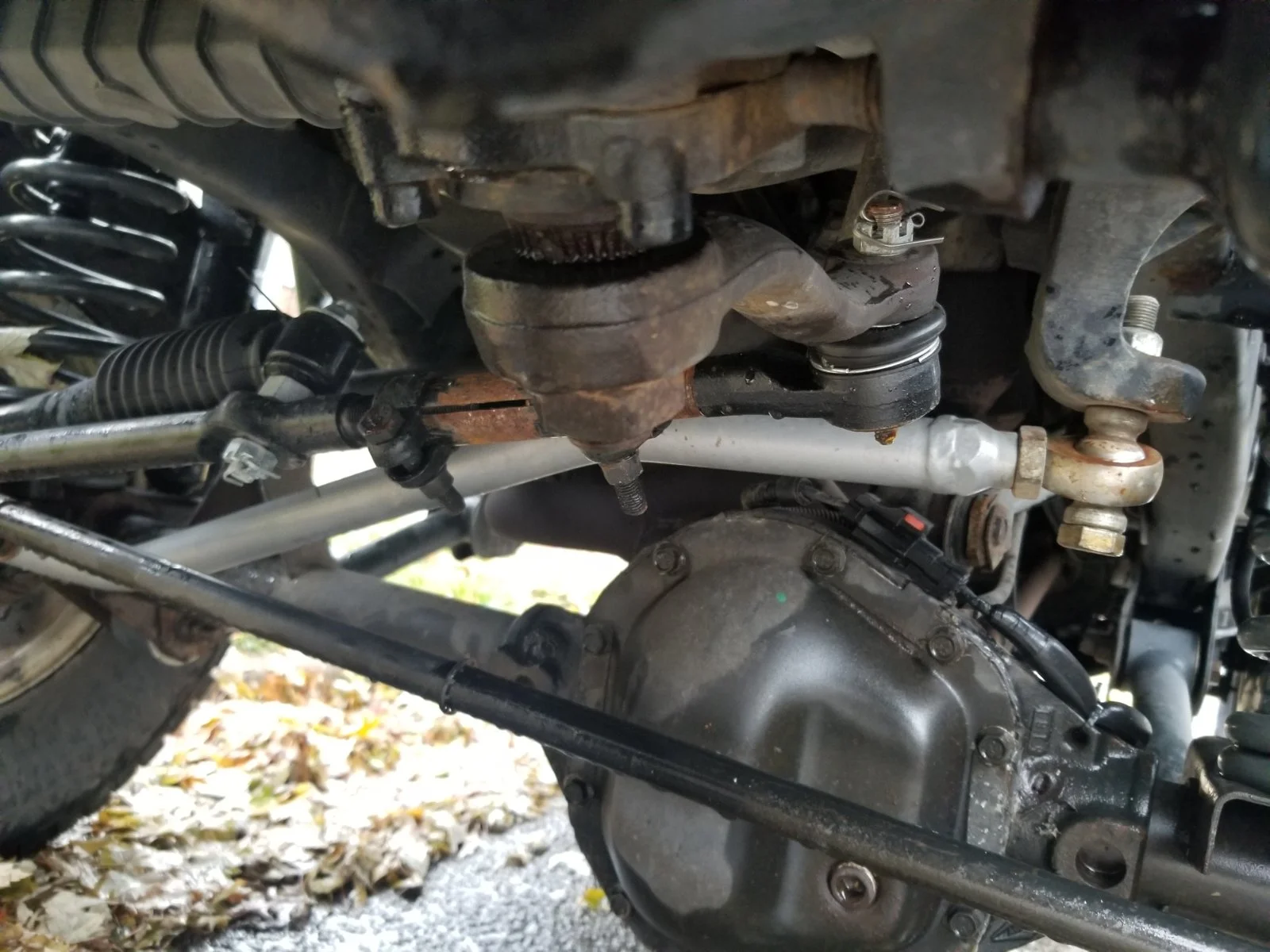

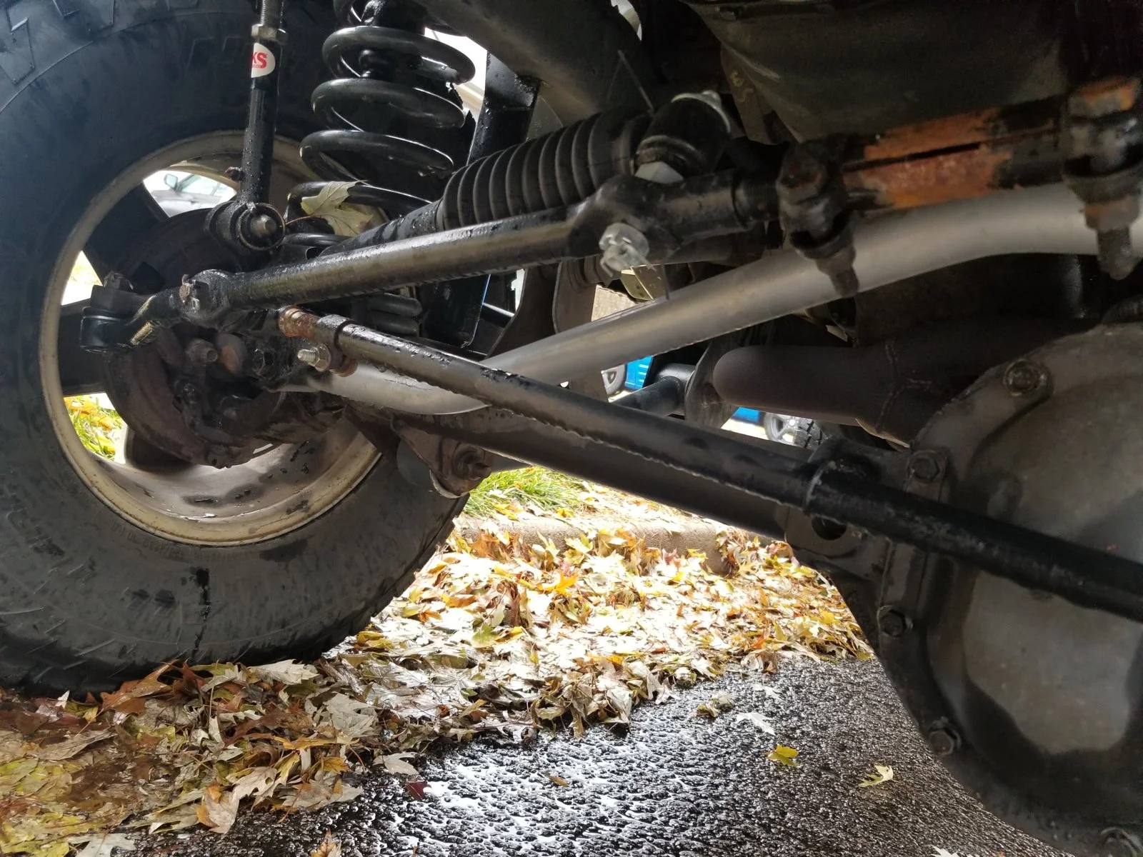

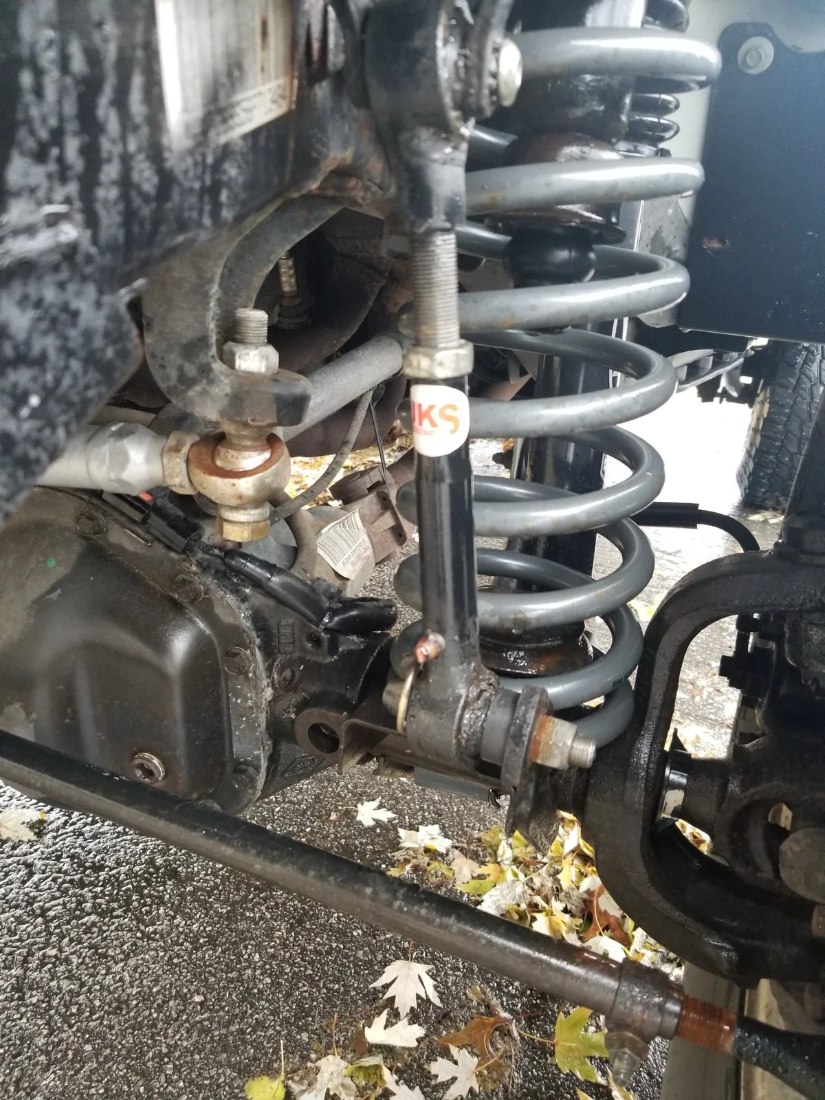

Smart choice. Can you post some pics of the front steering and track bars, as well as the pitman arm at the steering gear box?

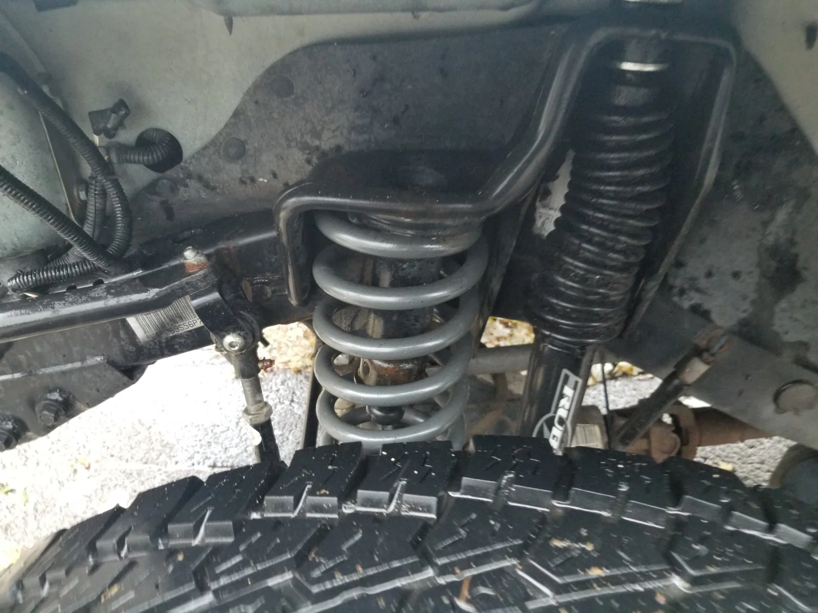

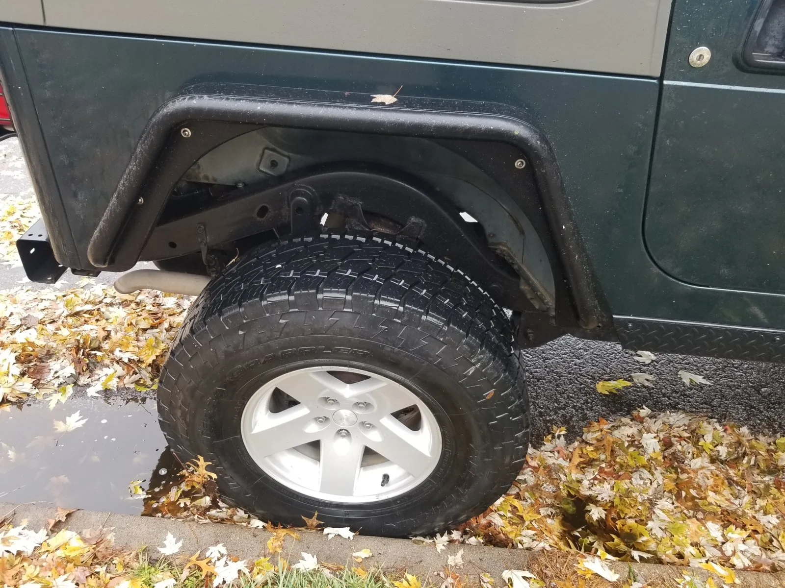

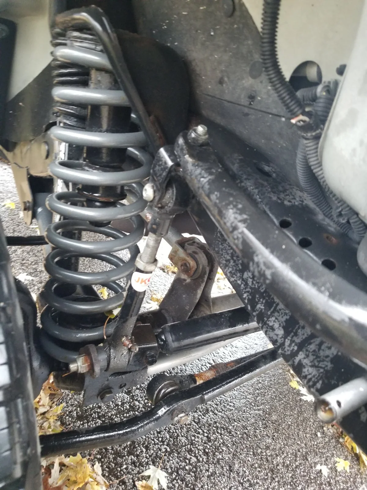

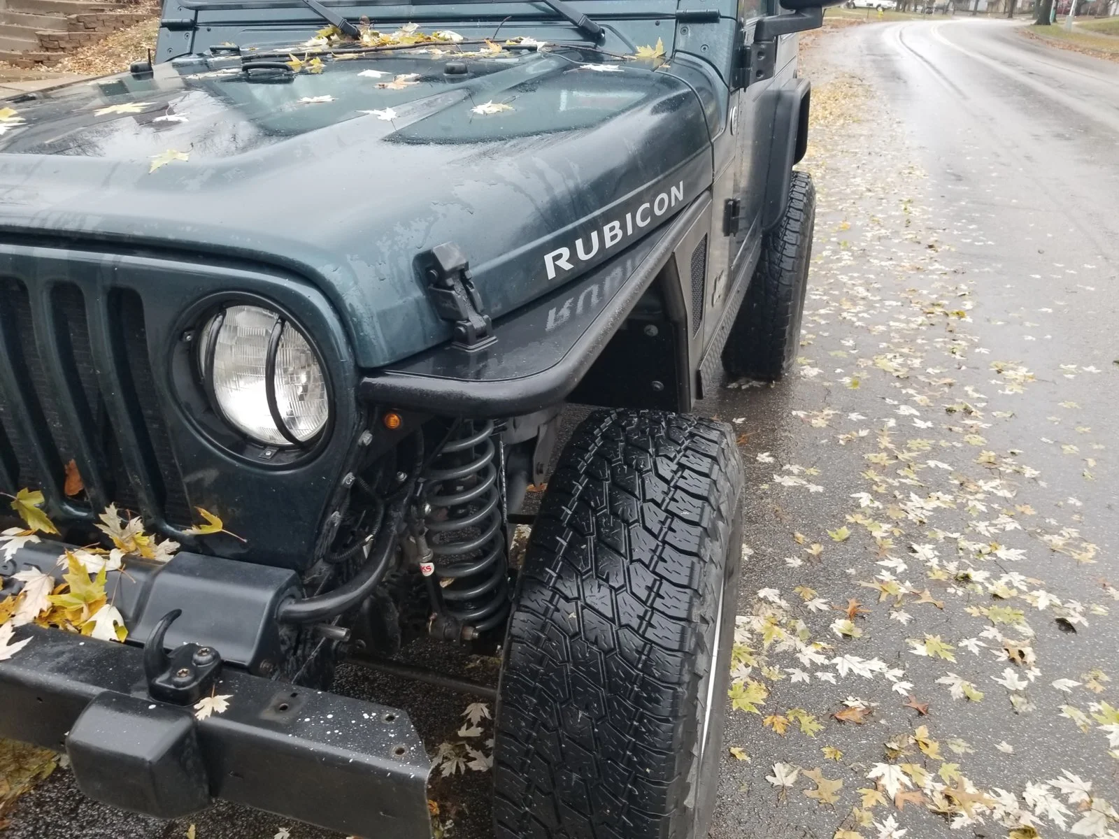

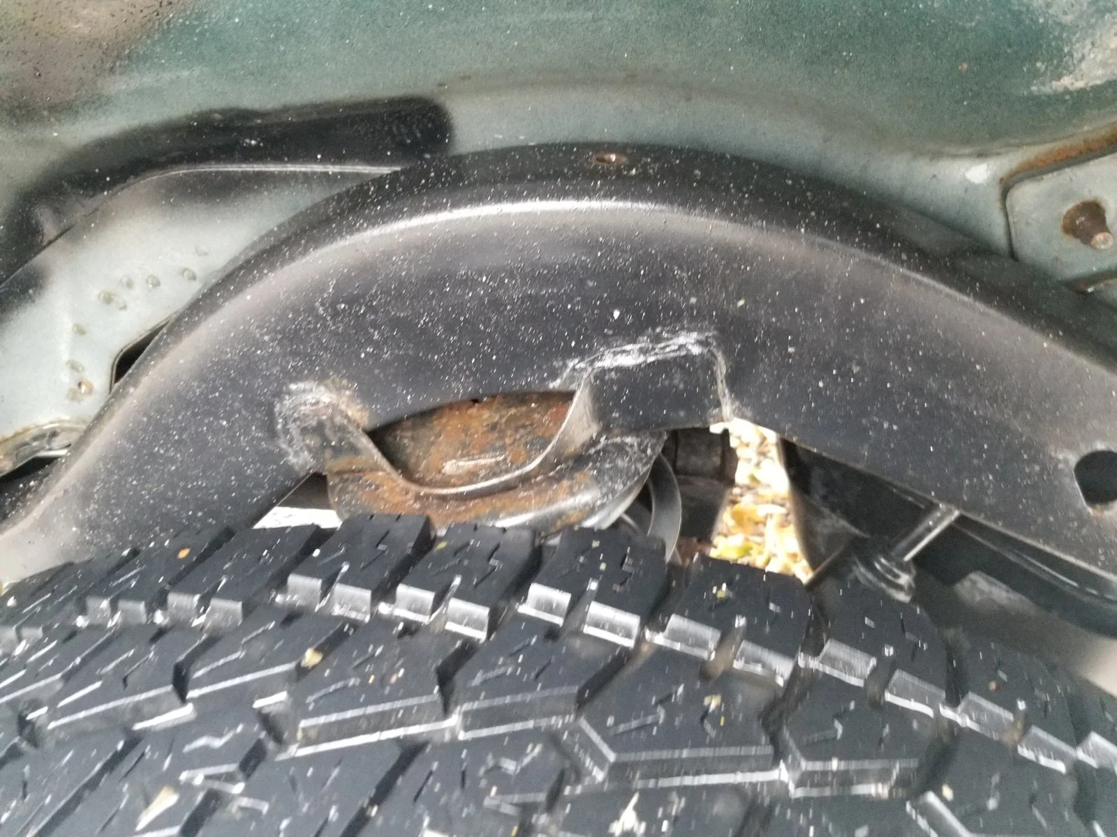

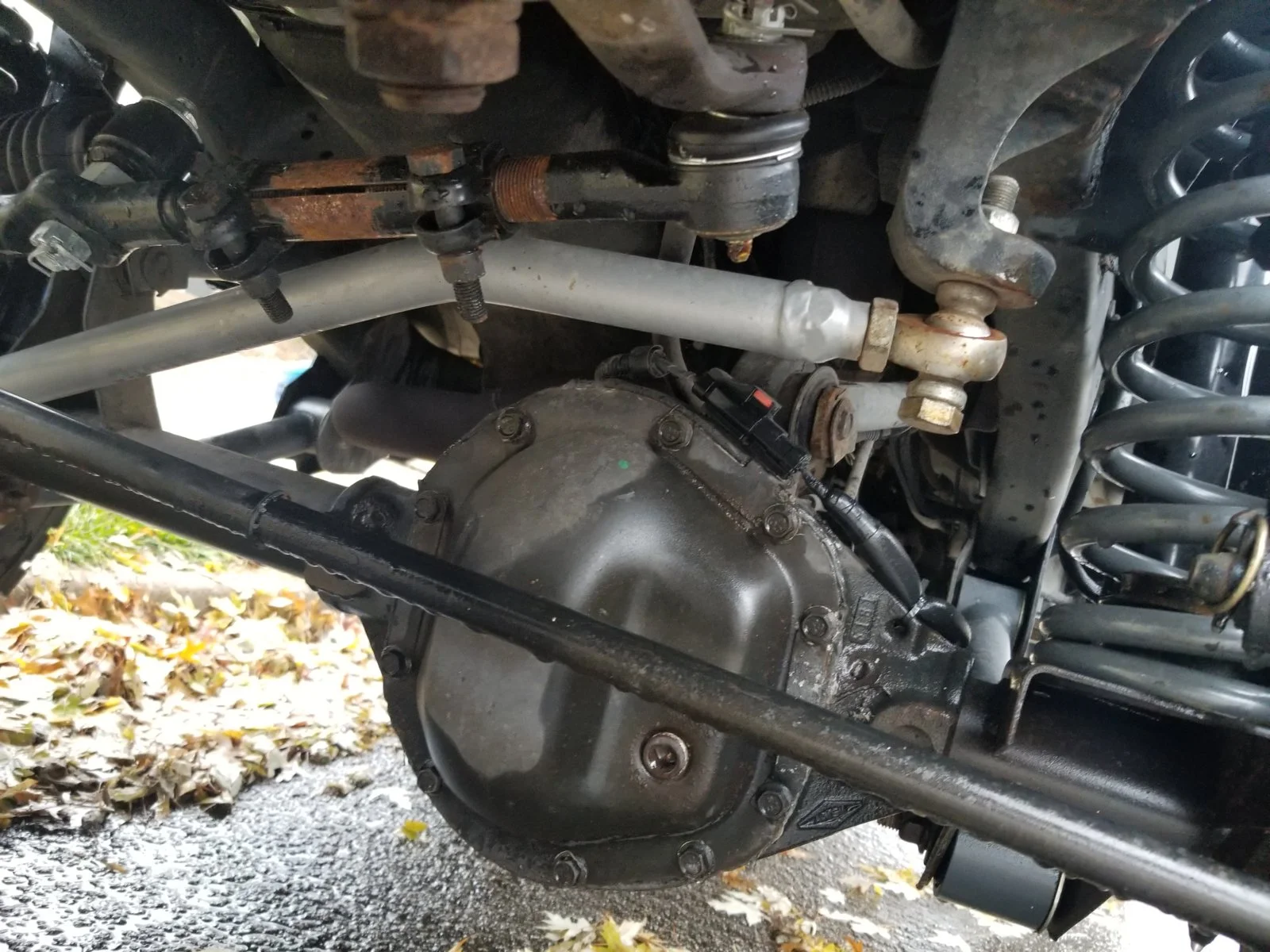

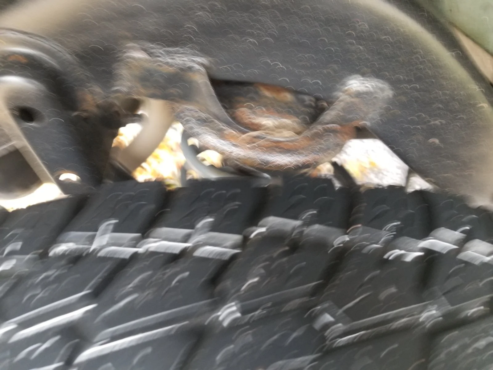

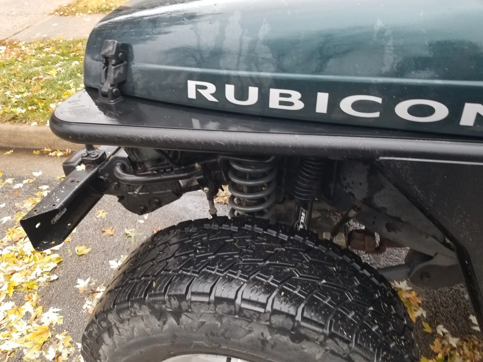

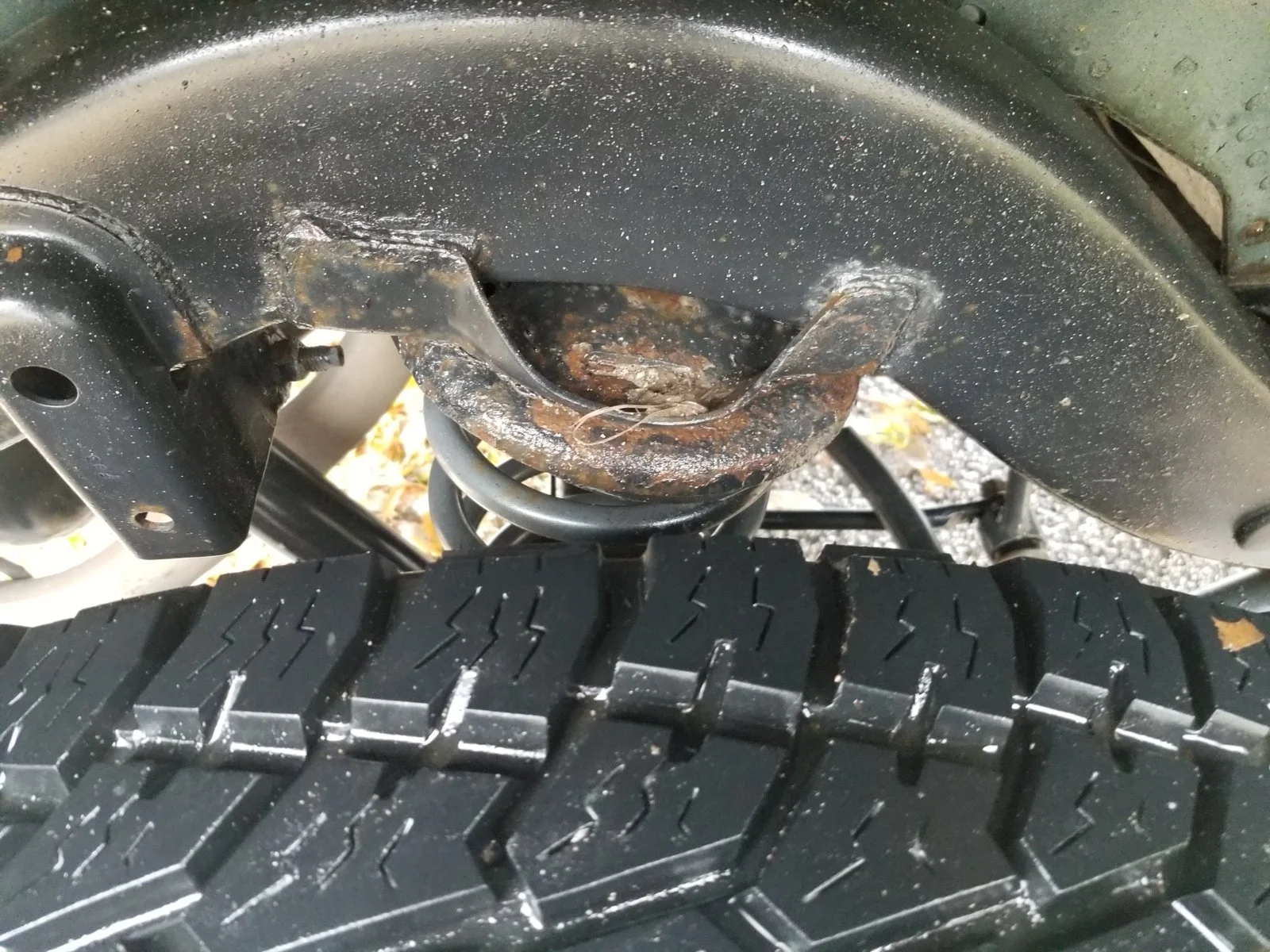

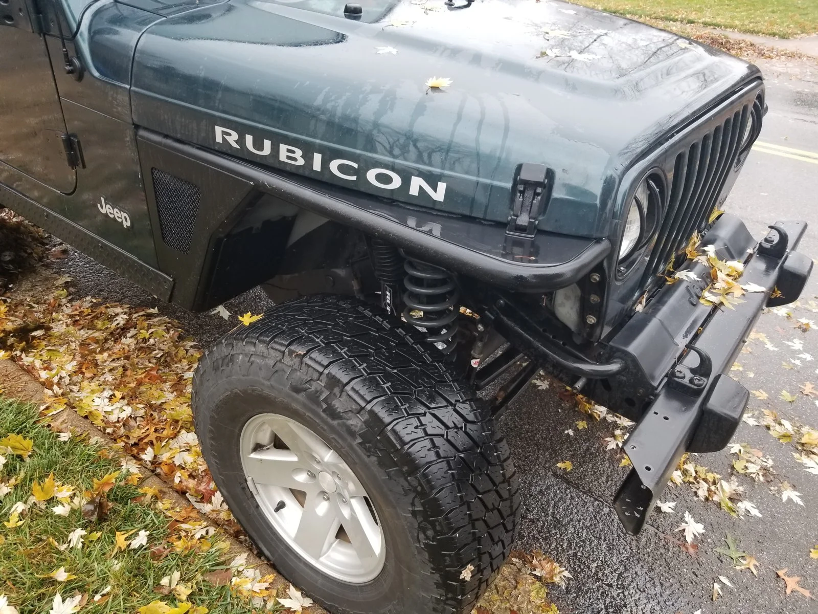

Heres the photos yall asked for
Springs yes. Shocks yes. Looks like the front adjustable track bar adjusted to its shortest setting. You might need a shorter one. Adjustable control arms? May need to re-set angles. Doesn't look like he did any bumpstop work, so you are good there. JKS swaybar links will need to be shortened, looks like you have plenty of adjustment there. Everything else looks stock from what I can tell.
Reactions: Robert Gessler
Looks like it would a straightforward job. You will need to adjust the control arms; the disconnects look like they may end up too long; the heim joint on the trackbar looks dry and pitted; no bumpstop extensions.
If dropping to 2-2.5" I would pull the entire lift and sell it on Craigslist or similar. Then buy some Moog factory style control arms, BDS or Pro Comp coils, Rancho 5000X shocks, JKS trackbar, relocation bracket for the rear, and set up bumpstops correctly.
Ask him where the tires and wheels are that go with the lift. Hard to believe someone would lift it like that and keep the stock tires...what would be the point??

I bought mine with a 4 inch lift and lowered it. I sold the old lift and put on a set of 2.5" OME springs with Rancho 9000 adjustable shocks and stock control arms. It rides better than stock now.
As other said I would sell the lift and buy some quality parts. If the upper control arms are adjustable I would keep them. The Rubicon Express front track bar on the Jeep will not work with a lower lift. It will hit the differential when the suspension flexes. You will need a different track bar. I used Metalcloacks and it works perfectly. I have also heard JKS makes one that will fit. Unless you are a good welder it will be more difficult to go back to stock since the upper track bar mount has been drilled out.
