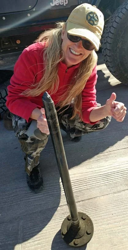

This is a friend of mine, I heard her Dana 35 axle shaft break when we were on the trail together last year.
