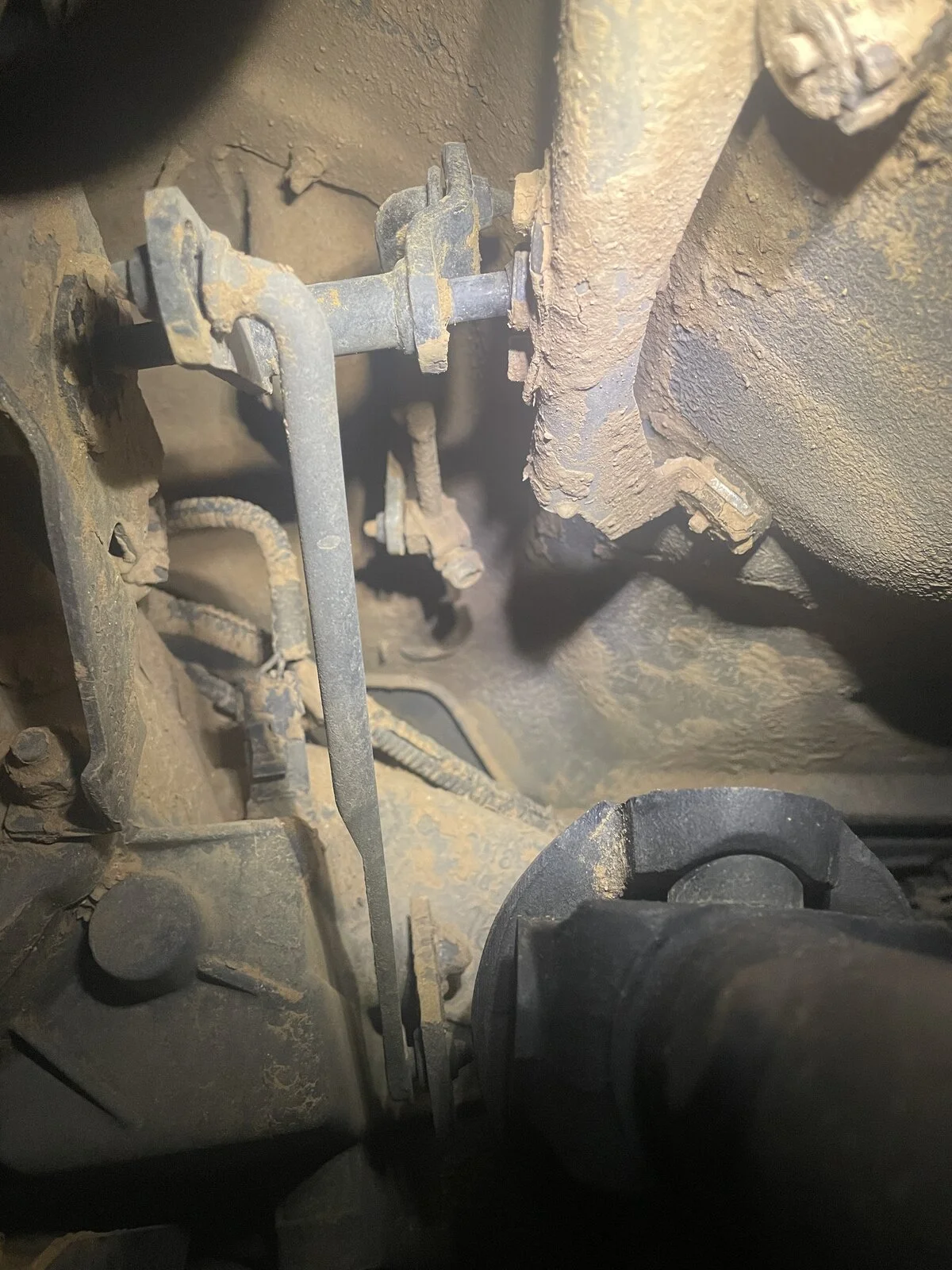

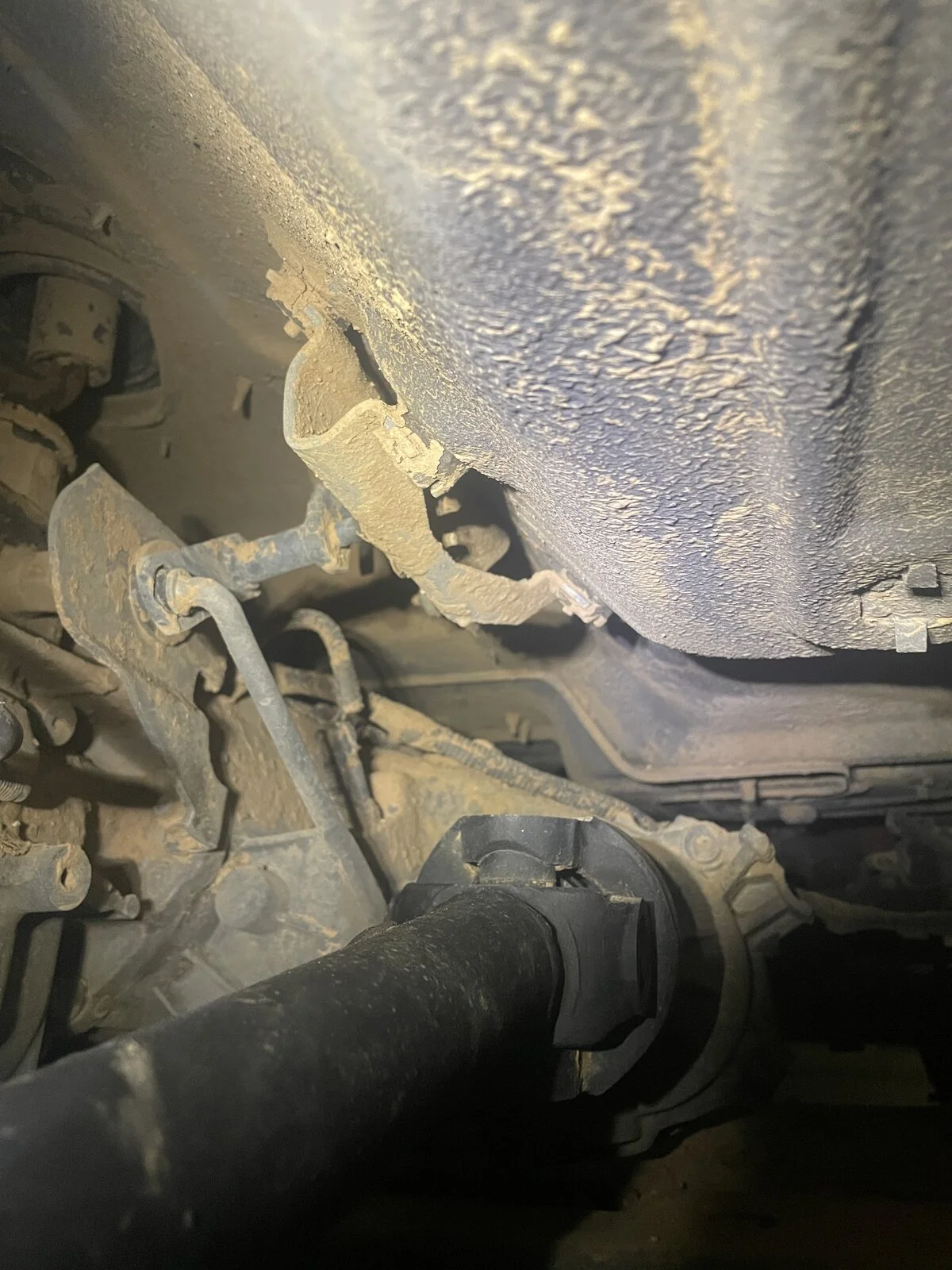

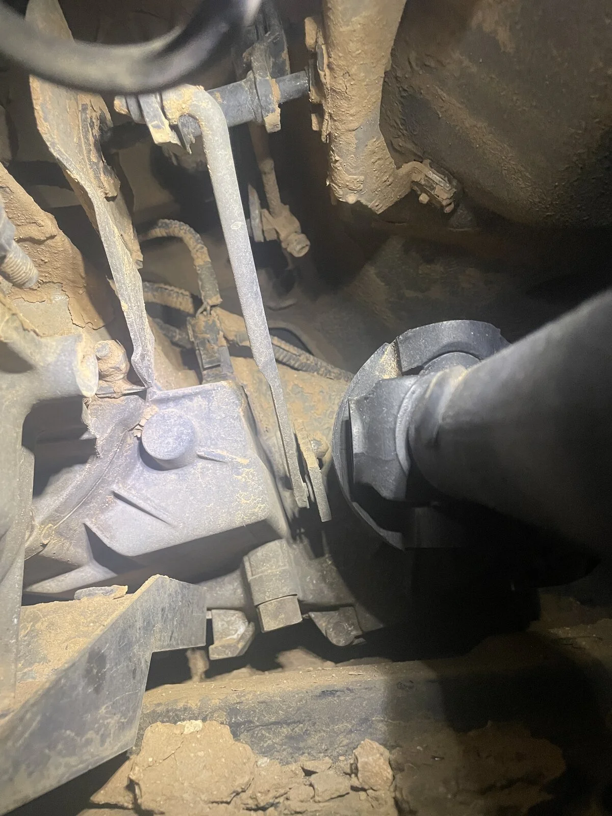

Hey guys, I went off-roading and went through a mud pit (I never do but of course the time I do it causes issues lol) and ever since when I’m in 4h/lo there’s like a metal grinding sound and in 2h there’s a metal rattling noise when I’m driving. When I come to a stop it goes away. My initial thought is that it would be the linkage for the transfer case, y’all think that’s probably it? Sorry for the not great photos but any help would be appreciated!
Everything looks ok on the linkage from first glance. Have you checked your fluids in your TC? Could have sucked up muddy water in it

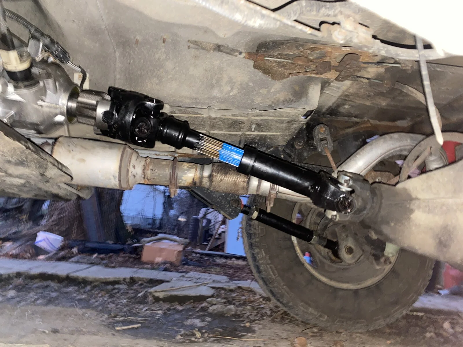

Adam’s or Tom Woods are the two most recommended brands on here. You just measure what you need or if it’s a stock driveshaft they can build it custom for your needs. I just installed an Adam’s rear driveshaft today. Look to pay around $400 for the custom heavy duty driveshaft. A rebuild kit for your factory driveshaft is about $100 give or take
