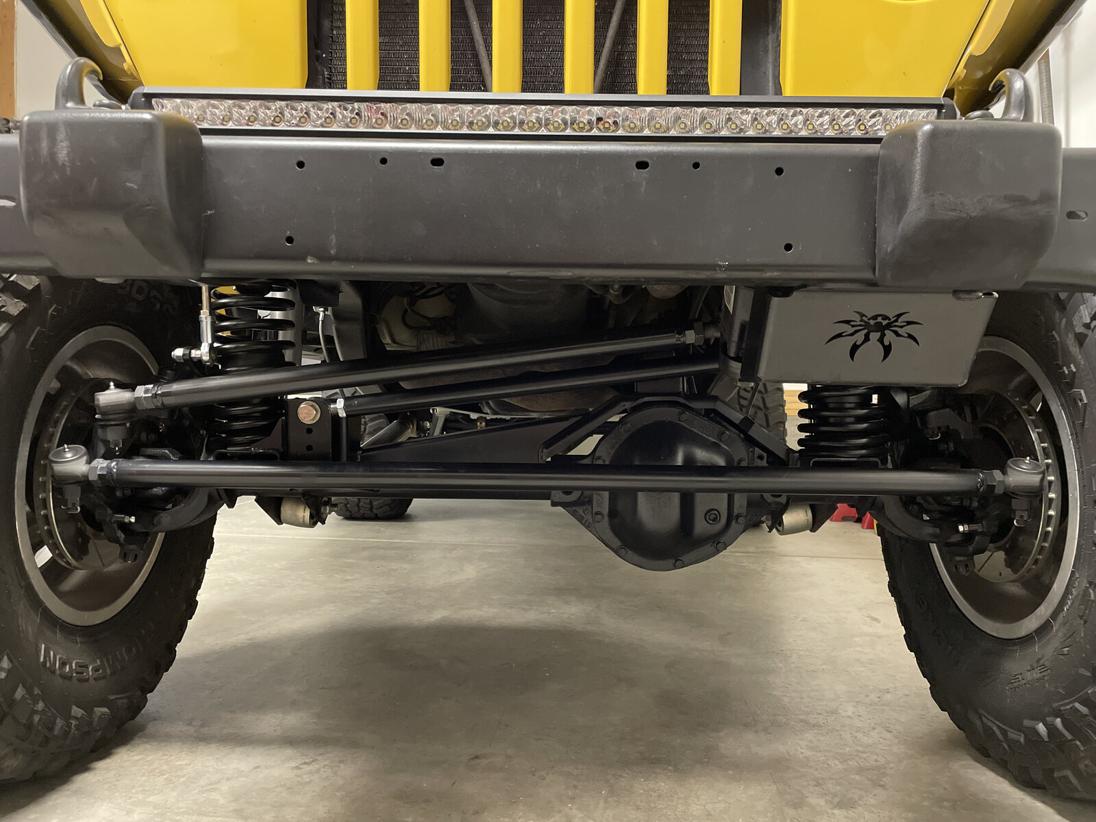

I was getting a tiny bit of bump steer with my new WJ steering set up. The factory pitman had just enough drop my angles from my track bar and drag link were about 3* off…it bugged me enough to order a flat pitman arm from WFO Concepts. They drill the length and taper to your custom specs. After installing my angles were dead on. My Jeep drives and responds awesome. I am very very happy. So happy I called my buddy and we went for a quick burn up “West Mountain” just right close to home.

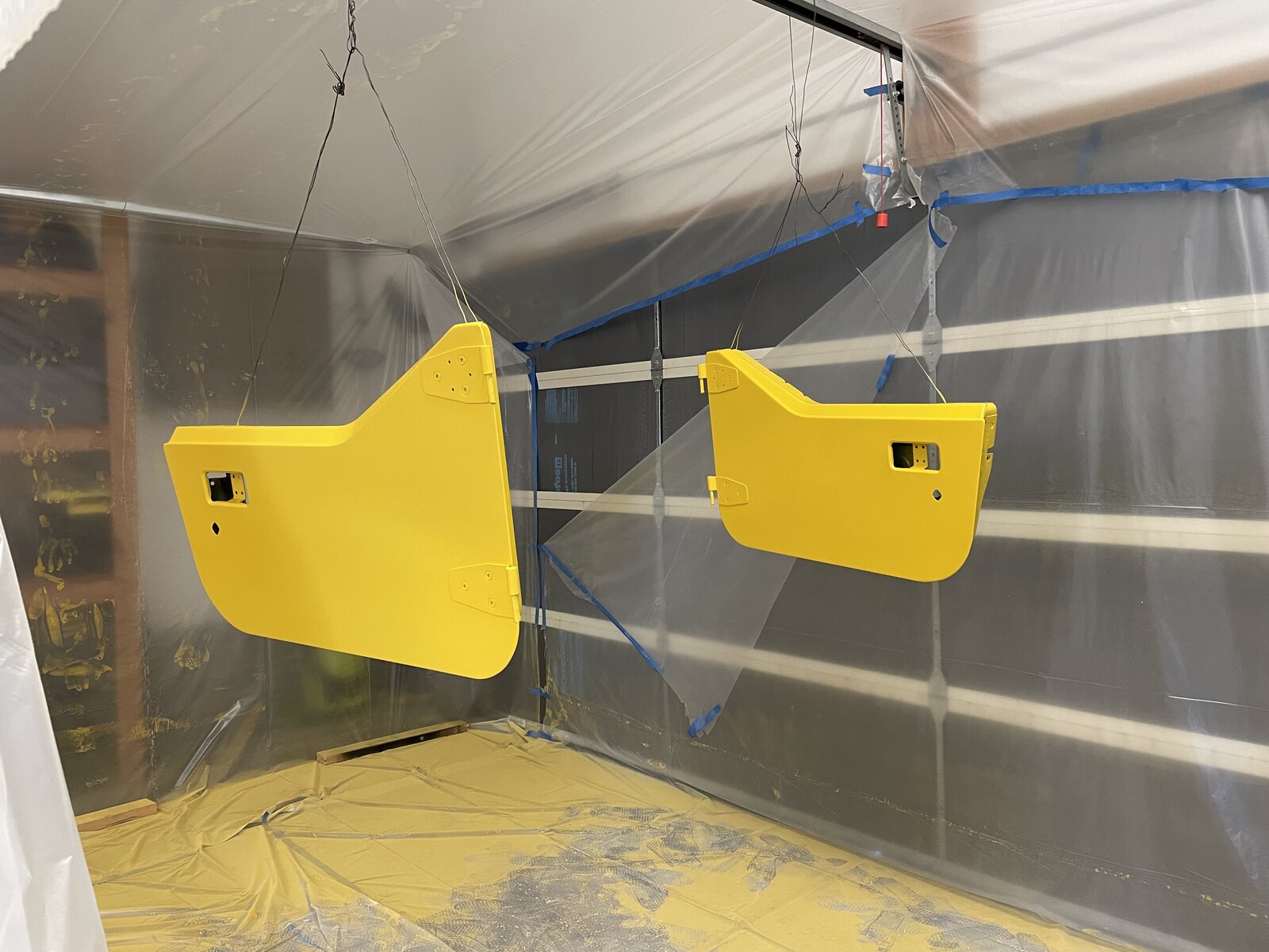

Finally got the half doors done! I’m pleased with how they turned out. I ended up using automotivetouchup.com and sprayed the doors using their aerosols cans. The color match is close, a touch darker which is probably from the factory paint being a bit faded. I wouldn’t say they’re perfect…but it’s about as good as I could expect to get with aerosol cans. I made quite the plastic paint booth in my garage using the garage door rails. I was worried that the whole garage would be yellow if I didn’t. Very glad I did! It was a mess inside that booth. Hardly any overspray got out into the garage.

Damn - now we are really twins. Nice work on the doors. I used the automotivetouchup paint on my corner armor and it was a perfect match. Good stuff.
When I did my half doors years ago I had a pro do a color match - not so much…
I might have to try this on the grey full doors I picked up. WInters coming.
Nice work on your half doors.

Painting is a frustrating process for me. I feel like getting a perfect match is a crap shoot. Someday day I’d just like to repaint the whole Jeep.
Thank you! I’d definitely recommend their products. Order more clear then you think you’ll need. The cans don’t spray very smooth once they start getting close to empty. Having a fresh can to spray a nice solid coat of clear is a must for a smooth finish.

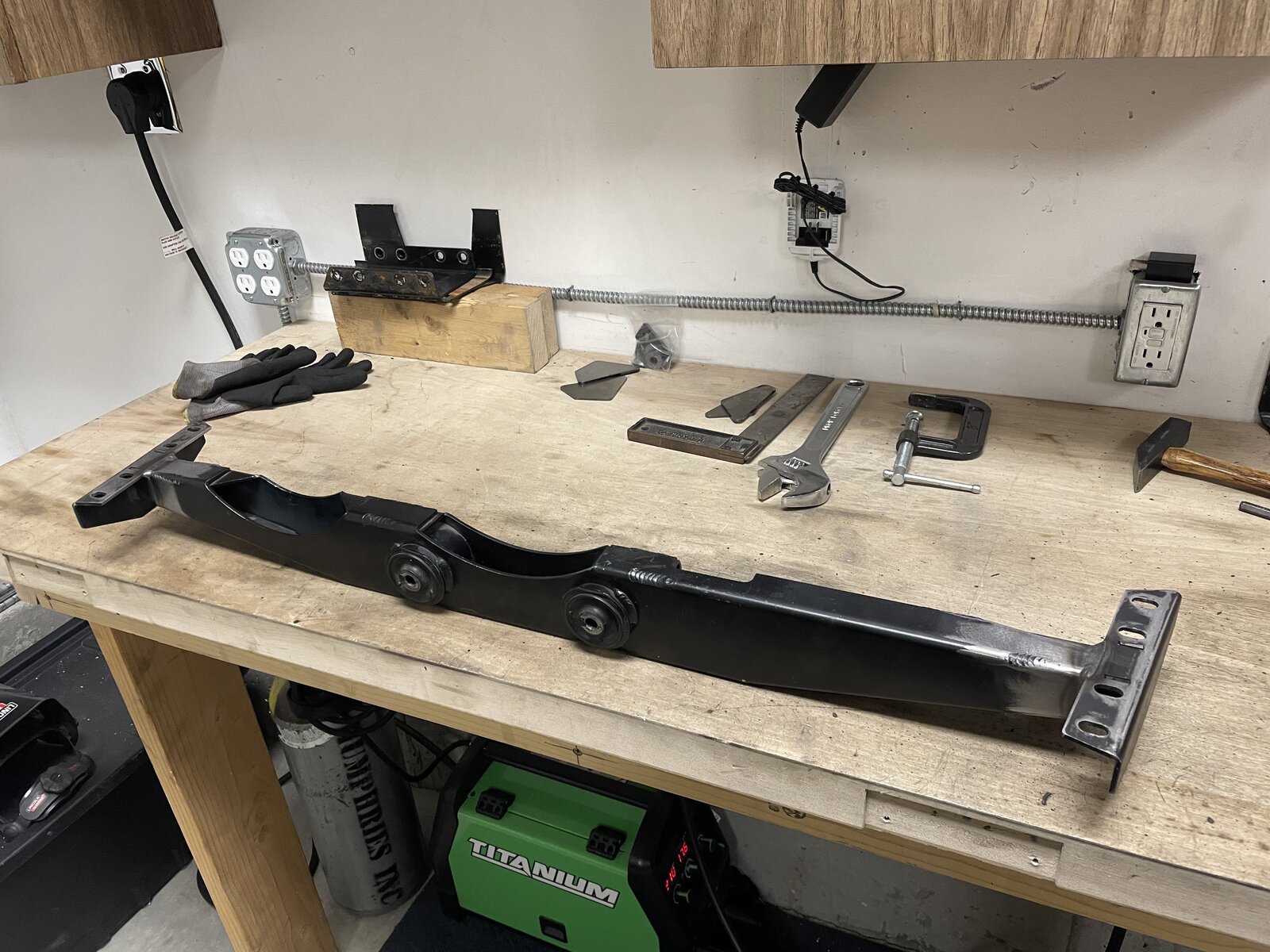

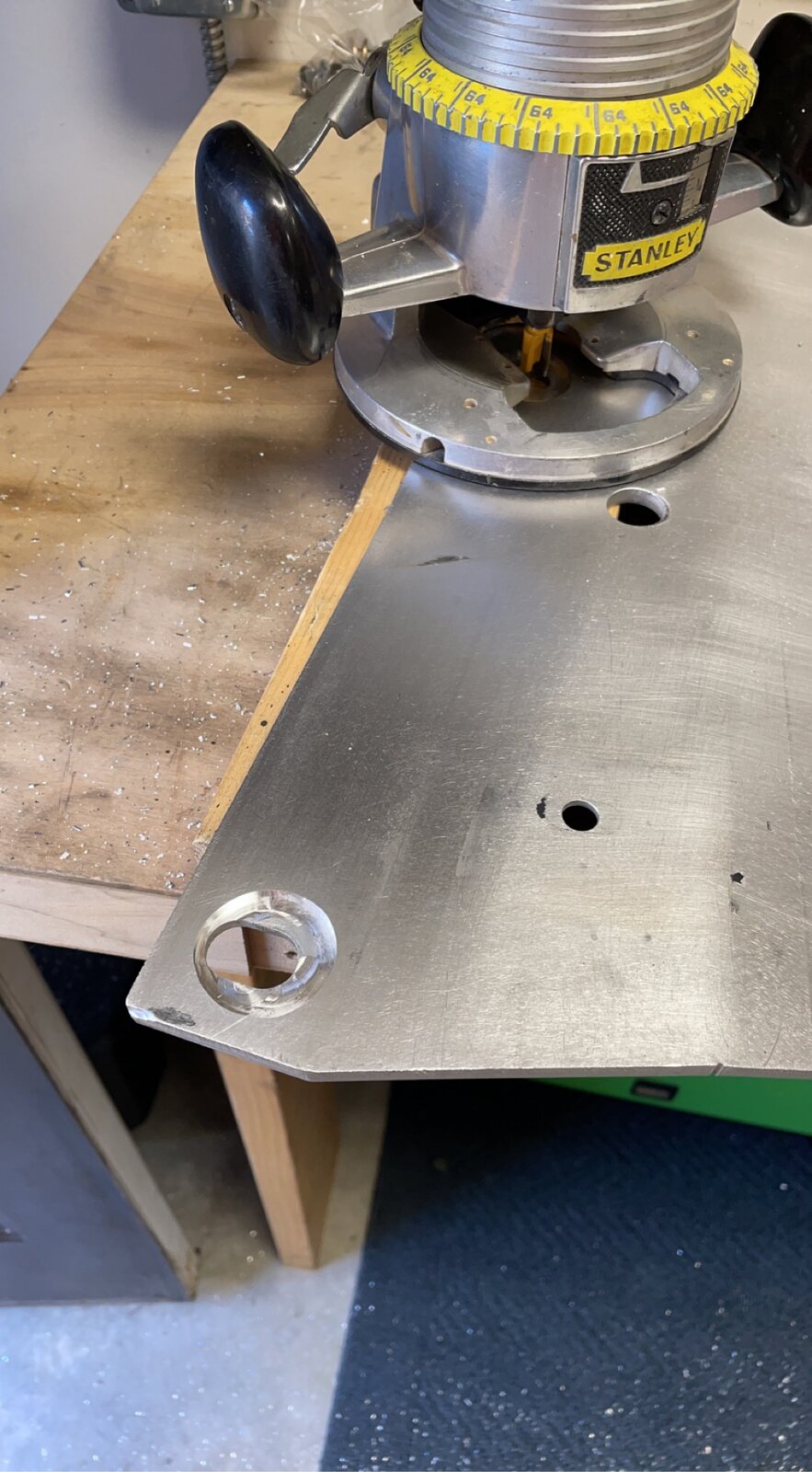

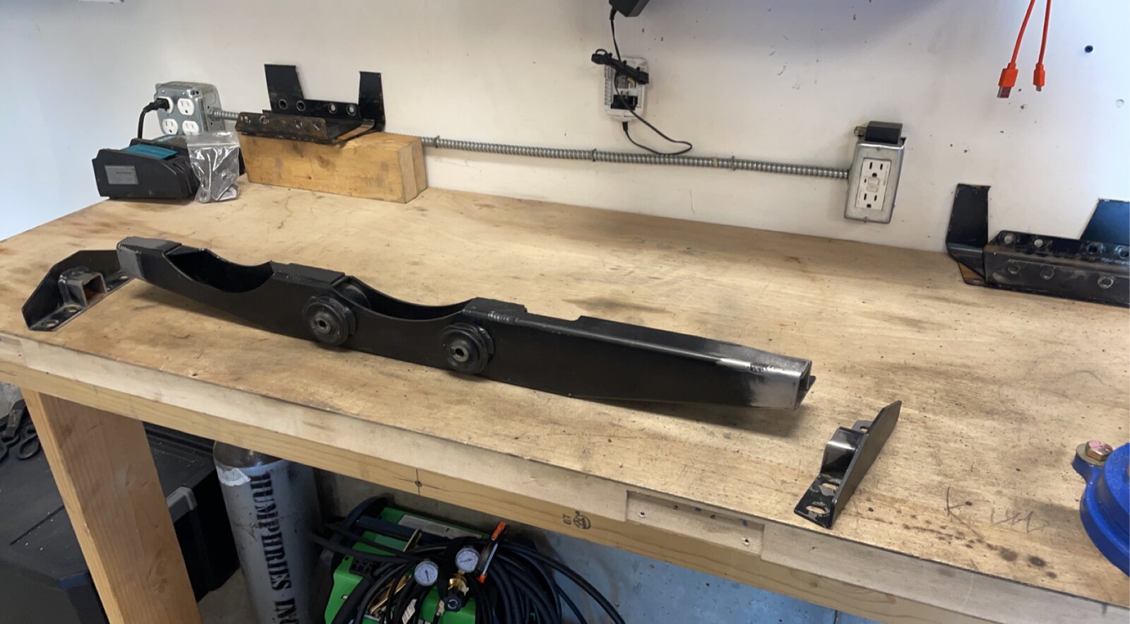

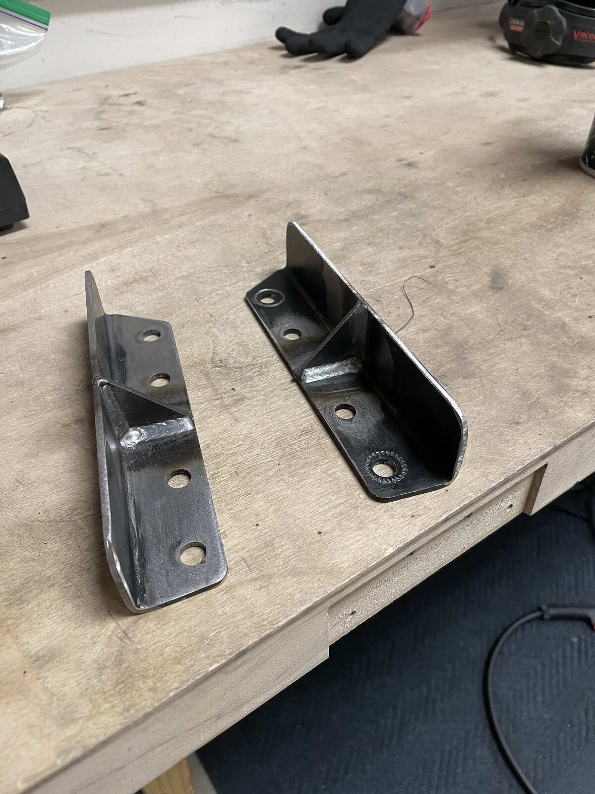

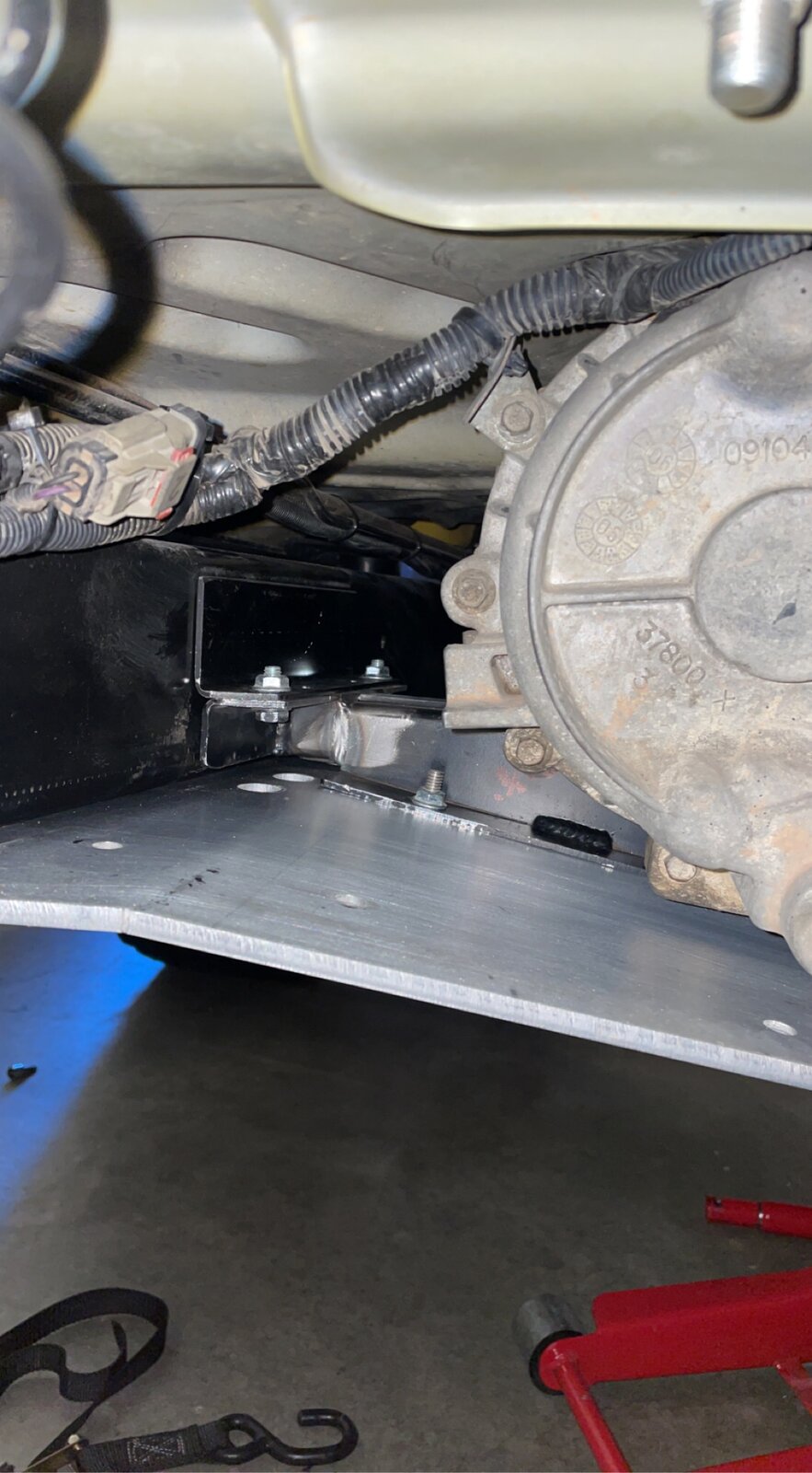

I got a little bored this past week and felt the urge to cut, weld, and do some fabbin. One day I’d like to raise my body mounts to hide the body lift. There are a few things that have to change before that can happen. First is the Savvy skid plate. Some of you know that the cross member is a bolt on design that wraps around the frame rails and around the center body mount. Raising the center body mount is difficult because of this. Mods to the cross member must be done. I cut the ends off the savvy cross member, flipped them and welded it back together. Then I will weld the mounting flanges to the inside of the frame rails. Realizing that I would still have to use the 1/8” plate spacers to compensate for the nutsert flanges on the bottom of the frame, I messaged Blaine to see if he had any work arounds. He guided me to counter bore the skid so the nutserts would sit sub flush and the skid would be flush to the frame rails. A little time with the router and this is what I ended up with. Just need to finish welding and throw some paint on.
I got a little bored this past week and felt the urge to cut, weld, and do some fabbin. One day I’d like to raise my body mounts to hide the body lift. There are a few things that have to change before that can happen. First is the Savvy skid plate. Some of you know that the cross member is a bolt on design that wraps around the frame rails and around the center body mount. Raising the center body mount is difficult because of this. Mods to the cross member must be done. I cut the ends off the savvy cross member, flipped them and welded it back together. Then I will weld the mounting flanges to the inside of the frame rails. Realizing that I would still have to use the 1/8” plate spacers to compensate for the nutsert flanges on the bottom of the frame, I messaged Blaine to see if he had any work arounds. He guided me to counter bore the skid so the nutserts would sit sub flush and the skid would be flush to the frame rails. A little time with the router and this is what I ended up with. Just need to finish welding and throw some paint on. View attachment 287647View attachment 287648View attachment 287649View attachment 287650
I like the shape of the L’s against the frame you did better than my setup, it’s been one of those things itching at me to rework during this off-season. Nice job!
Thanks! They are the inner piece of the savvy bolt on design that I just cut in half.
I added a little gusset in the middle of it tonight.

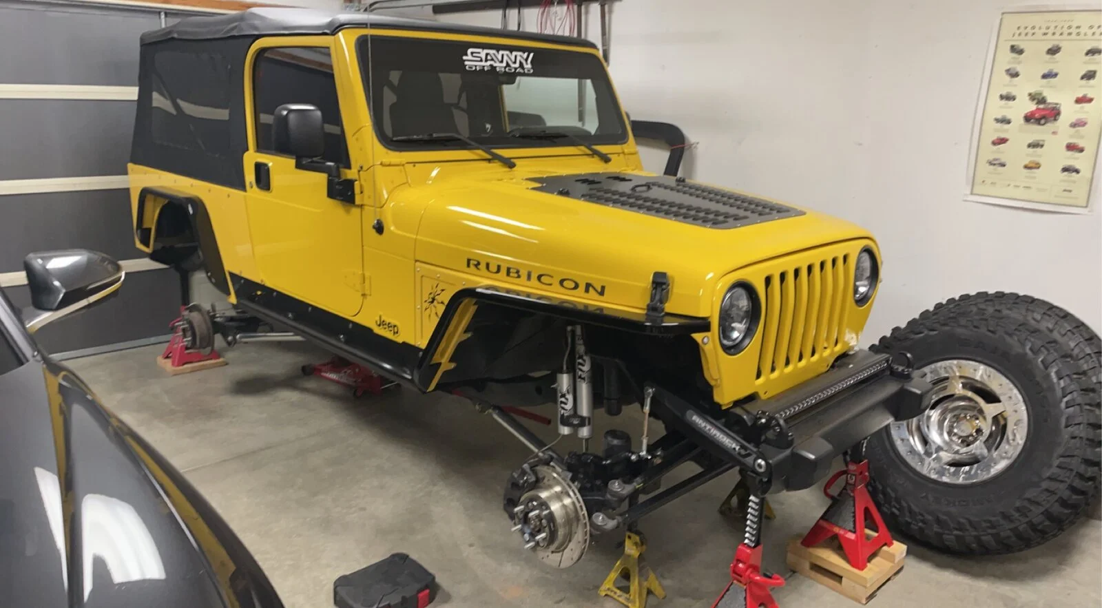

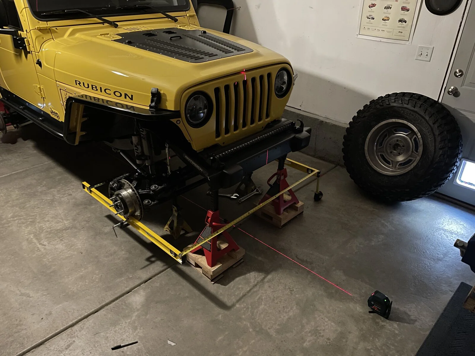

Those lasers are a game changer when doing alignments in the shop. I do the same thing.
