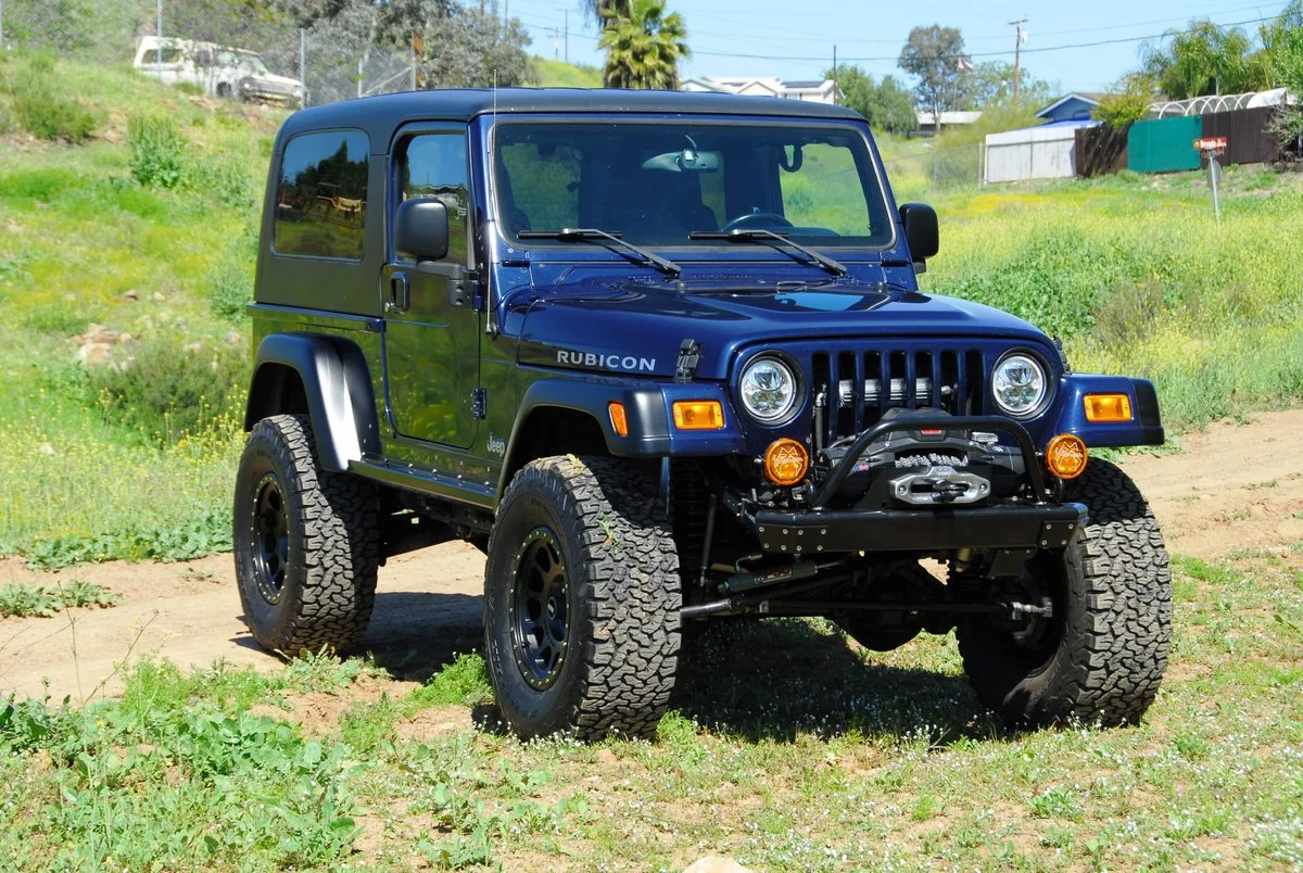

Now that Mike is on his way, I'll toss one up so you can see what he'll see when he gets here.
That looks amazing so far @Midnight LJR. I see you went with the Vision-X light cannons. I had those on mine and really liked them, especially the ability to use difference colored lenses, as well as lenses with different light output patterns.
What wheels are those? From that angle they look like Method 305s.
Reactions: tomtaylz
Wow. That's what mine hopes to be one day, with some minor appearance changes to my liking.
