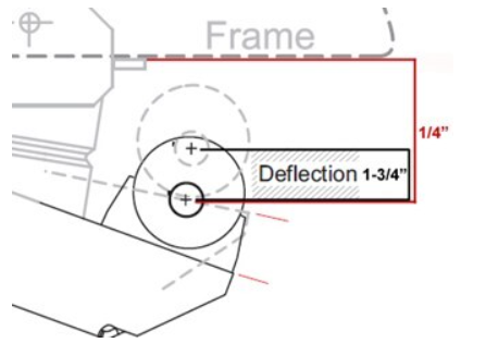

This picture seems to show 1.75" of travel. If so part of that travel would used by the weight of the trailer. Timbren does have some parts that are aimed at off road trailers, but I am not sure about them absorbing the size of offroad bumps compared to street bumps.

Look at the pic he posted of the trailer with one tire on a rock. Based on that pic and knowing how trailer springs work, I don't know that it would ever use all that travel anyway.
Trailers don't articulate, but they can absorb bumps. Having less than 2" of travel on a trail will test your packing skills. Your tires will act as suspension with no rebound control. Most offroad trailers have shocks for that.

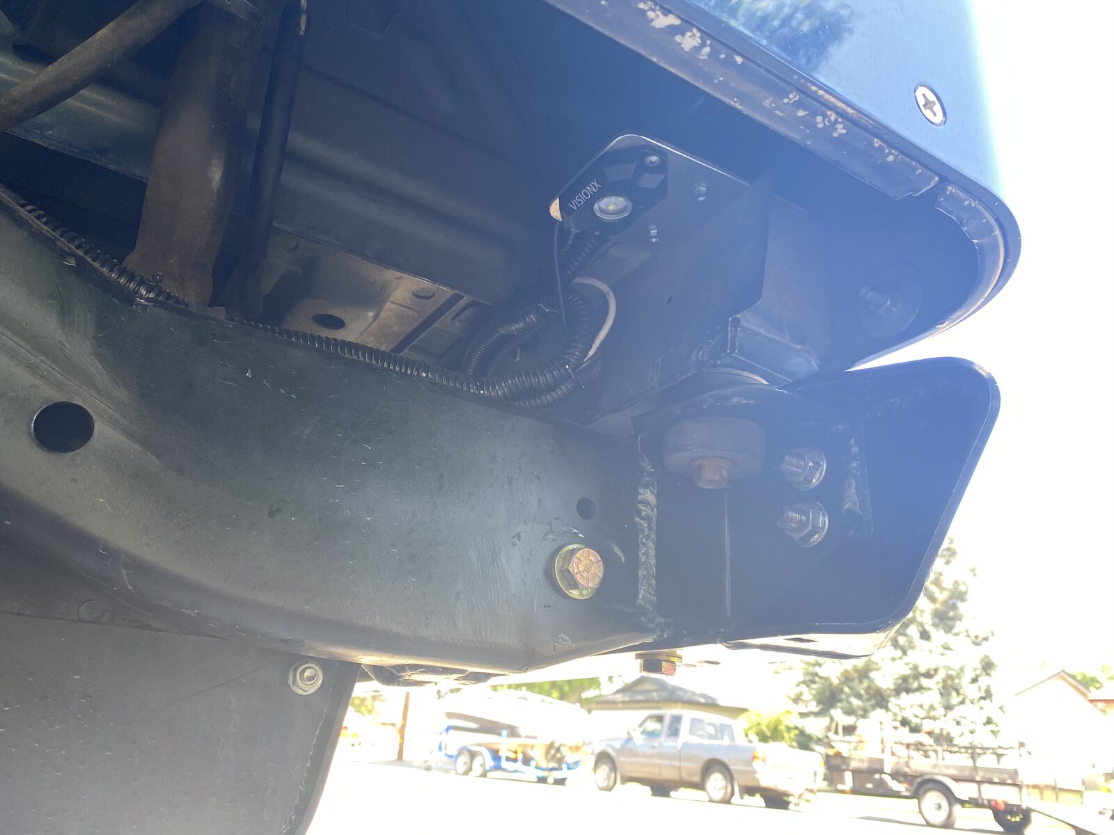

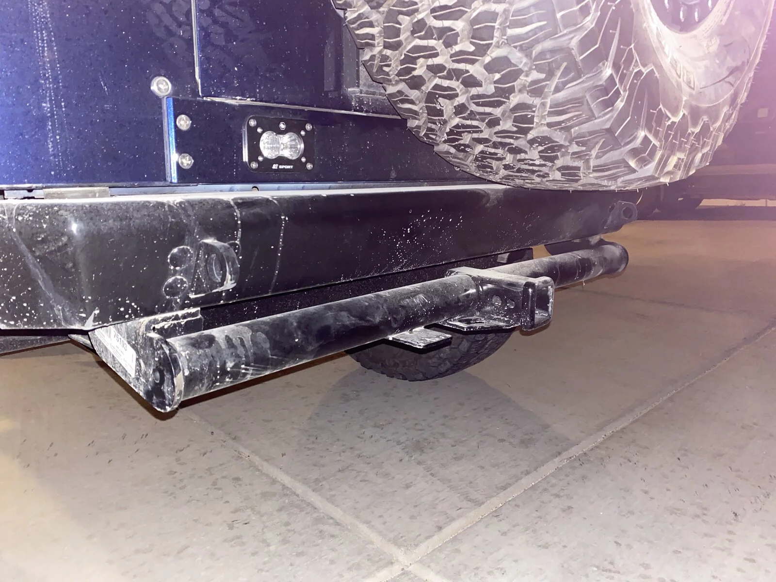

I think you talked about this earlier in the thread but I couldn't find it again, how is the hitch mounted? Is it on normally or tucked up into the bumper some?
Hmmm both, kind of?
Quoting myself from earlier in the thread

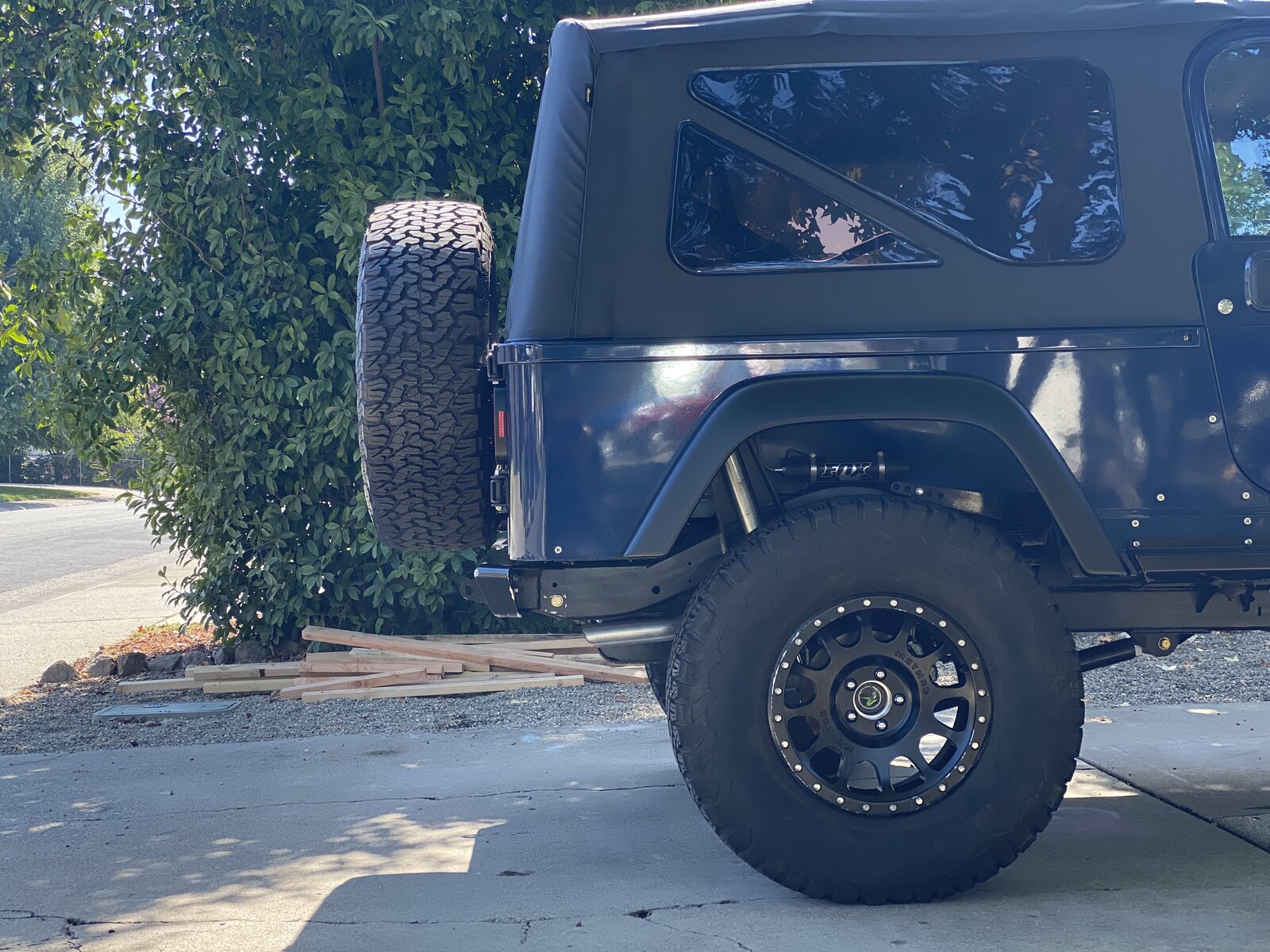

Blaine also did the rear tuck and made it super easy to remove the hitch. I tried it to see how easy it was and it came right off. I like how he welded the nut inside the frame so I don’t have to keep track of loose hardware. Here’s some shots of the new back end with the Savvy Taillights. There was a lot more work involved in that little change than it looks like. He had to rework the spare tire carrier, move the license plate with a new bracket, mount a new light mount for the license plate and figure out a way to make it so my backup camera still worked. I am thrilled with how all of it turned out.
I use a receiver that could bolt up to any TJ. But the frame has been raised 1.5” and a whole bunch of blaine magic so the nuts are inside and I only have to remove 4 bolts to take it on and off in about 5 minutes. He even made all the bolts use the same size socket even though I believe one is metric and was is standard.
Hmmm both, kind of?
View attachment 307124View attachment 307125View attachment 307126

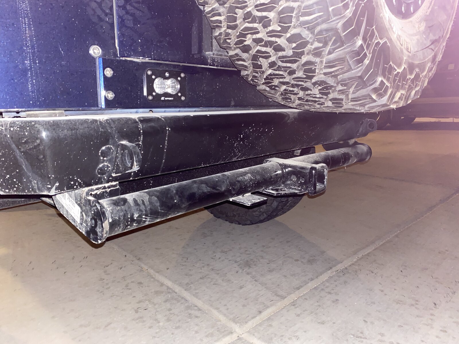

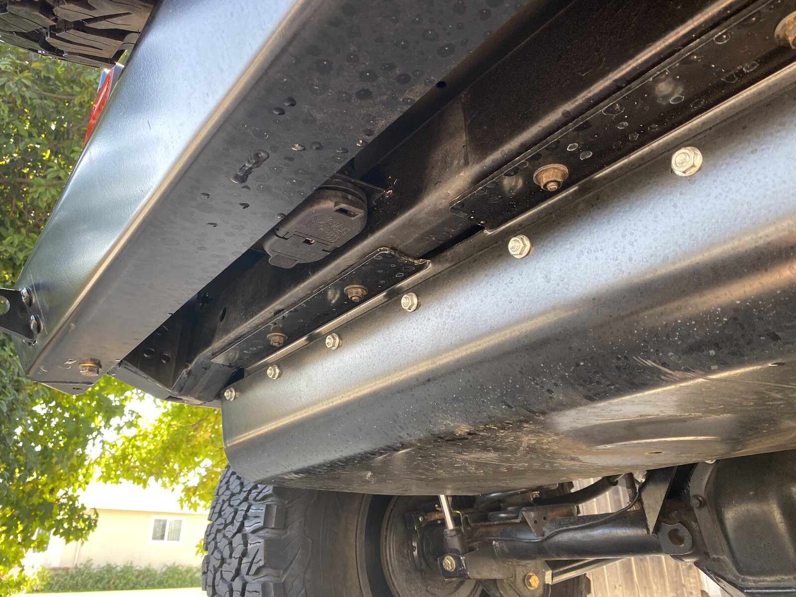

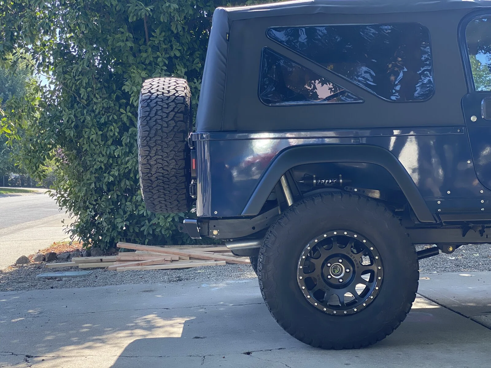

Do you have a picture of the rear end where I can see the receiver in relation to the bumper?
Went out and got it in the dark for ya. I can get a better picture tomorrow in the light for you if you want one just let me know.
The main thing is it comes off very quick, and when I have the trailer on the small loss of departure angle is irrelevant for anything I would be doing with it.
Hmmm both, kind of?
Do you do the outboard and raise the frame at the same time?
That's perfect, thanks.
