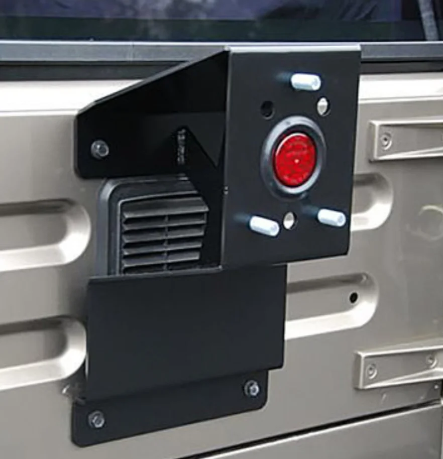

HYLINE OFF-ROAD has a stock style mount the raises the tire up. It replaces the factory mount

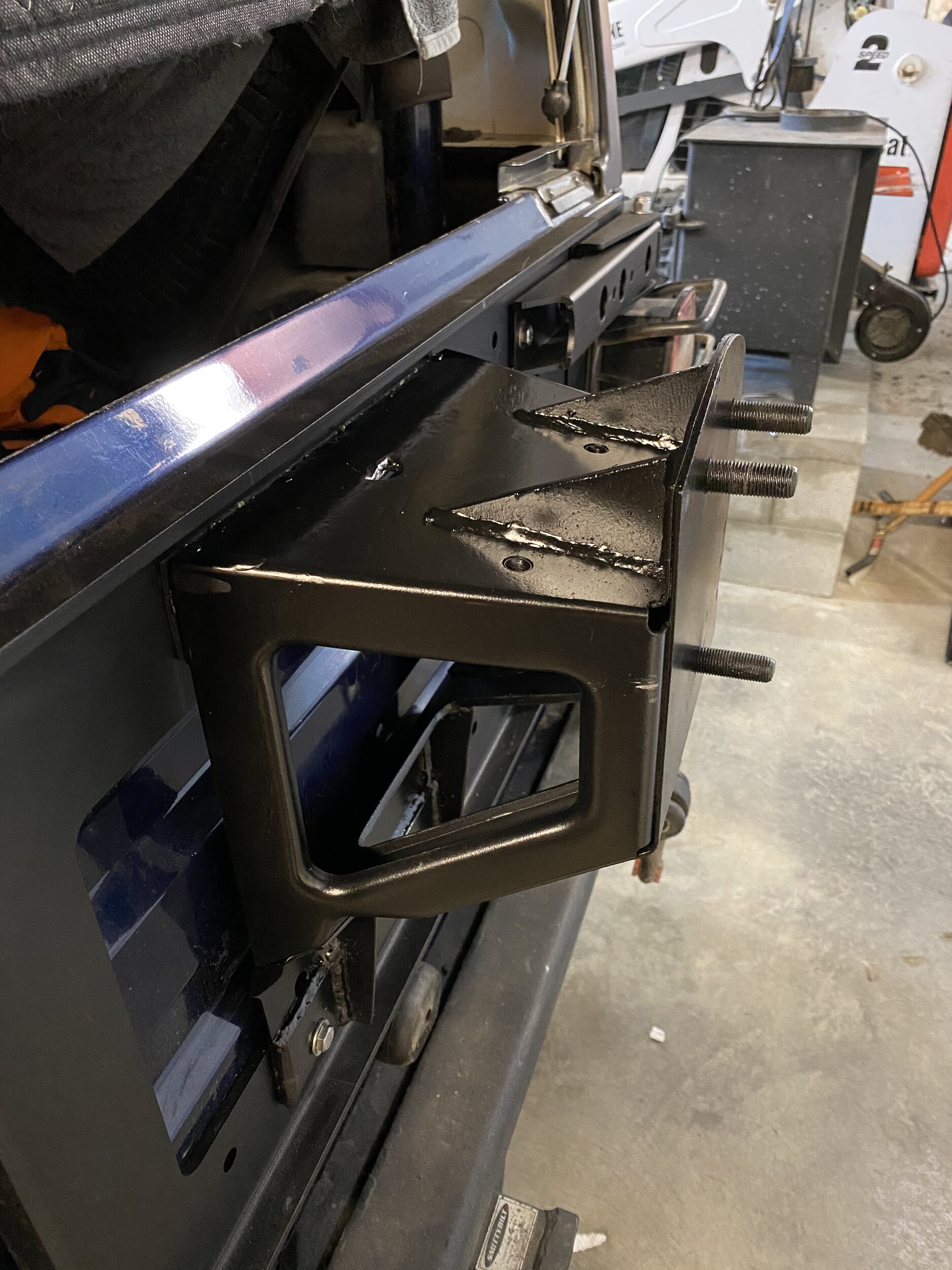

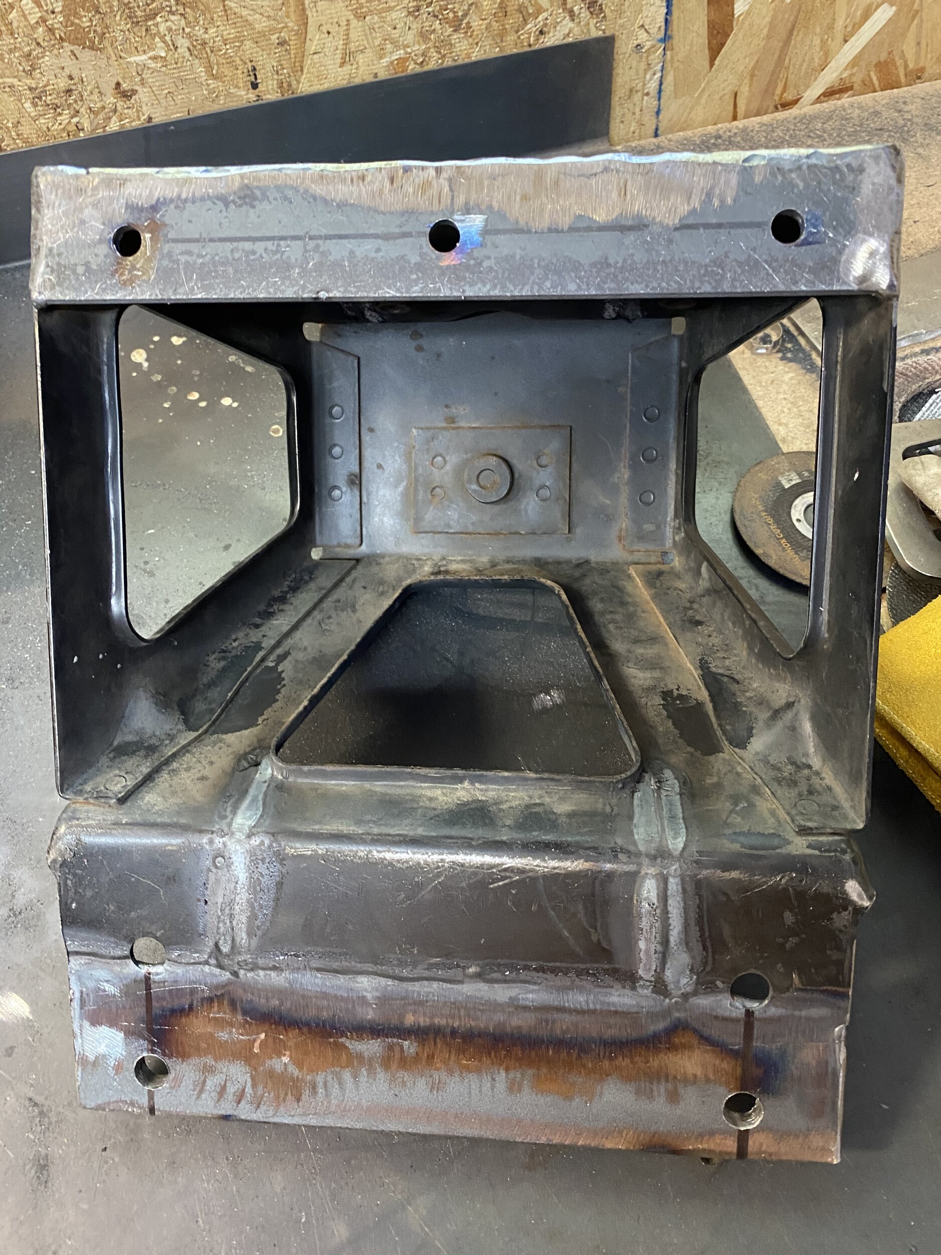

I modified my stock carrier heavily to support the 35 on headlocks so I know the addition of flat at would work. It’s just how much effort you want to put into it.
I do not personally like the spaced out spare brackets or spacers. That just adds leverage to the tailgate and also where the Moryde is nice as it adds a ton of support. Just in case it starts flexing on you with the heavier 33.
I was thinking slotting the holes that mount to the tailgate, much easier to do.
Thank you, looks good. I am tossing around ideas in my head. Looks like you welded the bracket on the inside at the top which makes sense. I am wondering if the bottom has enough bracket has enough to just drill new holes in it. I might have to break out the welder and put my welding skills to the test.
I added 1.5” flat bar to mine then gussets to make sure it was stout.

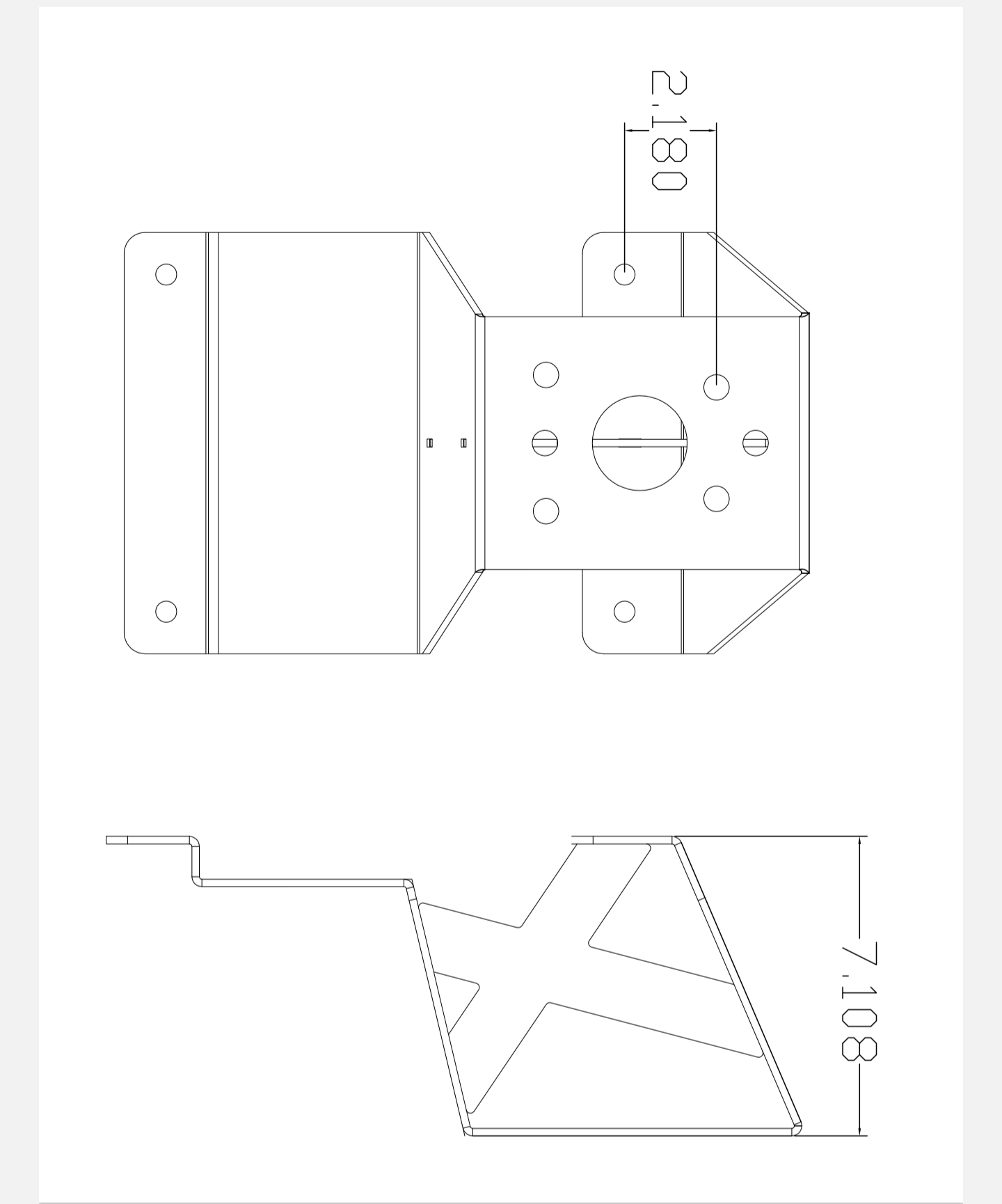

it was 7.1" which is about the same dimensionally as the OEM bracket but it's not available any longer
