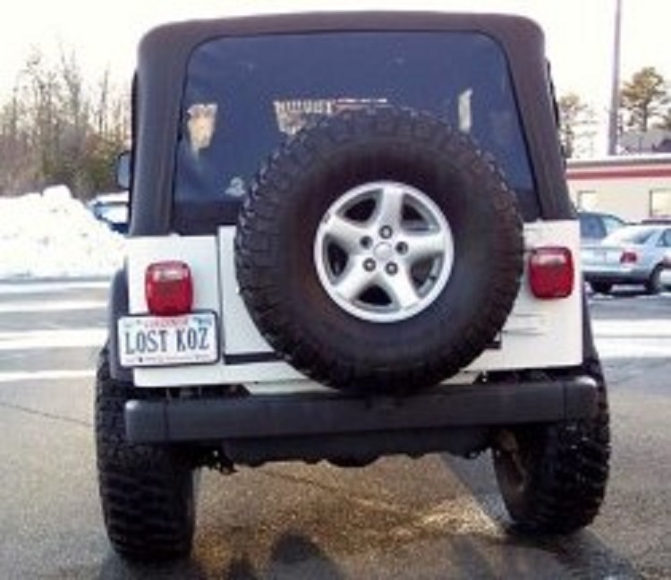

p.s. I had a 3" SL with 33s and it rubbed offroad until I got a BL. Pic without BL.
