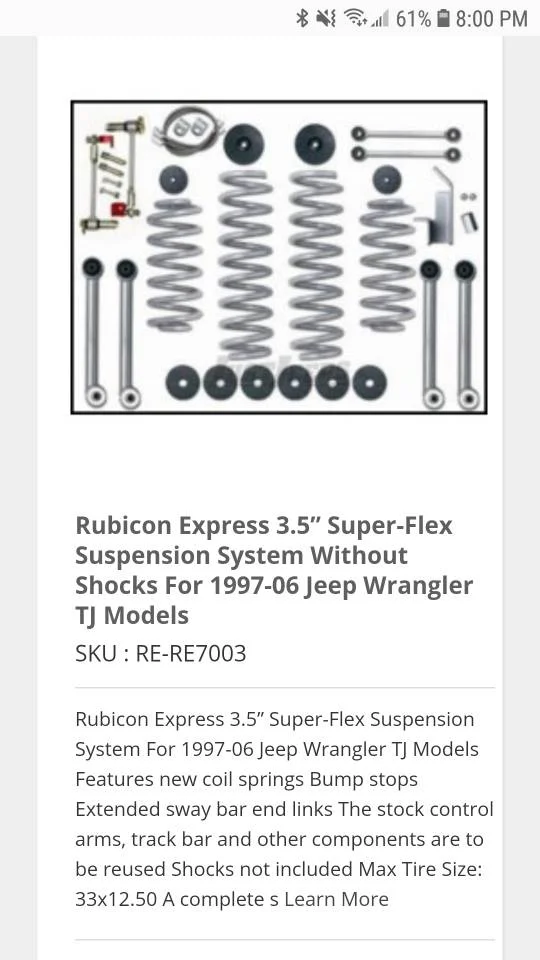

Hey everyone. Brand new to Jeeps. I just bought an 06 Rubicon last week with a Rubicon express 3.5 inch lift in it with bilstein shocks. I just noticed one of the springs is broken.
Would it be possible to swap in a set of 4 inch Pro Comp springs in place of them? Would there be any adverse effects from the extra half inch?
Pics of the kit and and springs for reference.
Sent from my SM-G935W8 using Tapatalk
You will be fine as long as you replace them in pairs on the same axle. I would go with a better spring than the pro comps though. Like Clayton’s or something

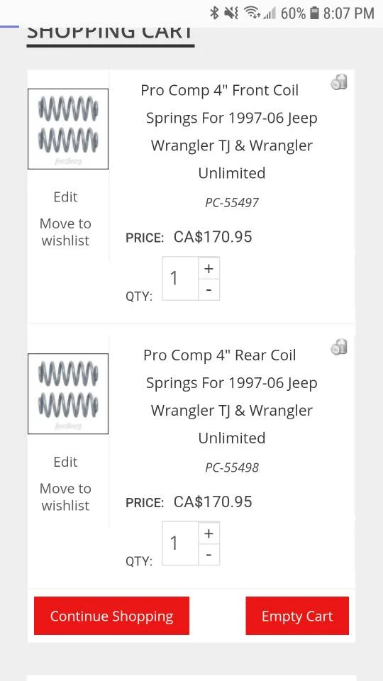

Ok, thanks. I want to do all 4. I don't trust the rest now. I'm working on a bit of a budget right now with it. It needs a few other things mechanically and I just want to get it through a safety cert and on the road for spring.

Yeah the broken one is on the front. Being nose high is what I'm worried about. The kit that's in it now has been in there a good while and I think it's sagging. Plus I usually carry a couple hundred lbs in tools around with me for work.
05 Blue: I wish I could get them at that price. They'd be over 250 a pair by the time it gets up here with exchange, shipping and duty. The screengrab above was local pricing in cdn.
