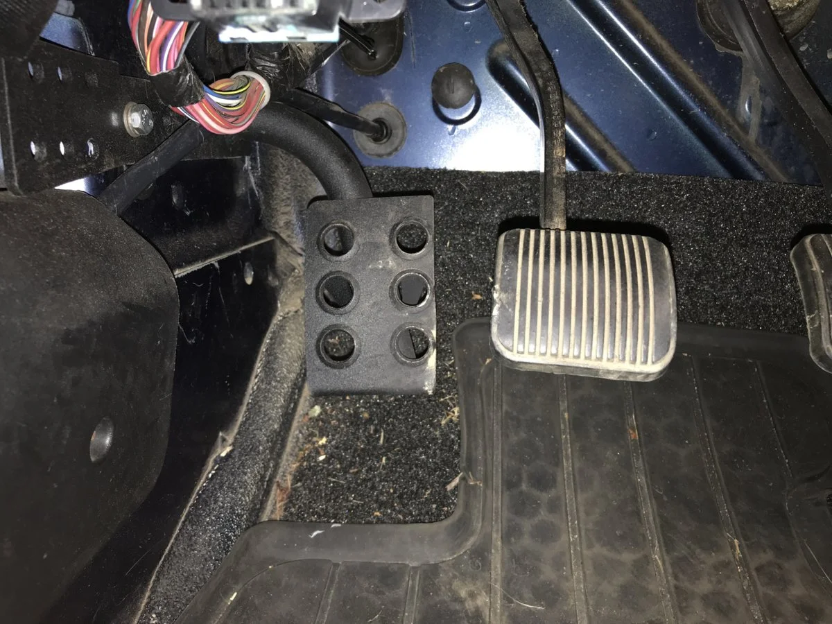

I love the TJ dead pedal (manual), have this in all of my vehicles. The one I added as for a JK, it was $15, shipped, and it fit with minor . Used nutserts in kick panel to attach, very sturdy. I have adjustability, if needed. I narrowed pedal it a bit so I have room between clutch and pedal with boots on. Test fit before installing to get right angle and distance.
