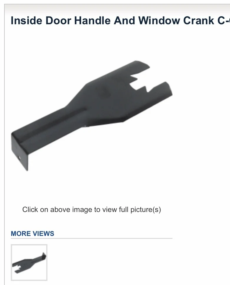

Here is one thing a dead pedal will do ..it gives you a place to extend your leg and rest your foot so your knee isn't on the infernal window crank handle .
This may not be true for everyone , but it's got me using mine .
Yea. Agree. My F-ing knee bangs on that all the time. Can the crank be installed in a different direction or is the splines only for that position?

57DEECA0-FD83-4CDA-ACC0-28215EBEB98A.jpegGet one of the split pin removal tools and pop off the crank, reposition where it works best and pop it right back on.
