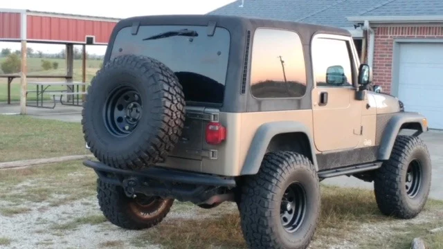

Hey Y'all, quick question on this yer Exogate deally:
Does this contraption allow for adjustable height on mounting the wheel?
Reason I ask: I presently have a HD tire carrier from ExtremeTerrain, which nicely places my spare (35") above my rear tube fender. As I'm planning to install the Exogate before too long, I'm wanting to ensure I can mount the wheel high enough to clear my fender.
Thanks for your thoughts.
*My current set-up, below:
You can’t adjust the height, but with a 35” tire, I can promise you won’t be contacting the bumper.
Excellent, thank you.
