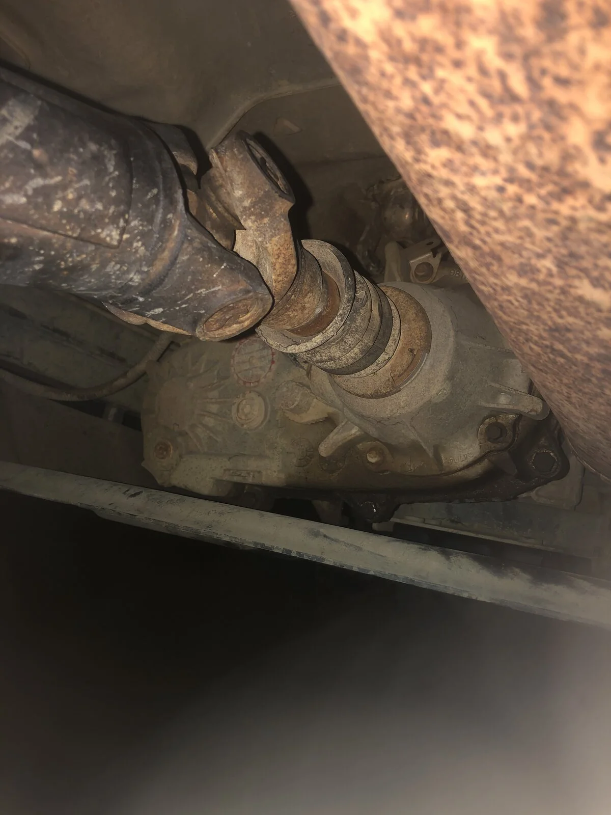

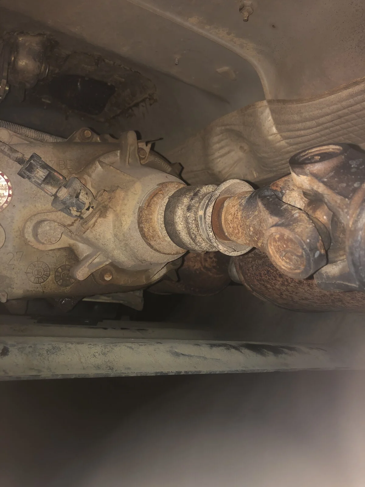

So to fix the DS issue I’d like to get the SYE and DC DS from Tom woods but his Drive shafts are out of stock. Could I buy the SYE and put it on with the current DS and have that help the problem or will I have to wait to get a new DS as well?

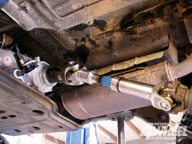

no I don't think it would reach unless I had a drive shaft with a spline like the one in the picture. So an SYE just trades the movement of the yoke for the movement of the driveshaft? I guess I'd have to get the shaft and SYE together so the measurements are right
Also, the fixed yoke is a receiver yoke that allows you to attach your DC DS with straps or u bolts. The slip yoke has closed ears so you can't just attach your DS to it.
