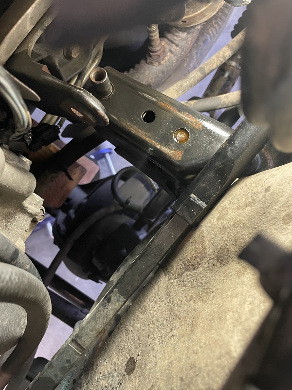

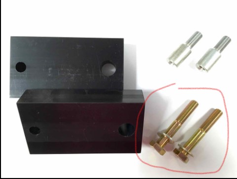

What is the bolt size of the thru bolts for the motor mounts (with a 1" motor mount lift)? One of mine sheered off. Trying to find replacements before extracting the broken piece. I was going to just remove the good side and measure, but it's really frozen so not going to attempt. I probably do not need the extenders, but where can I buy more if needed?

A parts diagram shows the original bolts were M10x1.50x35mm.
Adding for a 1" MML, I think I am looking for a M10x1.5x60mm? class 10.9 Anyone confirm?
Any idea about the bolt extenders....their size or where to source?
