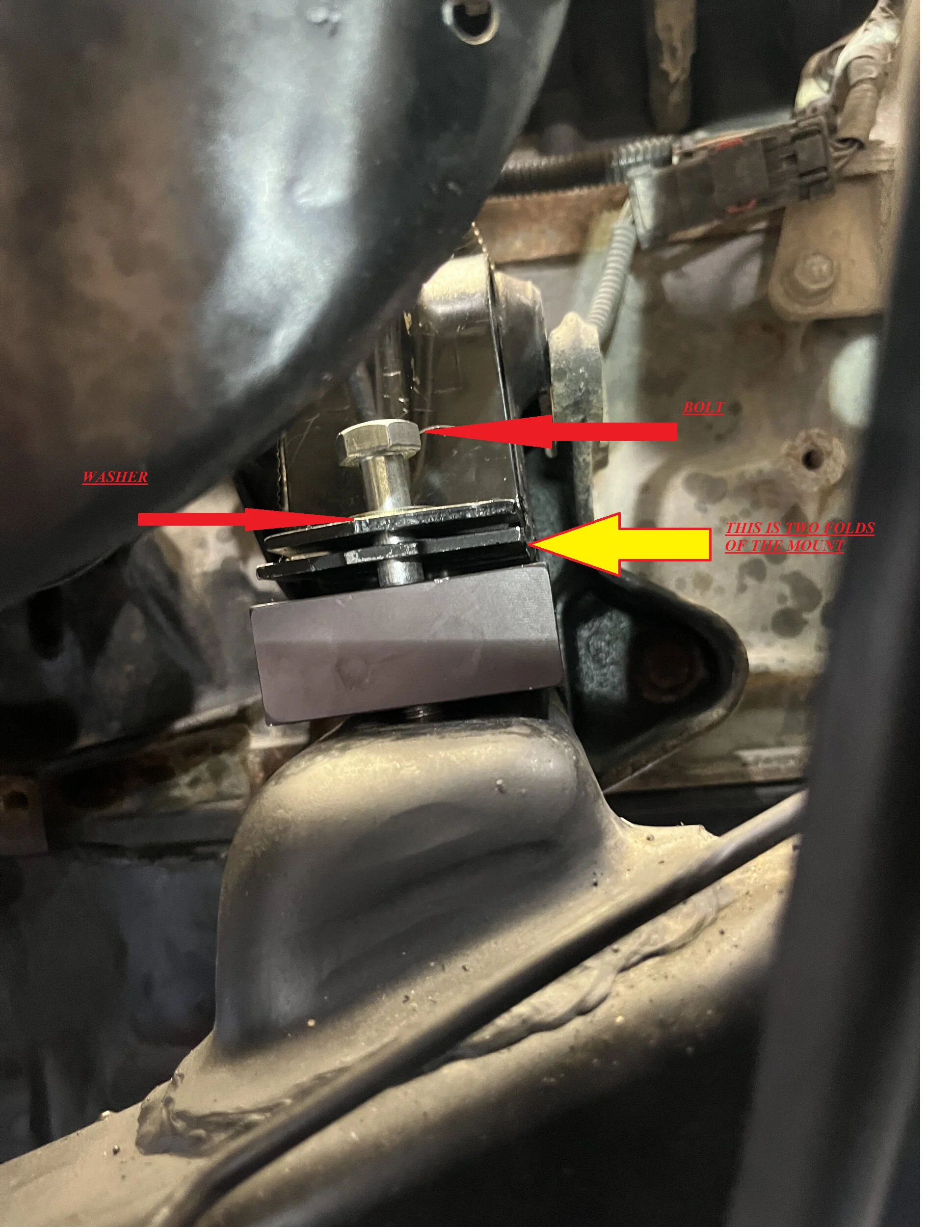

Not sure what you mean. Here is the pic I've added arrows. Unless I did something wrong, This is the Mount, it has a single metal frame that wraps around.
So both of those metal pieces under the bolt head are the Motor Mount.
The bolt and a washer I put through the mounts.
Below that I have a 1" motor mount from Savvy, that isn't a bushing, it's a metal spacer to lift the engine 1 inch.
That's all. Not sure what or where you mean bushing, and if I'm not understanding, my apologies.

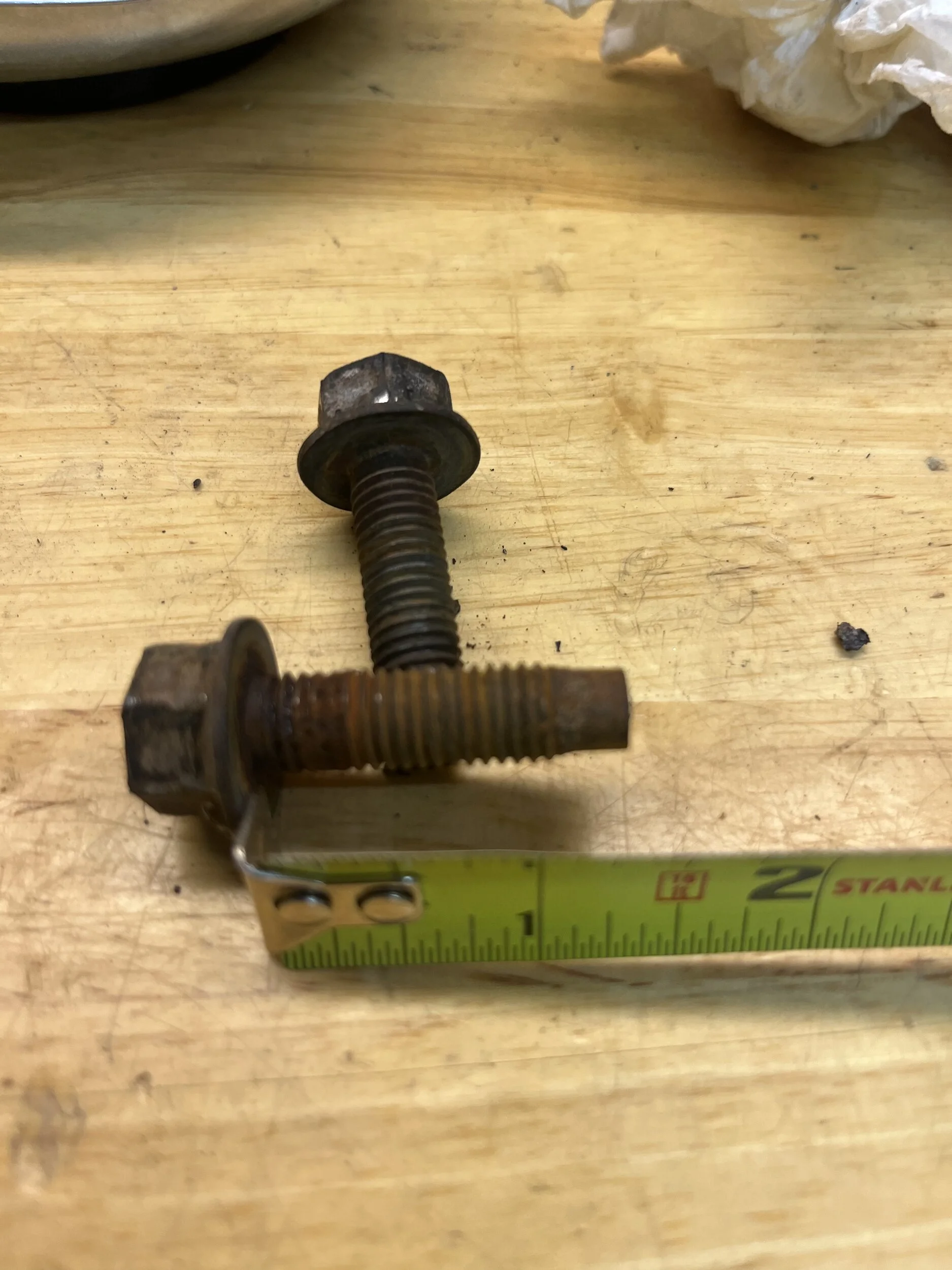

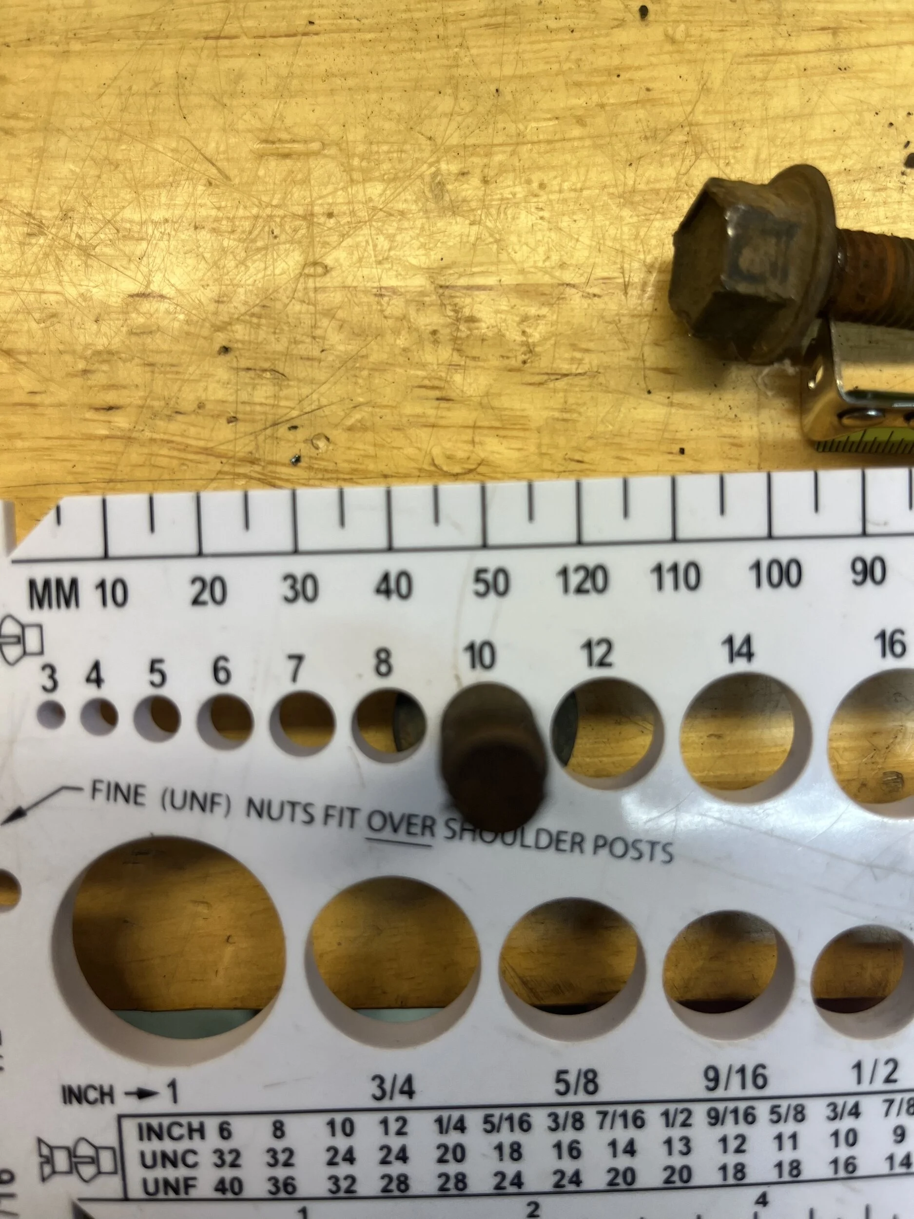

I’m just going off of my bolt measure, and the bolts.
Unless I’ve crossed them up on the bench.
It measures M10-1.5 exaxtly
Won’t go in the 3/8.
So, hmmm. I feel bad, don’t want to send you in wrong direction.
Here are the bolts I pulled.
