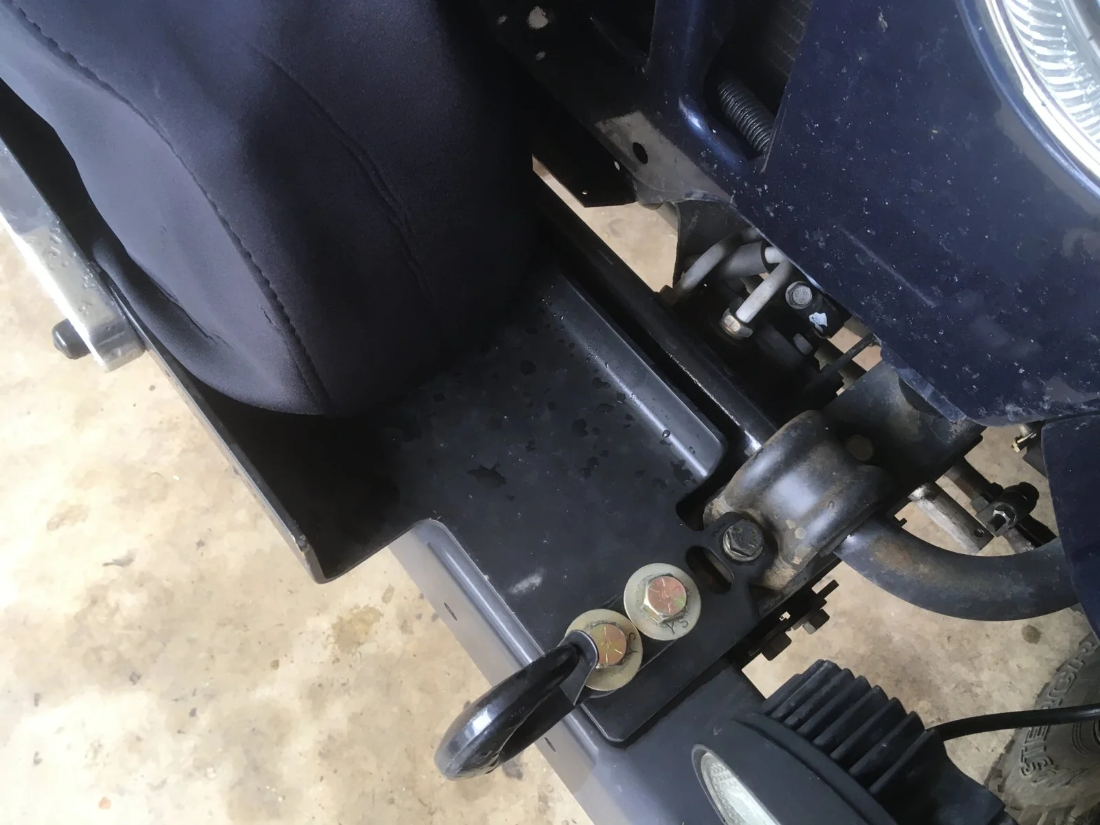

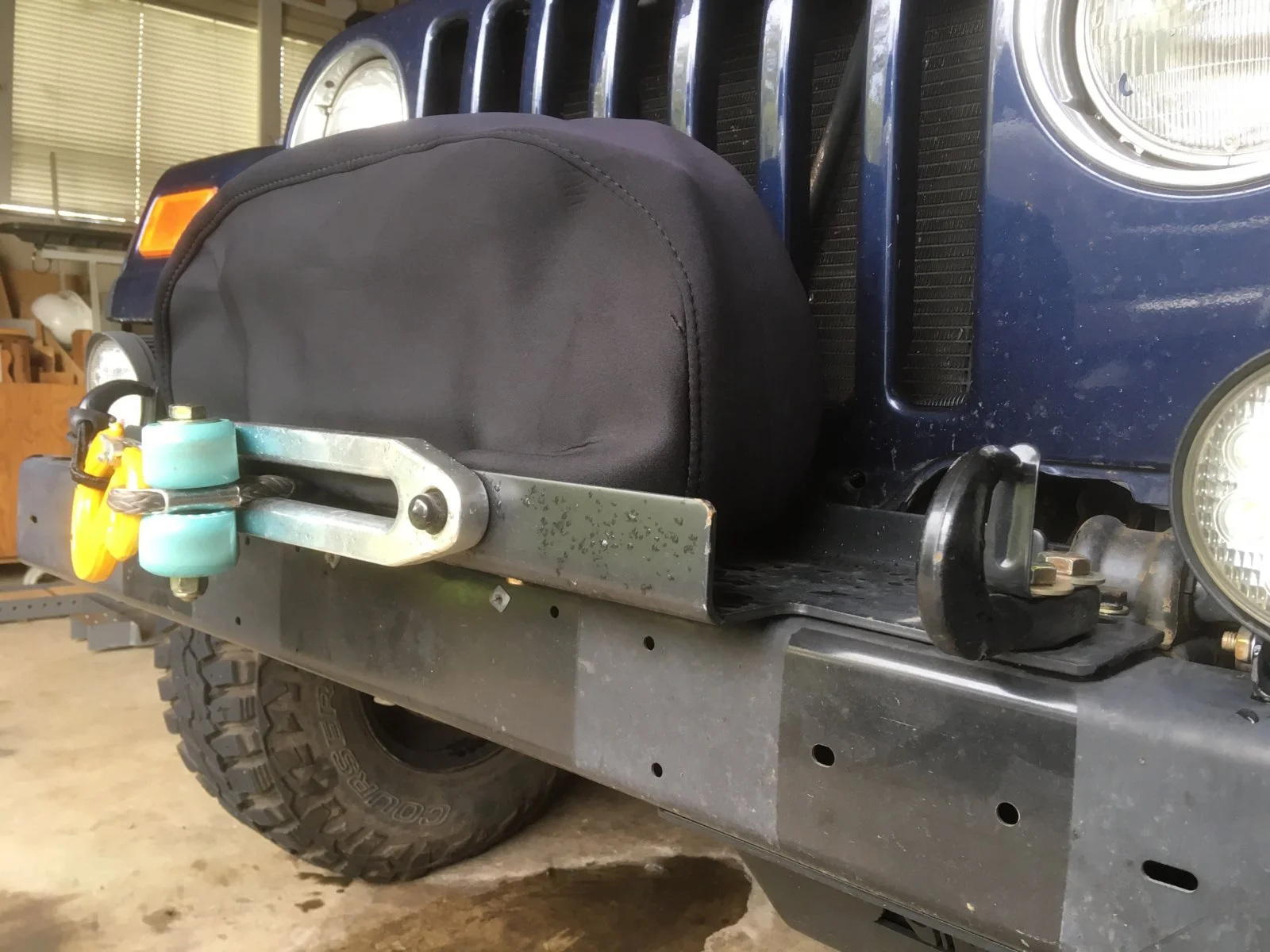

I'm not sure if it will interfere with your RV tow mounts but, I put my winch on to my stock bumper. The winch plate is the important part, it ties into the frame.
Reactions: billiebob
Here are some pics...
Reactions: billiebob and RV-TJ

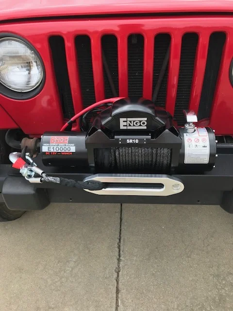

The stock bumper works perfectly fine for mounting a winch. If you go with the stock bumper your options are a flat mount plate (picture below) or a raised plate. It seems both work well it just depends on which you prefer.
