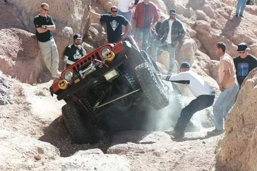

This is one of the many times I smoked my previous TJ's Luk clutch. I probably drove on that clutch another 50k miles after that photo was taken.
